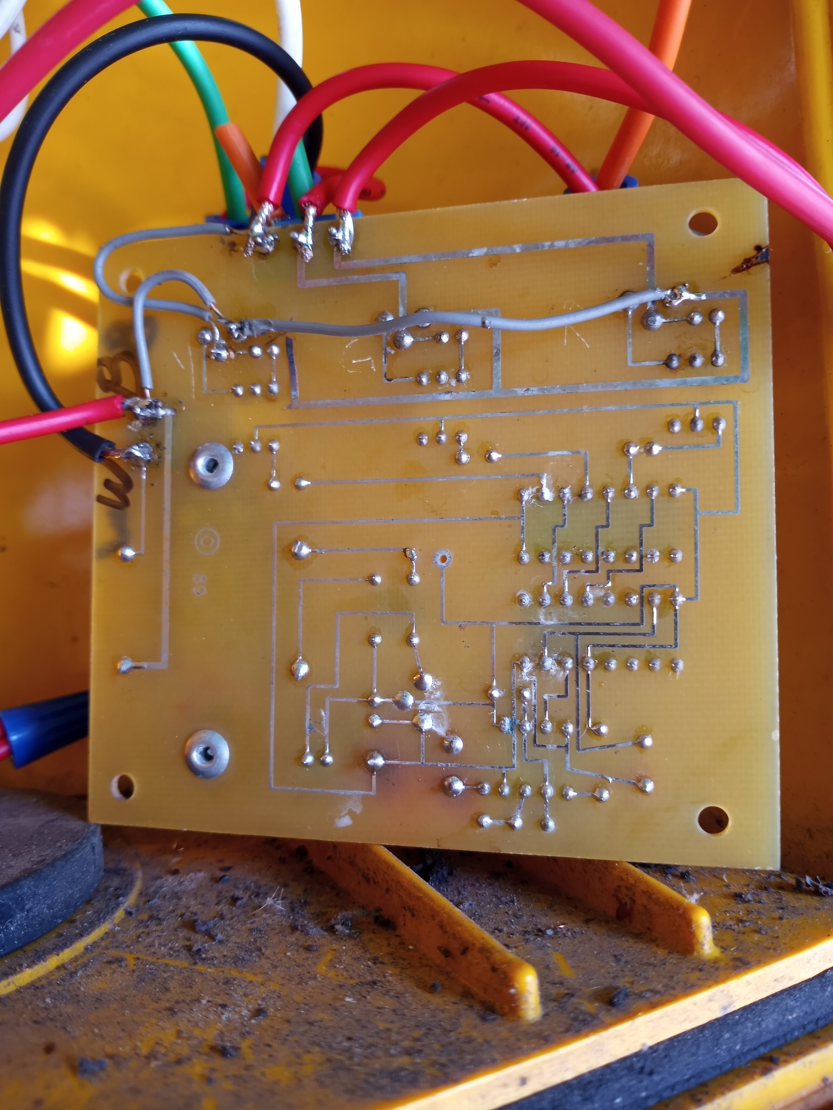

first is the back i put the wire on it to repair the burnt traces the left one is the yellow and that is on all the time if you look at the2nd photo the left and right pins are 120vac all the time and the center one gets 120vac from the white device just below it. based on the f on my is i think it is the last photo a triac. this one is used to power lights and such, but i do not know if the to-220 is a power transistor or a triac. so maybe someone can help me id these 2 devices based on the back side traces.

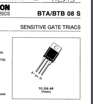

They will be zero voltage switching opto-triacs, similar to the one you linked - and triacs such as BTA08 series for the actual output power control.
It's a common type of circuit.
ok so your saying the white ic is a bta08 type triac? i'm thinking because the light is just staying on that the output to-220 device may still be good based on the fact that on the other 2 devices if the center pin is energized with 120vac those lights do turn on. so i think the actual defective device is thee white device.
so i think what your telling me is i need to find a triac with a zero voltage for the switching? i guess i can get that info from the websites i got those photos from, providing your talking about the white device

have no idea if any are mini controllers at the are i think is defective
the board times the traffic signal to go green yellow and red in a repeat pattern
the timing can be changed with a mini pot
i did post that but is you want to actually see the edges i can get that
i will try to get a diagram but if you look close at the back and the turn it over it is easy to see? but let me see what i can draw up.
this is the best i have at this time only the far left is not there and that is just the board
the back side you see wires that is to repair the burnt traces you can see the burnt ones

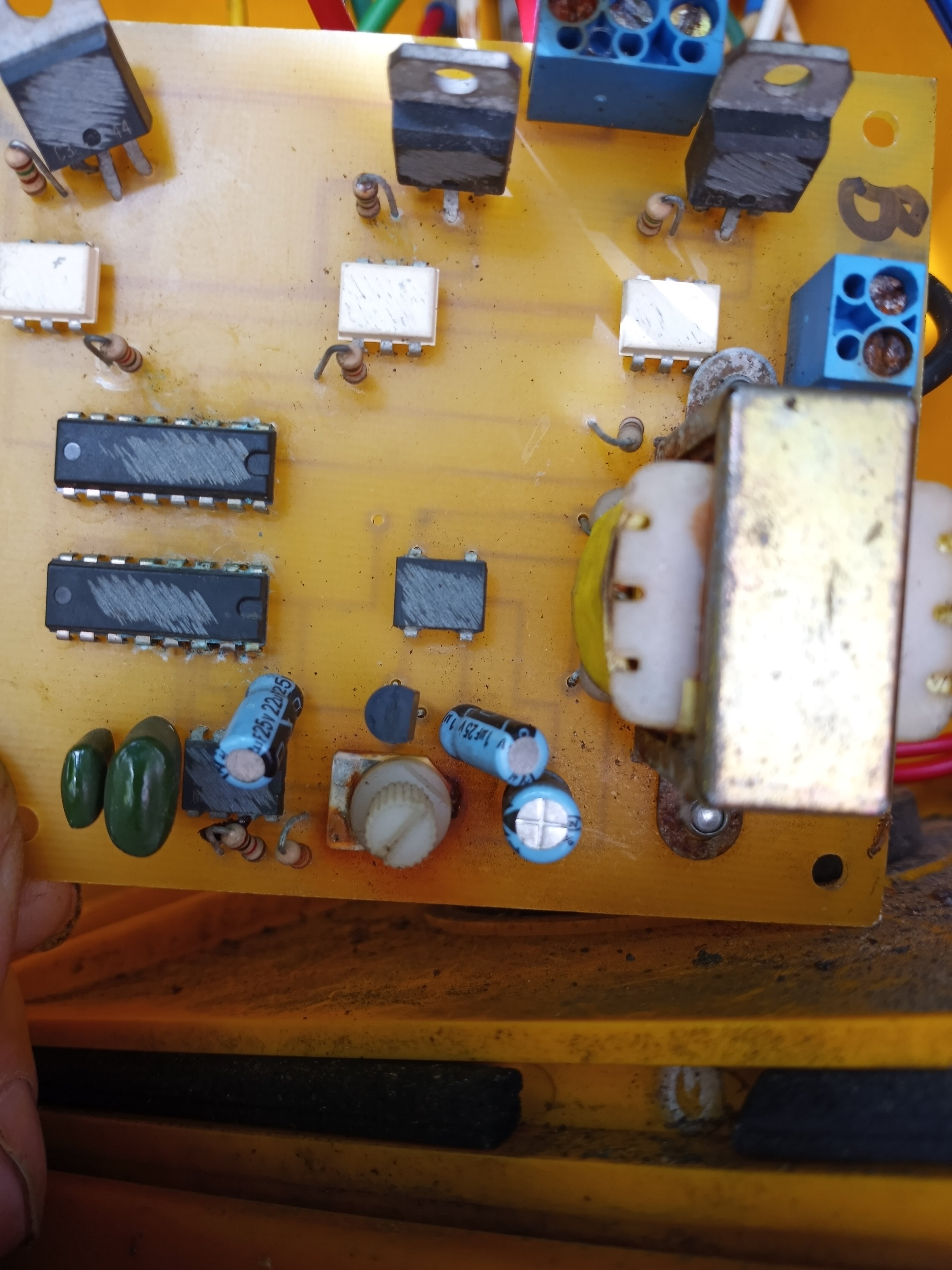

The lower left 8-pin DIP probably is a 555. Can you read anything on the face of the TO-92 part? It is in the right place to be a low power linear regulator.
Is this a commercial unit? Both the design technique and the layout are very poor. OTOH, the transformer is riveted to the board, something you don't see in hobbyist assemblies.
And, that is a very large transformer for such a small circuit. Is board flexing a problem?

Left hand pic in post 6:
Bottom 8 pin ic left of the trim pot is a 555.
Immediately above the trim pot, the 4 pin ic is a 1A bridge rectifier.
The 2 ic's to the left of the bridge rectifier will be standard cmos ic's, possibly shift registers (I need to chase down the schematic to confirm which ones when I can find it - busy today so might be a day or so).
The 3 white ic's are opto-couplers similar to what OP has posted and hopefully zero crossing.
The 3 TO-220 devices are Triacs probably in the range of 6 -10 amp rating 400V or more.

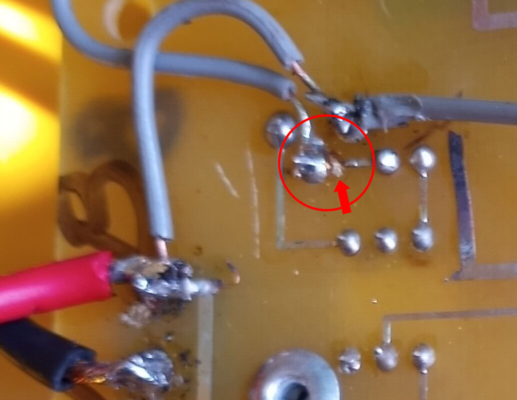

Is this a broken connection?
i do not know? i did notice that but i think if it was a broken trace, that light would not be on as if you look at the same circuit to the right you will notice the trace is connected and in that part of the circuit on the reverse side there is a resistor making that circuit from the white ic device your calling opto-couplers. and i think if that trace was broken the light just would not tune on. that trace goes to a resistor and the resistor drops down to the coupler. i think i have a line on these on ebay but i will do some more research to make sure i get the correct voltages. i wonder if the amp rating on these are that high being they control a 60 watt bulb at the most. that is what this came with when i got it and i asked the traffic control people and they said they put 60w bulbs in then at 130 volts to make them a bit dimmer but to also make them last longer.
also at that point on the board the other 2 lights at that point do not have power when they are off, this one that you have circled at that point i have 120vac and also if i measure back to the next solder point i have the same 120vac and at that point is the resistor.
No, the white six pin devices are the opto triacs which are "triac drivers", just to control the gate on a higher power triac.
The MOC3063 such as in your photo is a opto triac.
The upright TO-220 devices will be the BTA08-400 series (or similar) power triacs.

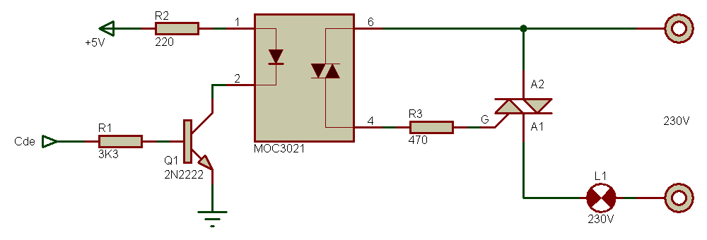

Together they form some variation of a circuit such as this, though driver from an IC rather than a transistor.
The MOC3021 is another of many triac drivers, so that, a limiting resistor and a triac allow isolated 120 / 24V power control from a low voltage control signal.

The 3021 is a "Random phase" type rather than zero crossing - it will likely cause radio / TV interference in your application, as the light can switch at any part of the AC cycle - and your board has no suppression or filtering to handle that.
Use a zero crossing / zero voltage switching one such as the 3063 you show in the original post.
thanks i have on ordered now. this light is out on the front of the garage and not by any radios and tv's so it may cause interference but i'm guessing it will me minimal at best and not bother anything in the house. or should i will get the one of the moc 3052 or a moc 3063 device and see if that works better.
i got the moc3021 based on the numbers you showed in your diagram so do you think i need to forgo the moc3021 in favor of the moc3052 or the moc 3063? i can order one of those and return the one ordered.
