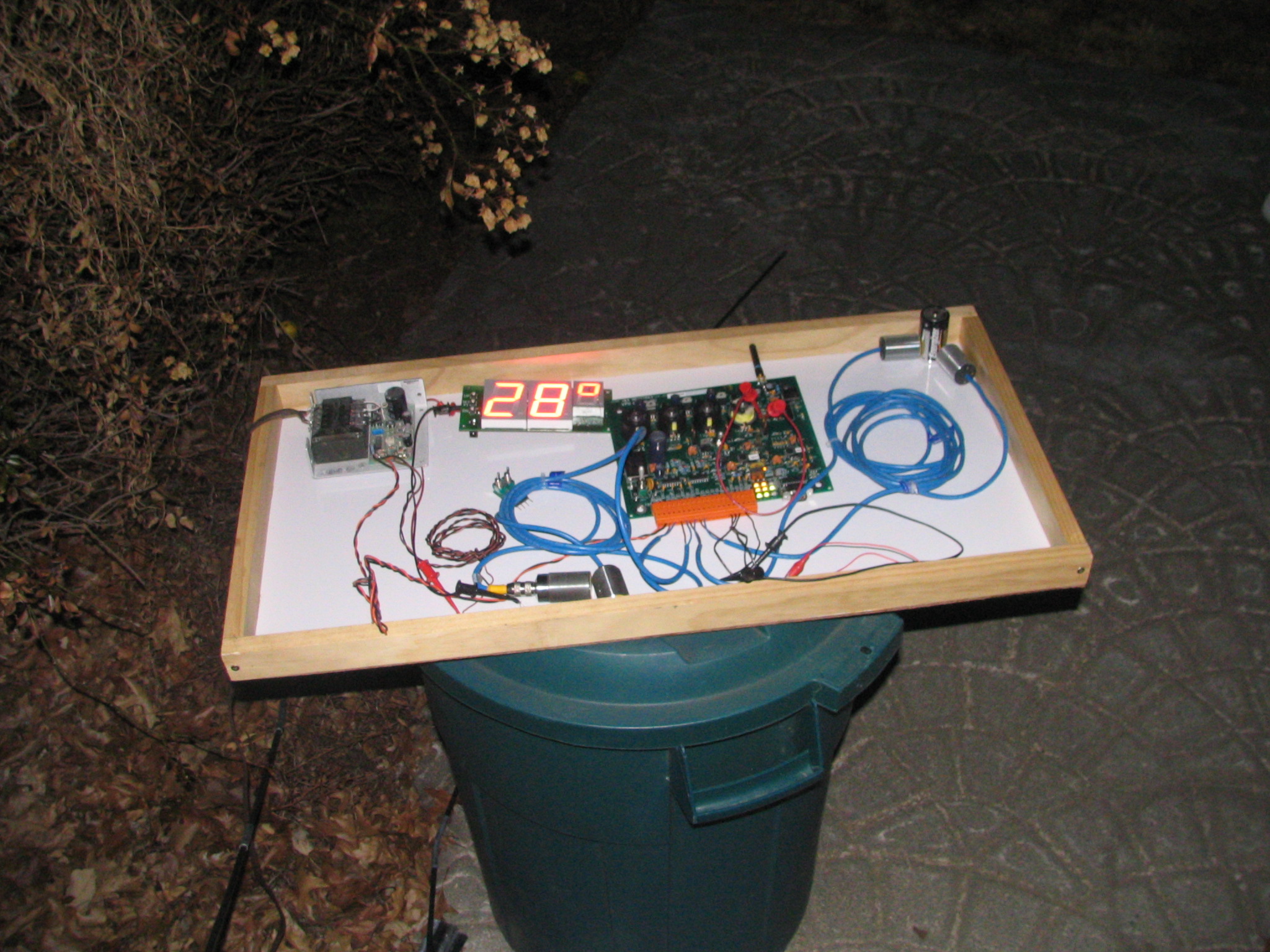

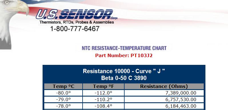

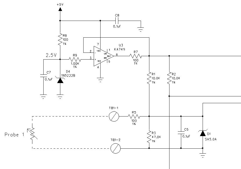

that only tells half (or less) of the picture. It gives you the 25C reading. For instance, there are over 358 thermsisitors at Digikey with a base (25C)reading of 10K. Then you look at the 85C temp (or some other). This gives you the exact thermsistor you are using. This is how they are rated, 85C/25C. For instance, I used the PT103J2 from U.S. Sensor to build a temperature display for Budweiser. It has a 25C resistance of 10K and is made of "Curve J" material. (Beta 0-50 is 3890).

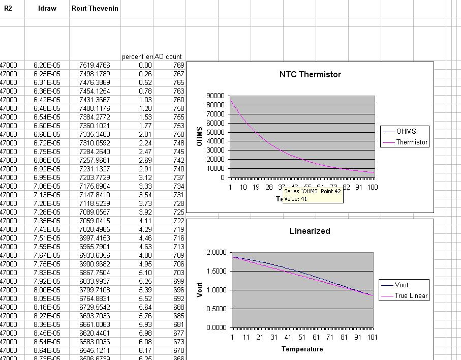

Since thermistors are very non-linear, I added a 47K resistor in parallel to somewhat linearize it. Then I did a spreadsheet to assign temperature values to ADC readings. I also used an AVR which gives me 10 bits. In the circuit, the top line goes to the Aref and one ADC input, the other two are two sensors connected to ADC inputs.
In the photo, I am using it to check ambient temp for testing another board.

well, a few points won't get you the curve... it's not as simple as 85 ohm reading/25c ohm reading, there's a whole tangled formula the use to figure it out. Taking a few readings on the curve can help you pull out which one it is by comparing it on a chart of thermistor curves.

Thanks, the sad part is, the board I'm testing in the photo was sent back off a railroad bridge in Detroit. They said "every time a train approaches the bridge it starts showing errors". I hooked it up and put it outside to test it as I wanted it in ambient environment in case temperature had something to do to cause the error. Besides the output transformer they broke sending it back, it worked 100%.... two days later they called and said nevermind, they found a wiring error. This was on a bridge that was in use for over 3 weeks!!! I'll never ride the Amtrak again!!! I put a lot of effort into self testing and detecting errors, but I didn't know I could detect system errors as well...

certainly.. that's how I bought thermistors for it two years later... data sheet? data sheet? which one did I use???... so I looked up my ADC value chart to see what the 100F value was and the looked at a few curves until I found it...

The problem is, National Semi conductor has the same thing in a chip. See the LM34. I've also used these puppies on at least 4 different boards. Hook one of these into an AD port and your micro knows the ambient temperature. Or you could hook one into a voltage comparator and use this as your alarm output. P.S. my temp display has this alarm feature. In the picture you can see buttons on the left. Set, up, and down. When the temp gets above the setpoint, the display flashes and it closes a relay.
