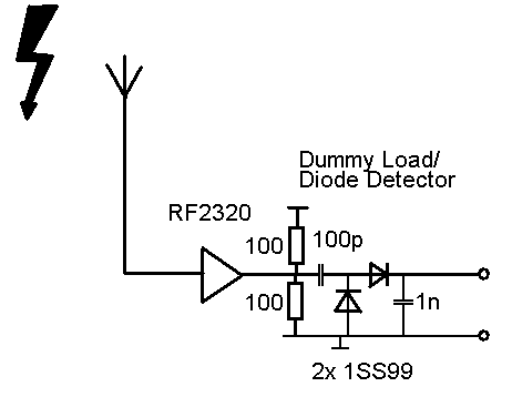

the site you gave me is very good... i found a schematic and
it is called "diode detector" is very simple!!! i like it...do you think i
can make it light a led when detects an electromagnetic field???
P.S i guess it works from a distance with a small antena it's not like
the device in the link i gave above.. right?

Yes, BAT62-03 is your answer.
Do you mean the "diode detector" diagram attached below?
This works a lot like the other link you gave, but with important differences. Both are intended to measure RF power, but this one has a preamp, that RF2320 IC, to take the signals from the antenna and boost them up to make them large enough to work with the diode. So this one will be more sensitive, perhaps too sensitive to cable directly to a transmitter, such as what you were thinking of doing. This one is better suited to use with an antenna as is shown.
This one uses two diodes in a voltage multiplier configuration, whereas the other one does not.
In either case, neither circuit will be able to light an LED from antenna signals as you need a lot of power for that and a diode detector will have trouble giving enough power. It could be made to do that by adding an amplifier after the diode part, based on a transistor or an op-amp.
BAT62-03 would work fine in either of these circuits I think. Other BATxx types might be OK too, but each one is a little bit different and when I look at a data sheet for one of these, I hope to see them say something like "suitable for RF detector at 1 GHz" or maybe "detector and mixer applications to 2 GHz" or something that describes that it is good to those high frequencies. Oh, and it must be a schottky diode.

Radioron you're very helpful! the information you give me are very precious thanks!!! :)
