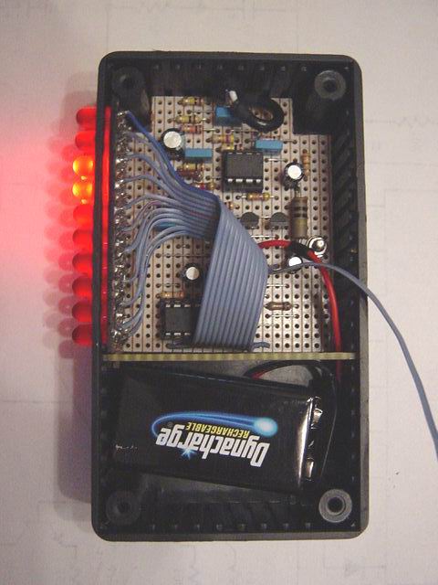

I recently made another Sound Level Indicator project that uses a single LM3915 for a 30dB range plus an automatic gain control for an additional 20dB of range. It operates from a rechargable 9V (7.2V actually) battery or an adapter.
https://www.electronics-lab.com/projects/motor_light/009/index.html
