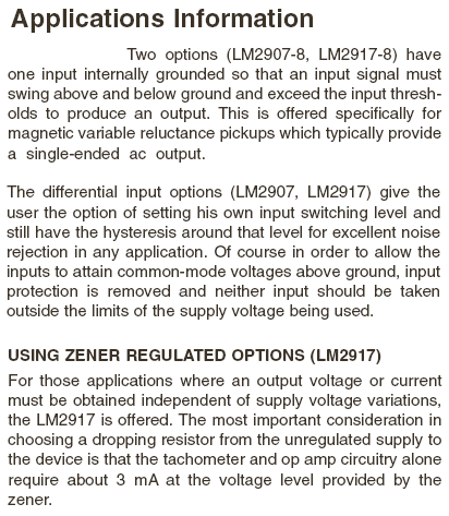

The 8-pins LM2907/LM2917 needs AC (voltage goes above and below ground) for its input. You are feeding it pulsed DC.
The 14-pins versions can have their reference input biased so that the input works with pulsed DC.
