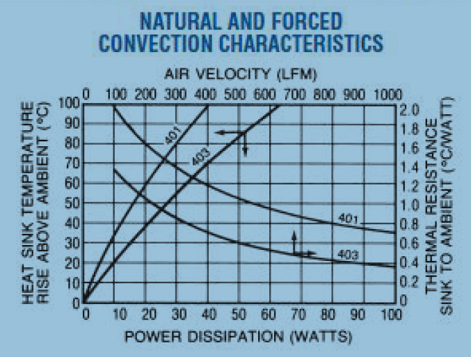

Using a fan cooled heat-sink can significantly reduce the needed size of the sink. Look for those used to cool PC CPUs.
I thought about this a bit, but maybe I'm missing something. How much help do they actually give, is there a way to quantify it? Or some theoretical way to factor them into the maths?
I was planning on using a small one to keep the ambient temperature on the heatsink stable, but I thought it wouldn't reduce the theoretical heatsink needed, only allow the calculations to work out because you're keeping the ambient temperature (Ta) stable(ish) and not allowing heated air to build up? But does it actually reduce the thermal resistance because its forcing ambient further into the sink?
A heatsink heats up. A fan literally blows away some of the heat.
Moving air greatly increase the heat dissipation of a heat sink as compared to normal convection. If you look at the thermal resistance for those heat sinks with fans you will see how much lower they are.
The thermal resistance depends upon the velocity of the moving air so it's somewhat complex to quantify.
Here's a paper that shows the reduction in thermal impedance due to various air flow rates.
Champion, cheers mate.
For some reason I had the idea that a heatsinks rating was spec'd at a value when the direct ambient was kept absolutely constant by some means, be it 'artificial' even, and not at normal convection. Stupid when I think about it now.
Here is a heat sink. At 1000 feet/minute of air flow has 0.4C/watt resistance.
At 100 feet/minute the resistance is 1.3C/watt.

The hardest thing to know is BTU rate the transistors heats up and how much cooling you get from a fan.
Here is what you do. Weigh the transistor on a gram scale. Get a piece of metal like aluminum 20 times heaver attach it to the transistor and turn it on. Time the rate at which the metal heats up. Keep notes and plot a graph for every 30 second up to about 150 degrees. Now you have data to work with you can calculate how much larger or smaller the aluminum needs to be to keep the temperature from going over 150 degrees.
It is very interesting aluminum and copper both have a high heat transfer rate but very low heat radiation rate. Cast iron has the highest heat radiation rate but very poor heat transfer rate.
A small fan will increase efficiency several times. Do an experiment with a fan to find out how fast a fan will cool a certain mass size piece of metal then do the math to find what size metal or fan you really need.
