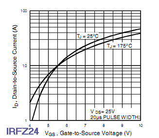

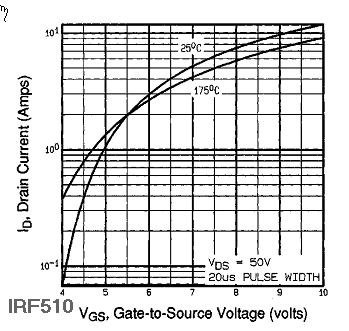

Thats the problem , they have very different Vgs turn ON curves.

I have the data for both types of FET.
For example:
if the IRFZ24 has a gate voltage of say 4.5V the drain current is about 2amps.
The IRF510 with a gate voltage of 4.5V has a current of 0.5amp.

Did you look at the two Vgs graphs I posted, the two FET's have different conduction specs.
Both in threshold and VgIds slope
