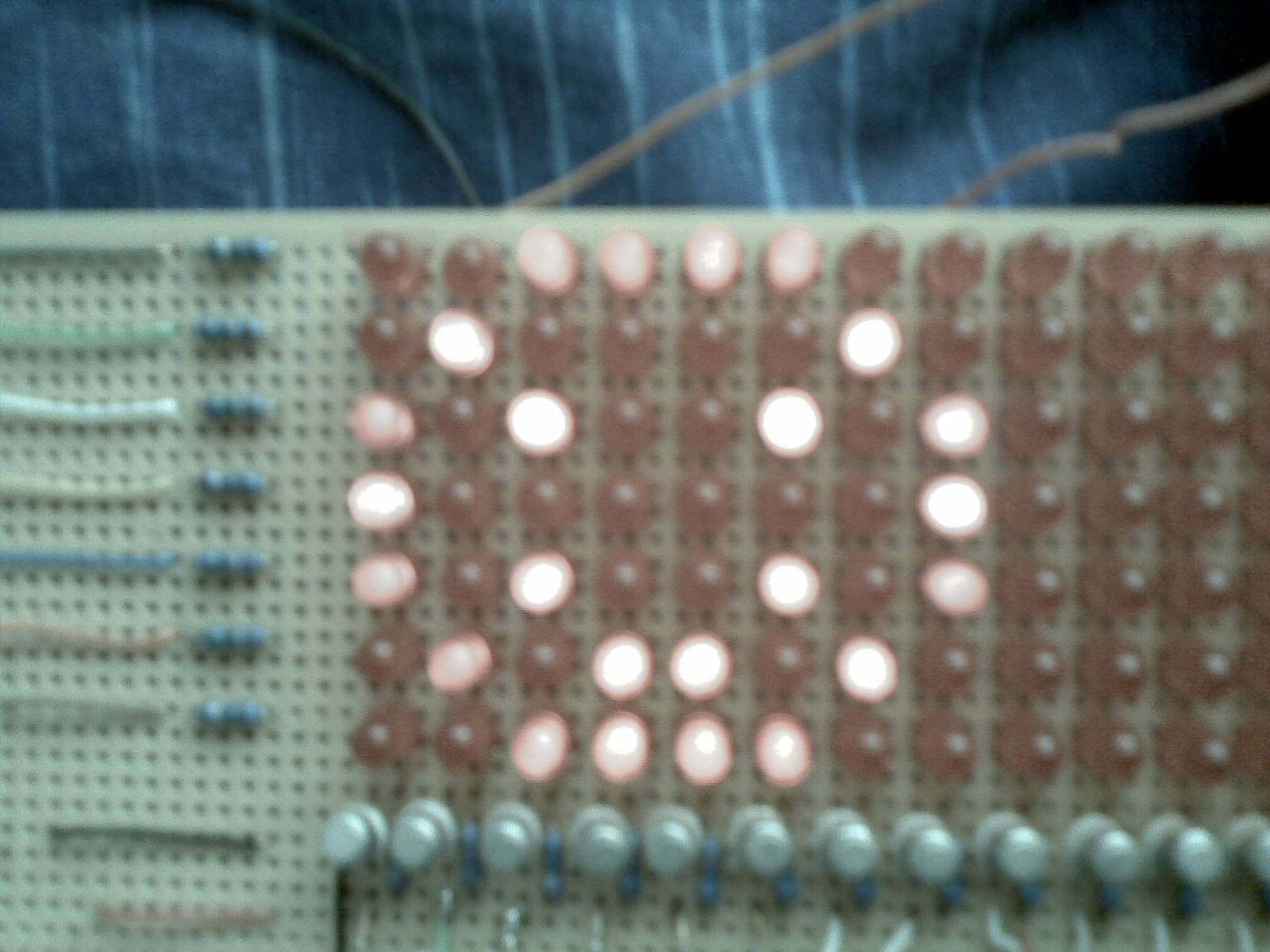

Hi
This is what I managed to do so far. The idea is to eventually make a 7 x 30 message display but I'm really happy to have gotten this far.
Sorry about the pic quality

Thats pretty good for starters..
When you have the 7 * 30 working, post an image.

I'm not totally a beginner though. I studied a little bit of electronics a long time ago so the assembly language and electronics isn't all new to me. Hope to have the 7 * 30 up and running soon but still have to get familiar with EEPROM, I2C etc
