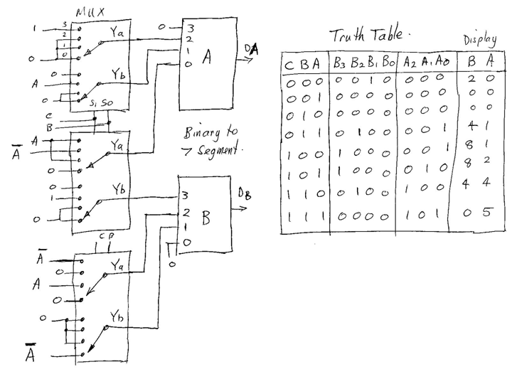

Well I could not help myself, I did analyse the circuit and drew the attached block diagram and truth table.
Please check these for errors.
I cannot see what it is doing.
I assume the equation is a quadratic. ie. Y = X^2 + X -2
Is this correct?

Just seen your block diagram. That seems to be correct. Please bear with me as I've not really done any digital circuits before.

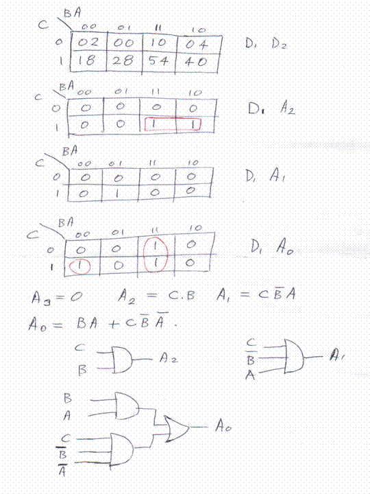

I now understand what you a doing, but my truth table does not agree with your equation.
You need: -2, 0, 4, 10, 18, 28, 40 & 54.
But my table shows: 2, 0, 0, 14, 18, 28, 44 & 50.
So is my table wrong or have you made an error or 2?
Sorry, think I've had a few too many beers tonight :lol:
As you state, I need -2, 0, 4, 10 etc.

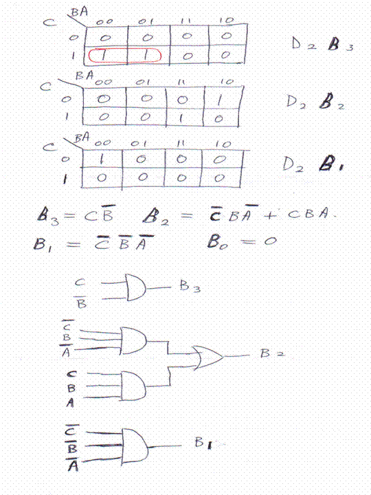

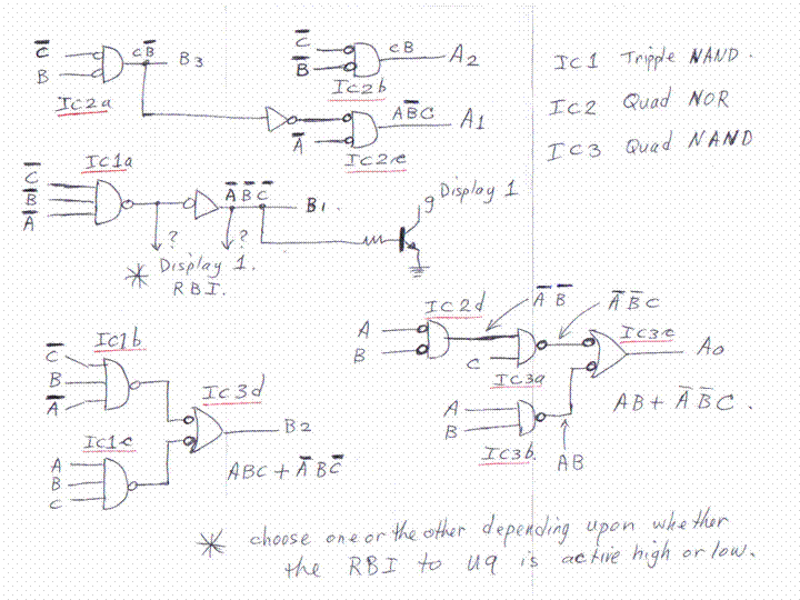

Here is an alternative using NAND & NOR gates.
You don't need a third display for the - sign, it can be done as in the attachment,
ie. when the input is 0, blank display 1 and turn on segment g with a transistor.
I don't have a data sheet for the 74LS47, so I don't know whether the RBI input is active high or active low.
So I've indicated both possibilities on the "final.gif" attachment.
I suggest you check my logic as I may have missed something.
There is a minor error in "final.gif". * Display 1 RBI should be * U9 RBI.

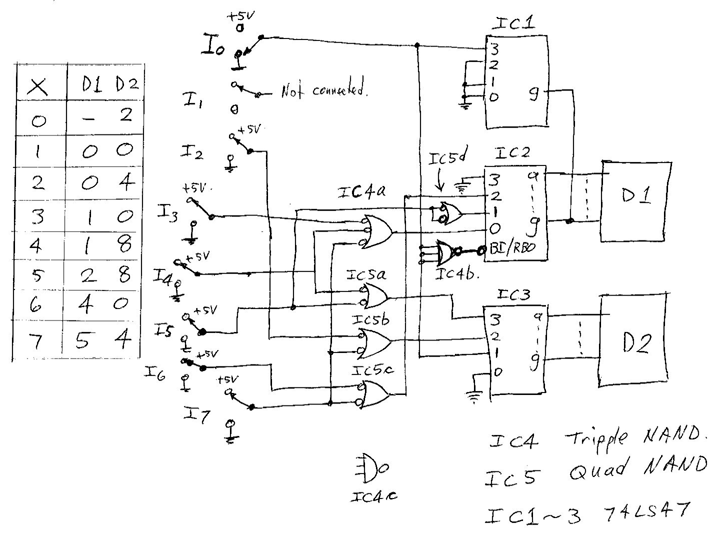

I have thought of an even simpler solution. You don't need U1.
I'll draw it up and post it in few minutes.
As for the transistor, then you will have to use another 74LS47 and only use one input and one output. If you use the A3 input, it will output 0 if A3 is low or 8 when it is high. So if you connect the g output to g of Disp 1, and blank display 1 when the input is 0 (ie. I0 = 1) then Disp 1 will show a - sign at 0.
Here is the alternative to my previous.
The only disadvantage is that switch I1 is not connected, so the display will show 00 if all switches are off and regardless of the setting of I1.
Edit: This disadvantage is common to your original circuit and both of mine. However, it can be solved as in the next post.
I can't see any easy way to correct this, it would require extra gating.
But does it matter anyway?
Note that switch I0 is wired opposite to the others, this could be corrected (if necessary) by inserting the unsued gate (IC4c) as an inverter.

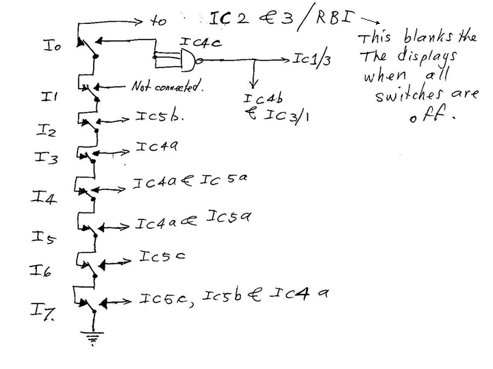

This is a method to blank the displays when all switches are off.
It needs to be combined with my previous circuit.
Note that the 74LS48 has internal pull up resistors so you don't need to include internal ones. I have not shown pull up resistors in my drawings.
