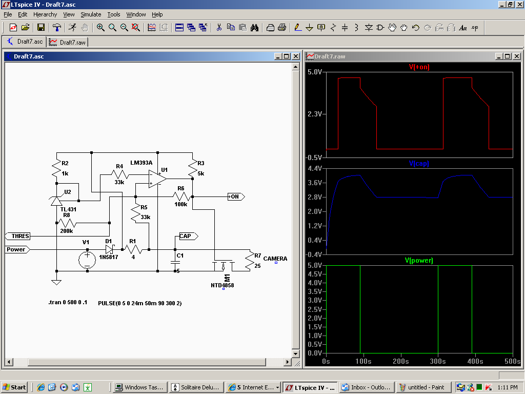

I think I got it. Seems like there may be two ways to go:
Continue to use the batteries and charge them when power is on.
When power is turned on, turn the on off switch on and switch to motion detect mode.
When power is turned off switch back to normal mode and allow some time to close the frame (this will probably happen quicker than the battery low method)
After the frame is closed turn the camera off.
This requires that you break into the switches.
The other way is the direction you are going.
Delay turning on the camera untill tha cap is charged high enough (battery voltage)
Allow the battery low to close the frame when power is removed.
Need to determine at what voltage the frame is saved and then turn the camera off.
I think this can be done fairly easily by detecting the voltage across the big cap.
You didn't say the voltage from the power supply other than > 3.4 volts. This would determine how long it would take to charge the cap.
I'll try to put something together for the second option since it is least invasive.
Camera switch
Here is one that might work.
When the 5 volt power supply comes on it takes about 30 seconds to charge the cap up to 3.8 volts. You can make this faster if you make the 4 ohm resistor smaller and the power supply can provide more than 1 amp. At 3.8 volts the power gets supplied to the camera. Maximum voltage about 4.5 volts to the camera. When the switch is turned off it takes about 30 seconds for the cap to discharge to 3.4 volts. This all assumes the camera draws about 200 ma. This leaves about 20 seconds for the camera to save the image before it gets shut off.

@ Diagram
I mentioned in my original post that I'm a beginner, this is actually just my 3rd circuit!
If I had all of the components you used, I could build the circuit. However I am missing some of the identification of the components you used.
If you can help me identify them I can acquire them and it will let me do the needed research to be on the same page with you in this project.
I installed LTspice and started playing with it a little, but I haven't found all of the components you used.
Sorry for the novice questions:
-U1 LM393A = Low power dual voltage comparator
This component appears to be the heart of this circuit, thus doing the switching based on voltage.
I'll have to do some research to fully understand how this works.
-D1 1N5817 (SCHOTTKY BARRIER RECTIFIER )
Can you briefly explain how this is being used in the circuit?
-M1 NTD4858 (Power Mosfet - Single N-Channel, DPAK)
I ordered some transistors to start building with.
Is this being used to do the switching to the camera when signaled from U1?
-U2 TL431 (it looks like a zener diode?) I'm guessing it's more likely to be a "Programmable Shunt Regulator"
If you know of a good reference article that will help me get up to speed on this project I will gladly research it.
Thanks again for your help!
Flow Chart
Ok, I've got some of my answers to how your circuit works ronv.
I'm still working on the full understanding, so I can't say for certain if the circuit will have the desired behavior.
Picky camera behavior​
There is one other problem with the camera that occurs AFTER it has safely shut down.
The capacitor must drop somewhere < 0.8V in order to restart normally on the next power up cycle. (This takes > 10 min with a fully charged Cap!)
To avoid this the Camera must cycle "OFF" at some point. ( to reset)
I believe you have this functionality built in with "M1" MOSFET.
The following flow chart may let you know of any other adjustments that might be needed before I figure out all of the details of your drawing:

Your right the TL431 is a voltage reference. It sets the voltage at the - terminal of the 339 at 2.5 volts. This is the voltage the 339 will compare the + pin to.
The - side of the 339 "looks at" the capacitor voltage. When it is above3.8 volts it turns the camera on thru the FET in the ground path. The fet has very little voltage drop so the camera shouldn't know it's there. When you shut the power off the voltage across the cap begins to fall and when it gets 3.1 volts the camera saves the frame. A little while later when the voltage gets to about 2.8 volts the fet will turn off taking all the voltage off the camera for a clean turn off. If power is restored the circuit will wait for the caps to be charged back up to 3.8 volts before it turns on again. This should solve your "zombie" problem. The diode is there just to keep the cap from discharging backwards trhu the power supply and to drop .5 volts from the 5 volt supply so the camera doesn't see to much voltage. The 4 ohm is just to limit the current to charge the cap. R3 is a "pull up" resistor because the 339 has no way to provide the positive voltage needed to turn on the fet. R5, R6, and R8 form a voltage divider to get the capacitor voltage down to the reference voltage and to set the high and low turn on and off voltage. I will look at your circuit some more to see if I can understand it.
The hole that we may have with the comparator is between the battery low voltage and the 2.8 volts where the circuit shuts the camera off. If I understand you correctly if the power comes back on in that hole it may hang.
Seems like the timer will work - Just need to trigger it with the power supply turning on and make the time long enough for the caps to charge. The thing that may be difficult here is that the power supply voltage will also take quite a while to fall so there may still be a hole after it saves. The voltage after where it saves the frame and where it hangs if re-powered is the key to success in both cases. The problem we have is we don't know exactly when the camera has saved.

A video = 1Kwords²
This might help explain the picky camera behavior.
Power cycle Panacea
It appears that a power cycle will solve this problem.
True, if the voltage is stagnate @ ~3-3.4 volts this can cause a problem, but as long as the voltage increases normally, it will make it safe to 3.5-3.6 volts to the satisfaction of the camera
Both the timer circuit and the comparator versions should overcome this issue by their nature.
When the capacitors allow the cam to shut down, the voltage is taken below 3volts almost immediately after the file is saved.
(not that it matters though, because I let the cam sit overnight and the ~10 milivolts remaining did not allow the camera to power up normally without first being power cycled)
It seems that if the 1st step in the cycle disconnects the cam (power cycling it) it will be able to function once the voltage/time has been satisfied.
I believe a power cycle at the beginning will clear this.
I put together a 555 monostable "one shot" circuit (designed for a relay) the timer worked but I think I need a transistor to switch the cam like you did because the cam didn't work (even with the proper voltage)
I think the power cycle will solve this in both cases.
~3.16volts
It saves Very fast once the voltage criteria are met (prob < .25 sec)

Hi Josh,
The 1N4001 should work there is just a little more voltage drop across it that the 1N5817 so if you are still using 4.5 volts as the power supply you would only see about 3.8 at the camera. Maybe not enough?
Good to know that the reset fixes it.
The problem with the timer firing on power up is that the power supply voltage has to get very low for it to trigger again.
The "good news"​
Ok, I gave the circuit another test with the diode on the negative and this time it worked ??
I'm not sure what I was doing wrong before but with the diode in place the cam voltage did take a .7v hit but on the Cap discharge cycle, however this payed dividends by protecting leakage to the Power Supply resulting in 2X longer sustainable voltage ! (>3.1v)
So I started playing around a bit with simulated early voltage removal to the circuit and found that I can get away with powering on the cam as soon as 3.5V and still have sufficient safe shutdown power!
I'm not sure what you mean by that Ron?
Do you mean residual voltage from the power supply?
I though I took care of any residual voltage when I placed the diode in the circuit?
Residual voltage testing on the power supply
I did some testing on the residual voltage:
-With the capacitor leakage contained with the diode, the voltage reached "0" in <10 seconds.
(the majority of the time it was < 1volt, so I would expect the timer to loose power <10 sec)
- Is this the "Hole" your speaking of?
OR . . .
You did get me to re-examine my circiut, it seems that I placed the depletion mode transistor in the wrong place!
-The way it was before it would not charge the capacitor.
- I also added a transistor to handle the camera switching:
The "Bad News"​
residual voltage: an issue with capacitor input?
Now that you have me thinking about residual voltage from the supply I do see one problem with the circuit:
Will J1 be able to switch back fast enough to allow the camera to use the capacitor after power is "off" but before the supply quits leaking?
- will R1 help this 'problem'?
- might this be an issue with the comparator circuit as well?
