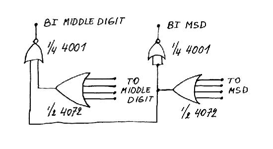

I know there's a problem with that LED and I know it won't light up...and that's why I need ur help.The fact is that we need a LED that can check the integrity of the display,so it should light up if one of the displays isn't working...I have no idea...Maybe we should but some sort of tact generator again...And also we should blank the unnecessary zeros.

Hi Bogdy11,
The level on the BI of the MC14543's should be a logical "0" to
drive the display, a logical "1" will blank the display.
If you want to suppress leading zero's you have to detect if the
four inputs of the MSD are zero and apply the result to the BI of
the MSD. A four input NOR gate will do the trick.( Or a four input
OR gate plus an inverter.)
The same goes for the digit in the middle but you have to take
the result of the MSD in to the account as well.
The LSD does not require blanking, therefore the BI should be
connected to a logical "0".
on1aag.
