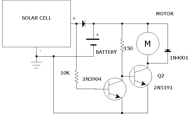

Help, I am attempting to build a solar powered working lighthouse using solar powered landscape lights for solar panels and lights. I plan to usa a 1.5 vdc geared electric motor to drive the can for the light. I have tried and tried to use the circuit board from one of the landscape lights to operate as a light detection switch for the motor circuit to no avail. My motor circuit consist of 1.5 v solar panel to a blocking diode to a 1.5vdc rechargeable battery to the motor. I would like some help or a schematic on a simple light detection switch to insert in between the battery and motor so I can get motor to run at night and battery recharge in daytime. Sorry to be so long winded. Any help out there? Thanks :?:

This circuit just might work. When is light out the 2N3904 turns on and shorts the base of Q2 to the emitter. When it is dark the 2N3904 turns off and Q2 turns on the motor. Q2 and the value of the resistors will depend upon the current drawn by the motor.
Updated version of schematic with values added and 1N4001 across motor terminals.

You can tell that I am pretty much of a novice at this electronic stuff but. Since I have a few solar powered garden lights around could I use one of them as a switch by substituting a 1.2 vdc relay (if there is such a critter)for the LED in the light to turn on my motot circuit? Thanks
Circuit values
To K7elp60: Your circuit above looks like something I might be able to build. What is Q2 and it's value and the value of the resistors if motor is a 1.5 to 3 vdc, current is .18A to.25A with .70A +/- 15% at max load. Told you that I am a total novice at this. Thanks
