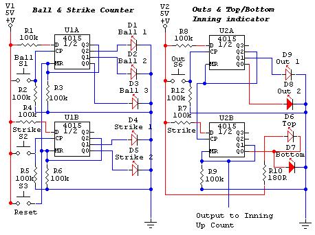

Hi all, I am designing a Ball Scoreboard (You can view my progress in this thread here... ) and I am trying to work out the Outs counter. What I would like it to do is have the LED "TOP" lit up until the output Q0 on U2B in my diagram below has become active or High. (forgive me if I use the wrong terminology I have only been at this stuff for 2 weeks now. Google and forums like this are great for learning quickly)
I think a PNP transistor will do what I want but I am not sure how to use it.
I believe the rest of it is correct (except the resistors on the LEDs) and functions the way I would like.
If this is wrong or could be done better another way please feel free to correct me or point me in the right direction.
Ben

Have you considered this,
Connect a 180R resistor to +5V and the other end to the anode of the LED and the cathode of the LED to Q0.
While Q0 is low the LED is ON, when Q0 is high the LED is OFF...:)
Have I understood your question correctly.?
EDIT: there is no limiting resistor in the top LED D6, it will blow if you power up.!

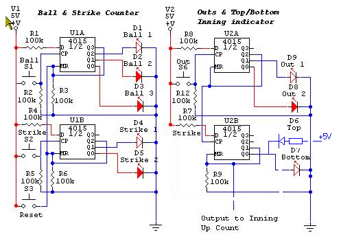

Look at this change.

No I had not but it seems to work correctly in CircuitMaker. I will go this way its nice and simple. (wont hurt the LED will it?) I gather you assumed it was a Red LED needing 1.7V, All I need to change is the 180R to a 150R for 2.1V for a Yellow LED, Is this correct?
Also would this work on a larger scale? cause I will also be using the output to drive a transistor to power a cluster of 5-7 LEDs. I realize that a 4017 is designed to activate each output after the other but i am trying to avoid adding another IC plus this half of the 4015 is not being used.
Thankyou very much for helping me out here.
Are there any other changes you think I should make? I think it all looks pretty good now.
Ben

hi Ben,
IMO its a good idea to fit a low value resistor in series with a LED when its connected to a IC pin.
Post an updated dwg showing the LED cluster.
Ref the resistor value, it [Vsupply - Vled]/0.020 [thats for 20mA]
