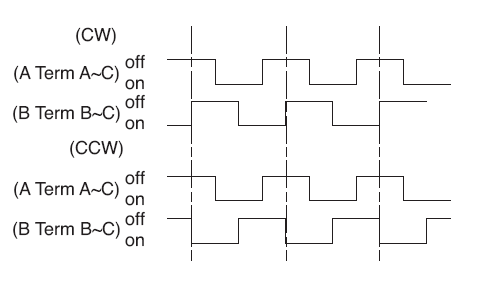

I have spent a few years trying to find a rotary switch like this. Always thinking it was a rotary decoder but is not. It turns endlessly but only performs a 5-step fan speed level. If you look close there is a tiny ball in the one picture that has a solid copper ring. When turning, the ball goes around and then hits a stop but the knob can continue to rotate. Until it turns the other direction the ball then goes 320 degrees the other way and hits the stop again. The first picture drops onto the second picture piece.
I suspect, but could be wrong, as the it rotates it increases or decreases in resistance. But putting a meter on it, the resistance steps and isn't linear. I have 4 switches like this that no longer work and appear to have a short across the outer pins which makes contact simultaneously to both outer polls at the same time.
This is the circuit of how it works. It rotates and creates a momentary circuit closure to the fan speed stepper to increase fan speed clockwise and decreases speed counter-clockwise.
I desperate to find a switch that can replicate this. Only other way to make a repair is to buy a whole used controller just to scavenge this switch.

It looks a !of like a variable resistor / potentiometer, also the manufacturer "Alps" is famous for making this type of component. The fact that the resistance doesn't increase or decrease evenly would seem to suggest that it's a log law potentiometer, the type used for volume controls.
As mentioned above...I have already tried several encoder switches and non have worked. Possibly because the EC11 /EC12 /EN11 series isn't quite the same as Alps used with this one. The duration of the square wave maybe is the issue.
I bought EC12E1220813, EN11HNM1AF15. I had to buy ones that were similarly shaped and sized.
I am willing to buy another series for testing as these are cheap if someone can get me another encoder series.

When you turn it CW and CCW and you get both A and B turning on and off, it means that it must be rotary encoder.
Electrically they are all the same. All the 3 pins are open circuit in rest position and on rotation the 3 pins are short circuit for different duration.

When I tried several different Mouser/Digikey encoders, what happens is when I rotate the switch, the red and green LEDs overlap illumination. In other words, when rotating to the left both LEDs blink, not evenly, but staggered. Or when turned
in either direction the LEDs go Red/green --green/red with about .2 seconds delay. Which confuses the circuitry as it is getting an up/down speed signal at the same time. Whereas the good switch just blinks one color in one turn. I am sure this has something to do with a custom ALPS design in the square wave or whatever. I have a good friend who speaks Japanese and he called ALPS and sent an email of a picture and they said they do not have or make these anymore.

Yes...when measuring one meter lead center tap and one lead on one side, as I rotate the meter momentarily reads a descending resistance, and a rising resistance on the other side. I cannot say exactly as I did this a year ago, but it was something like 4k-7k-10k-16k by each click on the detent and reverse dropping resistance the other direction. After each turn the resistance shows on the meter then goes open in almost less than 1 second.
It's a potentiometer (A custom one). Figure 7, here **broken link removed** would basically describe the operation and a possible way to engineer a replacement with a dual gang potentiometer. Of course, that likely won't fit in your space.
Volume controls have tapers because loudness isn't linear.
The two semicircular "bits" have a non-linear resistance from end to end.
