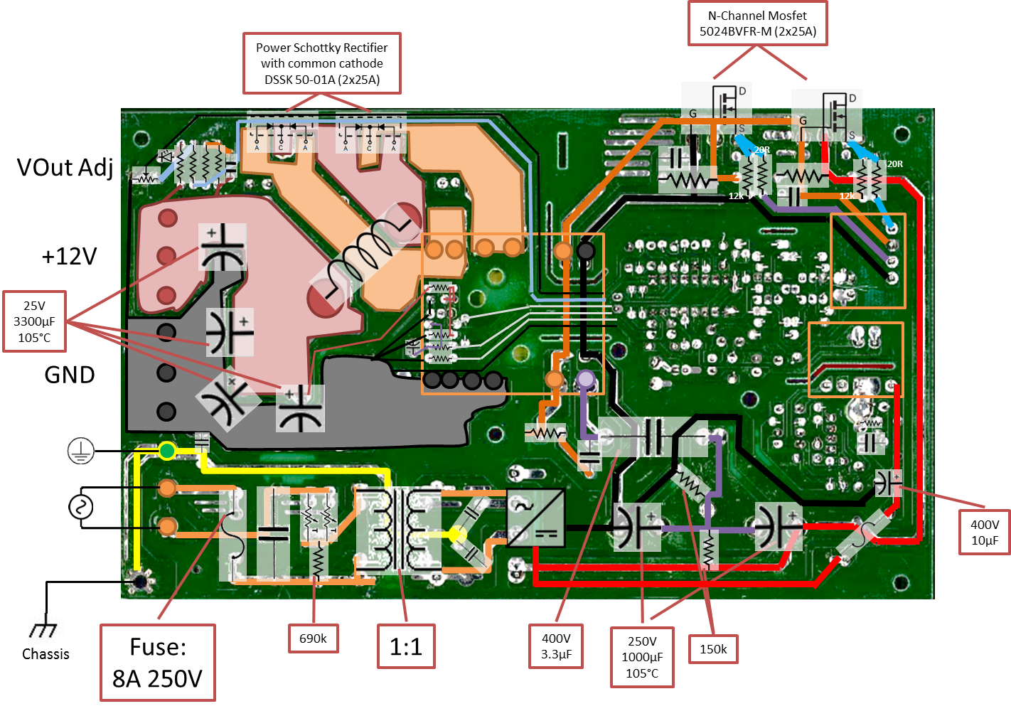

I just received a cheap Chinese power supply. It has very nice specifications and is rated for 500w and 12V DC, cost about 50€ and I would like to investigate whether these cheap eBay/Aliexpress/DX power supplies are worth it.
Here is a look at it once open:
I already noticed a couple of nice features:
  • There is an adjustment screw for the output voltage
  • There are three plus and three GND terminals
Here are just a couple of other observations:
The earth is connected to the chassis through only one screw and if it isn't tight enough your not likely to get a good contact. I'm also not convinced vibration won't damage the PCB and the contact will age well.
The manufacturer either forgot a screw... or is this just another sign of cheap built?
The heatsink is full of thermal paste. I don't really care but it seems tiny aluminium pieces made there way there and stick on it. It can't be good to have tiny pieces of metal flying around in a power supply should they ever come loose.
So these were my first observations. I would appreciate some guidance to go a little deeper in this analysis to better understand what we're dealing with. Is there anybody that could help me? here are a couple of ideas...

Do you have any idea to check how dangerous it is? check for distances between AC and DC on the PCB?

You will most likely find all is safe....just really badly put together...
Like, as I mentioned above, Semiconductors not flush on their cooling heatsinks and so on. You will have crappy Electrolytics that are not made to last etc...
It should work when you plug it in though.

If the PSU does what you require, just consider it as a "part assembled kit", tidy it up using your own ideas and generally accepted good practice, then you have a nice cheap power supply.

It is indeed badly put together... so bad that it wasn't working when I plugged it in :p Semiconductors seem to be flush on the heatsinks but the main transformer had been ripped off from the pcb (that's easy to resolder), probably due to a shock.
I've been spending some time trying to understand the circuit and made a big picture in the process. It is still work in progress but wanted your opinion... (PCB bottom view)
It indeed seems fairly safe but I'm still wondering about the current surge when plugging it in... I also haven't had a chance to look at the regulation circuit yet. The PWM Chip is from TI and reads TL494N.
I just made a quick repair to a IR Repeater that took a 15 foot drop from the roof, but then it's not supposed to be there or dropped from.
The transformer was not fully seated, hence it broke. It's now running off of a DC wall wart, but I plan on replacing the transformer with a small switchmode power supply. It's not uncommon to have large area PCB traces not soldered properly and it's common not to have surge suppression. Too much het sink grease is bad too.
