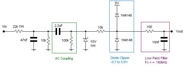

I am building a project to read a vehicle engine RPM. I have been having sleepless nights trying to design the input signal filtering circuit.
The input signal is taken off the vehicle`s coil negative terminal and ideally should provide a pulse of 12V, 0V, 12V, 0V etc... as the engine cylinders fire.
This is not the case as the signal can have some serious resonance and voltage spikes.
Anyhow, I have found a circuit in a magazine that also uses the signal to do REV Limiting and would like to know if someone could help me understand the input filtering part of it?
I understand a fair fit of electronics so just maybe point out to me the building blocks.
Here is the circuit :
The blocks is just my assumed understanding, Please can you correct my understanding and elaborate on the rest of the circuit.
The Output Vout is used to pulse a input pin of a counter.
The Input Vin is from the coil -ve and has resonance and voltage spikes
Your help is appreciated

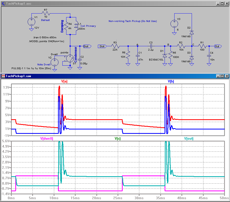

This circuit has some serious problems. Take a look at the output. It would cause multiple counts at each point opening...

From Vin to AC coupling forms a band pass filter. The zener gives a rough clip to +10 volts maximum and attempts to ground out the negative half of the cycle. The 2.2K input resister also provides current limiting for the zener. Given the +5 clamping reference, the output from this circuit probably goes to a T2L Schmitt trigger for final cleaning. Its time constant would be just a little shorter than the maximum pulse rate at maximum RPM. Therefore contact bounce and noise spikes are blocked at that point from your counter rather than at the input coupling circuit.
Does that help?

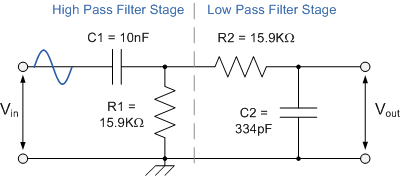

How do you figure that from Vin till the ac coupling is a Band Pass Filter (BPF)? I understood that a BPF had to be comprised of a Low Pass Filter (LPF) and a High Pass Filter (HPF) like in the following picure.
Do you have any reference that the configuration used i.e. 22k,47nf and 10k form a BPF?

Ok, I went and fixed the error I created when inputting your circuit into my LTSpice sim. Here it is again, only now its performance is even worse. I am plotting the four nodes: A, B, C and Out. Notice that the output from your circuit has multiple edges at each points opening, and the output is not sitting at a clean "logic" level during the time the points are closed.
V(A) and V(B) are similar, except for the effect of the DC blocking capacitor, C3. V(C) and V(OUT) are identical, because the low-pass filter R1/C4 is totally ineffective. Like I said earlier, this circuit is not useful. Compare V(OUT) to the V(OUT) in the circuit I posted previously.

Dear Mike
Thank you for your efforts, things do look quite bad in the above circuit... Can I please request you to post the simulation files? I would like to play with it a little before I give up all hope.

22K 1W and 47nF form a single poll low pass filter with a cutoff of about 90 KHz. The 10K and 2.2 mfd form a high pass single poll filter with a cutoff of about 10 Hz. Together they define a single poll band pass filter.
If the first gate of the selected counter is a Schmitt trigger, there is no increase of cost or complexity. Since I have been out of the country for a while, I can’t say if you can still easily find the things in the hobby shops but, one used to be able to find quad Schmitt NAND ICs for a buck or two.
Is this correct or is it a typo.?
22K 1W and 47nF form a single poll low pass filter with a cutoff of about 90 KHz. The 10K and 2.2 mfd form a high pass single poll filter with a cutoff of about 10 Hz. Together they define a single poll band pass filter...
There is the biggest problem with SA's circuit. It should not be a BANDPASS filter, or have a DC blocking capacitor. The signal being filtered is basically a pulse with swings from ground (points closed) to +12V (points open) with a lot of ringing on the edges.
It stands to reason that the circuit should do only two things: clip off the positive/negative peaks (the Zener or diodes), and then LOW-PASS filter the ringing. The circuit MUST have response to DC, so as to pass the dwell.
I believe it is. The 47nf cap passes high freq. to ground so it defines a low pass filter. The 2.2µf cap is in series with the signal path so it defines a high pass filter. I have a reference book (Reference data for radio engineers) with a nomograph for filters. I am assuming the frequencies I got from it are correct. If in doubt, one can do the math manually to verify.
