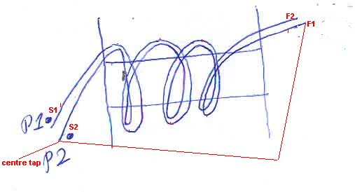

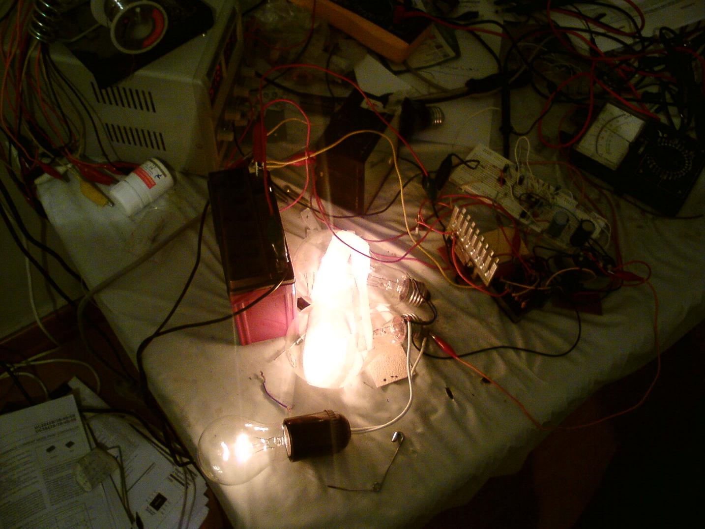

This is schematic of my trans and it have 2x4 turn primary with center tap and secondary 2x15 turn with center tap.
But i have no idle to winding above tnans in the real world on the etd39 bobbin ! :(
Anybody can tell me (with picture ) step by step how to do this pleaseeeeee:eek:

The 'dot' near the ends of the winding mean the start of the winding.
Get two lengths of the wire and wind the primary using the lengths of the wire, that is two turns at the same time.
Repeat the for the secondary winding.
On the primary join the end of one winding to the start of the other. Do the same for the secondary

I wound with above configuration and it`s work !
But look at this output waves
But i found the real voltage wave out is this:
Look at the v1 in the pic, it not look like my circuite! :confused:

Most transformer will 'ring' when driven by a square wave IF they are not correctly terminated, you must have the full circuit connected on the output.

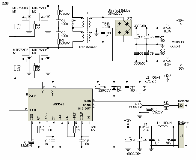

The supply mentioned in the link, schematic attached , doesn't have any regulation or feed back loop. Perhaps it can be better designed.

When i disconnect the diods from secondary the wave out going to normal style !
Umm... i learn now ok , anyway can u see above scope pictures?
You will want to "interleave" the windings... wind half (7.5 turns) of your secondary, then wind the primary (4 turns) and then finish winding the secondary (7.5 turns). This will also reduce the ringing due to leakage inductance and power dissapated in your snubbers.

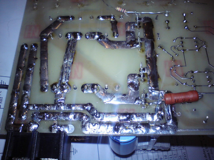

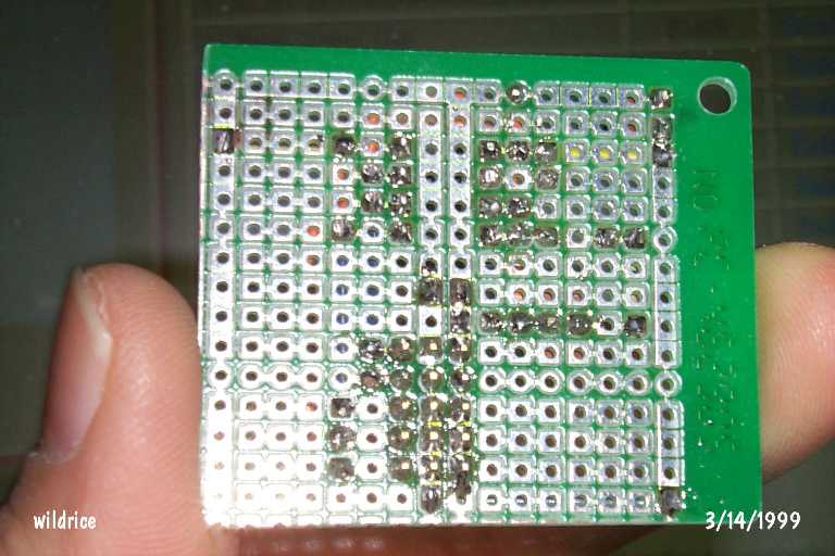

Is this soldered board?
that appears fine for your needs
later if interested you can develop your own PCB artwork for the circuit
Great for trying and completing your project and getting it to work, and attaching a photo.

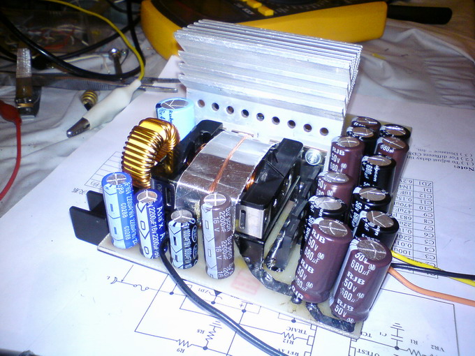

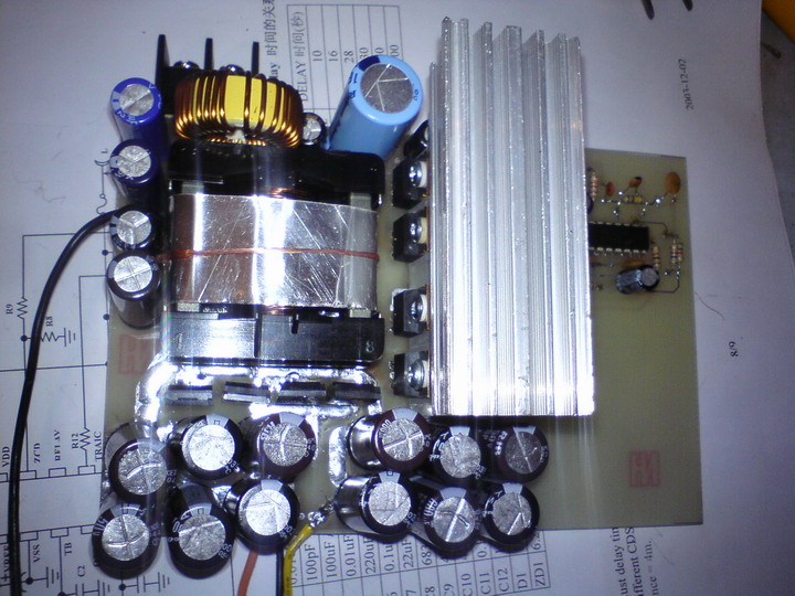

Hi, The project is down and is on the final pcb now.
The efficiency tested and it is about 75-80% under 2.2A current in the output and ripple is 100mv rms and vpp is 240mv. :p
Thanks for your advice...
