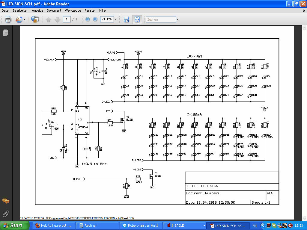

Hi! I am embarrassed to admit I am 64 years old and have scarcely any electrical/electronic experience, save the time I was standing barefoot on a concrete garage floor while dismantling an operating electric clock and touched a 'hot' terminal.
Nevertheless, LEDs are awesome, and I want to get involved in using them. I want to build a small (6" square) LED sign, using 32 LEDs around the perimeter, that will blink at no specific speed, along with 17 LEDs in the center section that would stay lighted when sign is switched "on". I want it powered by a household-outlet plug-in transformer with battery back-up, with a wireless remote off/on switch. I bought 100 ea. 14000-16000 mcd white LEDs that are 3.2 V forward voltage, 60mW 20mA forward current. This is going to be FUN! regardless of how I get there ......... that being said ............ How much trouble am I in? lol
Thanks in advance for any information you will give me toward finding a solution to my project.

If you want the perimeter LEDs to blink all at the same time, yep, you should look at an oscillator with a 555 chip. You'll need a MOSFET switch as well cause if you intend to run your 32 LEDs at 20mA, that's 640mA and the poor 555 will not handle that much !!!!
Then, if you add up the current for the other 17 LEDs, your in for a total of 980mA so you'll need, let's say, a 6V power supply rated for at least, say, 1.2A. You could use a LDO regulator to get your 5V logic supply, and a few others to get the 3.2V for the LEDs (avoiding the needs for a whole bunch of current limiting resistors). I like the MIC5209 500mA LDO series.

A ULN2003 comes to mind for controlling all them LEDs. Then one could use the 555 and PWM to manage all that current.

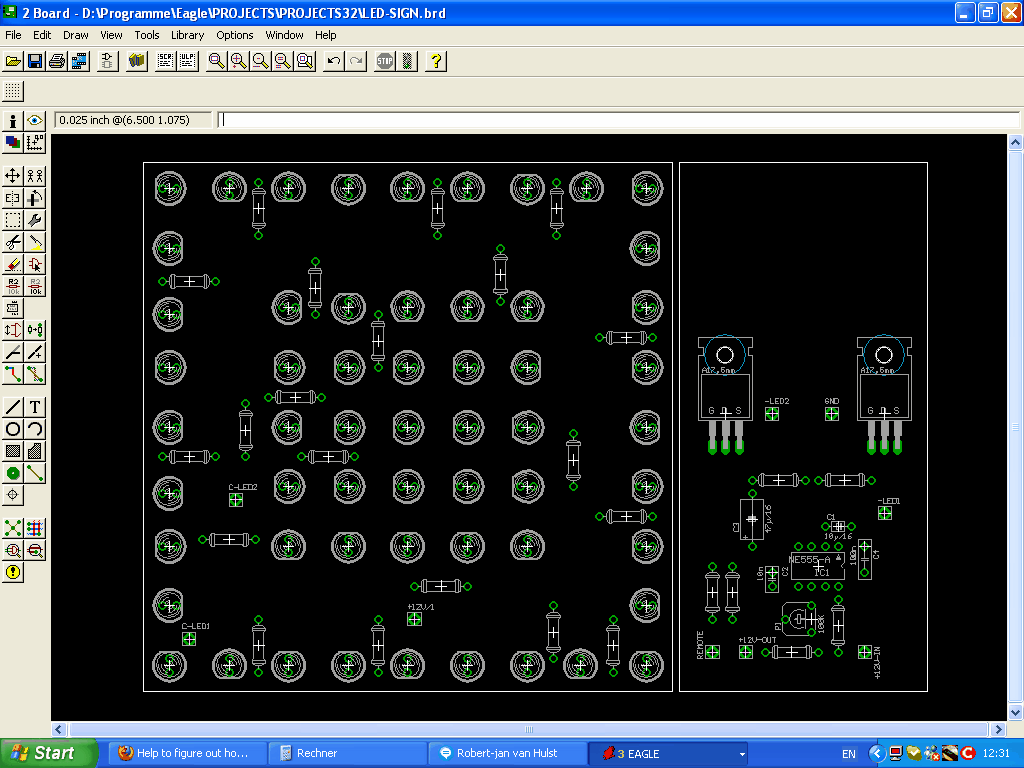

Hi Oops,
here is a circuit suggestion. The board size is 4X4".
Using more LEDs at the same spacing it can be made 6X6".
The MosFet transistors used require no cooling.
Let me know if you want to use more LEDs. Otherwise I'll refine the PCB layout and leave the size.

Thank you, boncuk, for the thumbnail schematics ... and belated Happy Birthday!!
I used the information you gave me, and modified it to accomodate the number of LEDs I wanted, which was different than your schematic. I extrapolated the information you gave me, and I visited my local electronics store that advertises they have what is needed for prototypes. Unfortunately, I missed their somewhat short business hours, and they will not be open again until Tuesday. I plan to go there then, and with a little luck, I will be soldering Tuesday evening!! I can hardly wait!! Thanks again.
