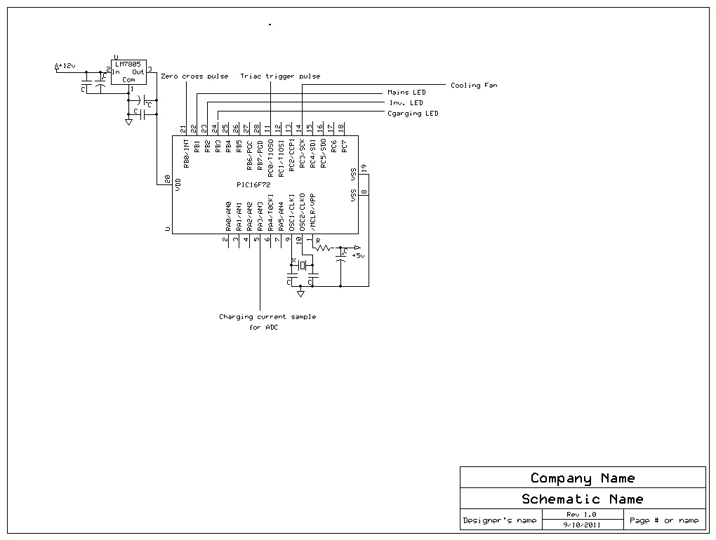

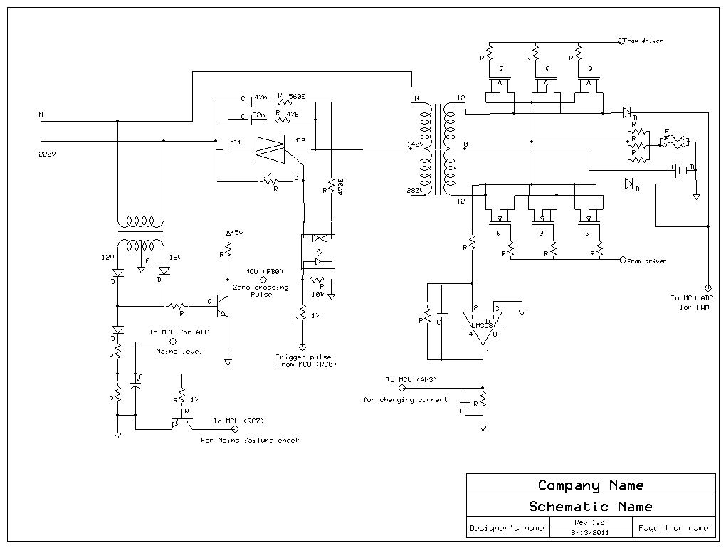

Hi
I have developed a code for a lead acid battery charger using TRIAC in primary side of transformer and controlling firing angle with PIC 16F72. Please see my code and schematic. Battery gets charged properly i.e. at constant current and goes to trickle mode after my preset battery voltage level. But the TRIAC some times gets shorted. During test run of about 2 months, the TRIAC got shorted thrice. I have not used TMR0/TMR1/Interrupt for the code. I doubt if there is any misfiring of the TRIAC. I eagerly wait for any comment/guidance from experts.
regards,
swapan

post hear Ur transformer detels .
