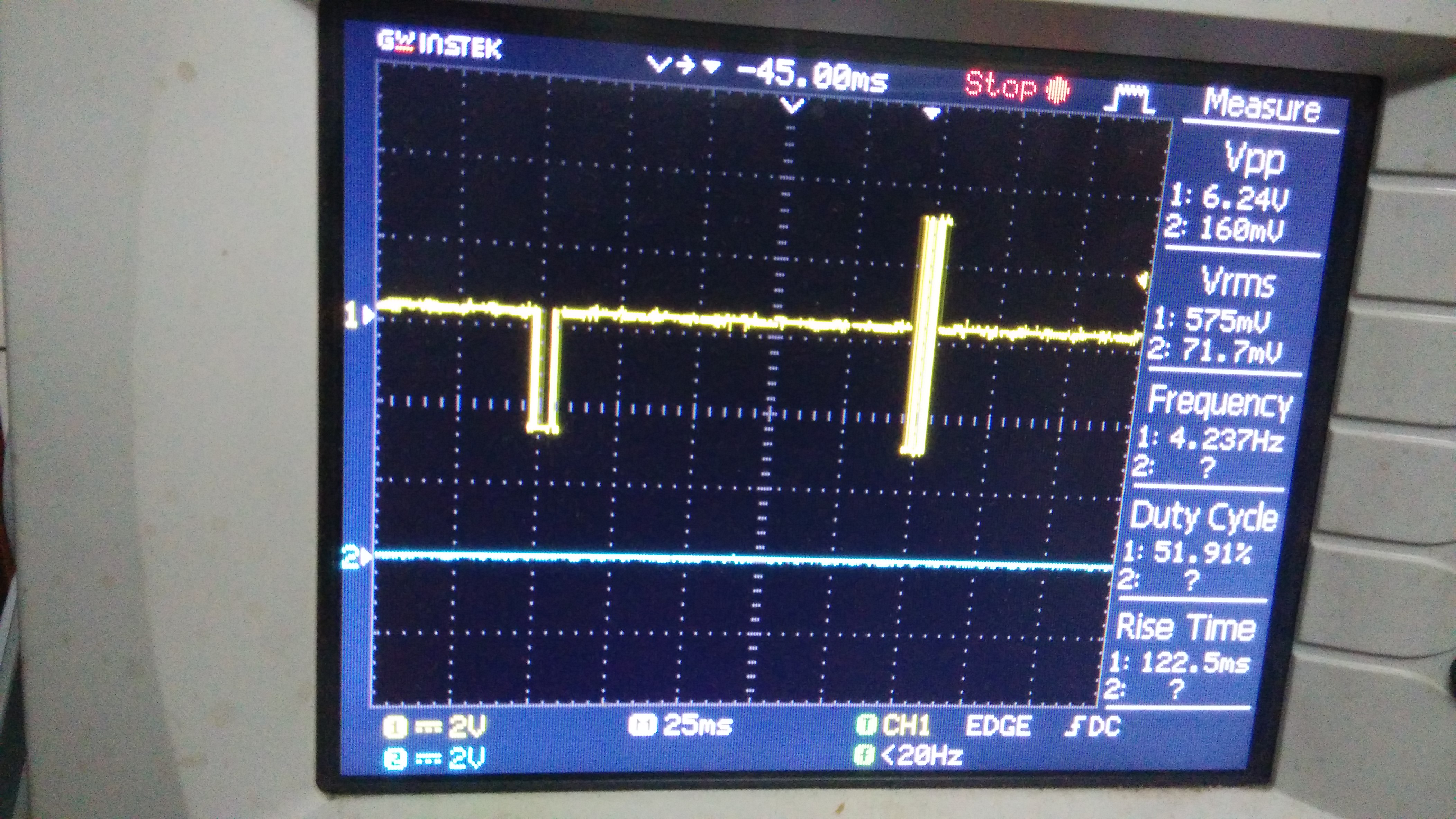

I can see communication with a DSO , and see that the DIR pin is high for all the transmit waveform and low for the receive.
Please guide me, whether i am missing some point, or anything more needs to be done.

Further update:
I am not able to see any receive bytes on serial port monitor.
Attaching the picture of the DSO image across A&B.

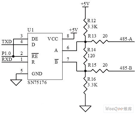

Have you tried it like this you need the 120 bias on both ends
I have been informed that when RS232 convertors are being used you have to ditch the terminating resistor as the bus hasn't enough power.. I put 4k7 pulldown to B and 4k7 pullup top A....
How are you driving the Re and De pins... These should be connected to the RTS on the PC side and connected to a pic pin on the pic side... They CANNOT be left floating...

Earlier I have tried pulling up B line and pulling down A line to no avail.
This is also the wrong way round.... B has to have pull down and A Pullup as Burt's diagram..

I have a pic hooked to a "MCU->SN75176->485-232 converter->232-PCMCIA->MBPOLL " that doesn't say much or show how its wired up or what 485 to rs232 converter your using. And your scope picture where that scope hooked at on the two line 485 I guess it looks like the line is pulled high.
And 1 Kohm isn't like my wiring that I posted and got just a "YES".
It worked Rs232 to Rs232 because you have it my guess wired wrong from the SN75176 to the converter.

The schematic that you posted matched mine and I was typing on a mobile phone so I posted a 'yes' since I didn't wanted to bloat my post.
