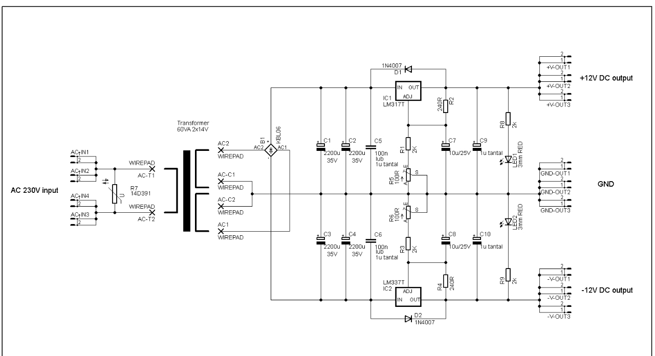

I'm trying to build a power supply 230v ac to 15v 0 15v to a 12vdc 5vdc. I need help. I have a CD of a PSU but as a newbie I'm struggling to make an addition.
What addition are you struggling to make. It's not evident from what you've posted so far.
Without a more detailed review, the schematic looks fine at this point for +/-12 V outputs. The outputs can not be adjusted up to 15 V.

I will start again. I have a Mini Moog Synth circuit diagram and saw that someone had built one.
. I was looking for a PSU for this. I tried Claude AI but after discussing this with other folk its not a road one should go down. I found this https://syntherjack.net/modular-synth-power-supply/ . one thing the AI suggested which I felt I could do was to put an additional 5v output for "future" proofing the synth for any digit additions.

The video you linked has links to other construction pages. The first one has schematics for a power supply that makes +/-20 V unregulated, and +/-10 V regulated. If you are building the same project, why do you need +/-12 V and +/-15 V?

Looks like i missed that page. As I said earlier I put the CD in to Claude AI which gave me a PSU schematic which suggested a 12v +/- with a 230v 15v-0-15v 80va which I now have. Again I'm very new to this. Have had success with a few small kits and a breadboard. Still a long way to go.
