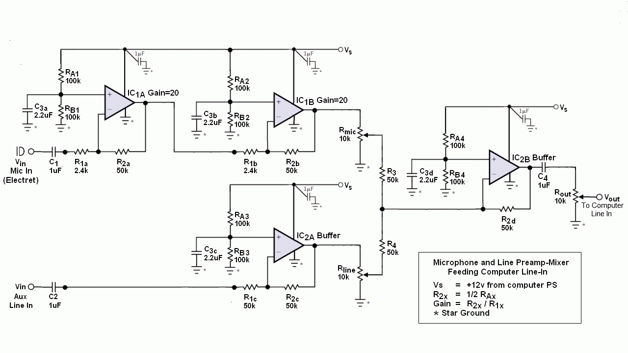

Would anybody please like to take a look at the attached schematic and tell me whether I'm going to get mild smoke, or a real explosion?
The big mystery for me centers around R3 and R4, feeding the output buffer IC2B. I'm not sure what their values should be, or the values of pots Rmic or Rline, or the value of resistor R2d.
The purpose of this preamp-mixer is to feed an electret microphone's amplified output to a computer's line-in. The auxillary line-in is so that a line-in will still be available when the mic is in use.
As you see, the whole thing is built of nearly identical TL072 modules. I kinda think I have these correct, possibly.
I'm using only the +12 volts from the computer power supply, even though there's also about 1/2 watt of -12 volts available. This is because...well, I wanted to see how that would work.
Any help or comment will be greatly appreciated.

Your electret mic will not work because it is not powered. It needs to be fed about 0.5mA from a filtered voltage of about +9V through a 10k resistor.
Your first opamp IC1A is inverting with a low input resistance of only 2.4k ohms which cuts the mic signal in half. IC1A should be a non-inverting opamp with an input rersistance of about 20k to 30k ohms so that it has the full mic signal at its input.
The mixer is OK but R2d can have its value increased if you need more gain.

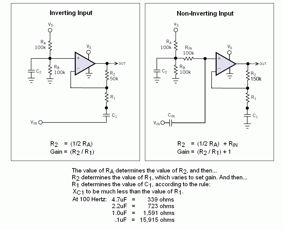

Check the 'sticky' at the top of the General Electronics Chat forum, it contains AudioGuru's Electret mike preamp circuit.
I would agree with AG, it's a BAD idea using an inverting opamp for the first stage - and if you do, you need to seriously consider the impedance.
I'm curious why you want so much gain. With two stages and amplification of 20 for each, your total gain is 400. For a pre-amp, and unless you want to amplify very soft sounds like those from some insects, this is way more gain than you need for the human voice. A single electret mic with built in FET, hooked up in typical fashion can put out around a volt of signal. I believe the actual level depends upon the power supply voltage and resistance of the power resistor. When you mix in several mics, you need about 50k resistors to prevent signal interference, and that resistance can cut down the signal level several times, to around a quarter volt. At least this is my understanding of how it works. Anyway, a single electret doesn't really need a pre-amp for normally audible sounds close to the mic, and even several of them in tandem might even work with a passive mixer, though I'm not recommending that without experimentation. I'm not sure what will then happen if your mic mixer is connected to a power amp with a long cord, but maybe someone more knowledgeable than me can explain further.

<< Check the 'sticky' at the top of the General Electronics Chat forum, it contains AudioGuru's Electret mike preamp circuit. >>
Thanks Nigel, I did check that schematic. Pored over it religiously, in fact. But then I started adding stages of amplification and, more importantly, added a mixer, so I got lost in the valley of what size resistor goes where? But thanks to the help I received here things are improving.

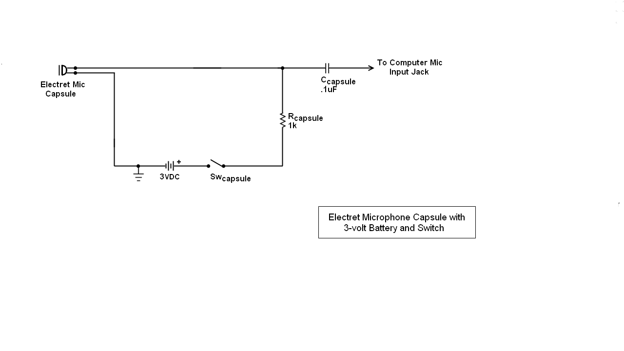

Tom asked:
<< What is the gain of your existing mic setup? >>
No gain at all. It's just an Altoids box (as is required by law) with a switch, and two batteries making 3-VDC. It feeds directly to the computer's microphone jack. For clarity, here's a schematic.

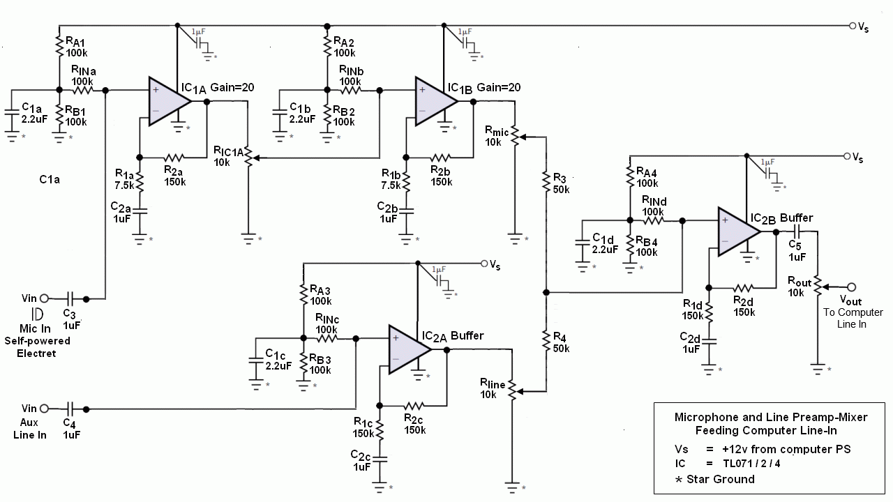

Moving along, I've made changes as advised...I think. New schematic attached.
Although it scares me, I fooled with audioguru's sticky schematic. This because I didn't know how to connect multiple amplification stages, so I went with additional information from Charles Kitchin, who seems to be known figure. Here's his article:

Although I didn't/don't want to take up anybody's time with unnecessary details, maybe some brief clarification is in order.
This is all an attempt on my part to solve two problems:
First: I think I need a higher audio input level to my computer to keep Audacity happy. Possibly because, by choice, I run my motherboard's onboard audio, i.e. no sound card.
Second: Actually more important, WindowsXP already has most of what's needed for making recordings, but once you start trying to do some actual work it gets to be a pain of monumental proportions to click through what seems like 1,000 windows to adjust inputs or levels.
Then add in switching between speakers and headphones...by replugging in the back of the computer. Things get irritating.
So my solution is to bypass Windows entirely. Set the computer's audio levels once and then leave them alone, passing control to the planned preamp and mixer. And also to a switched speaker/headphone output, but I think I have that figured out from surfing these forums.
And as before, the computer's microphone jack is no longer to be used. All input to the computer will be through its line-in jack.
As far as I can tell, a level of about 1-volt is expected at preamp or line-in terminals, so that's my planned input to the computer's line-in jack. If I'm anywhere near the correct levels in my planning, the 3 preamp level controls (mic, line, master-out) will take care of the details...hopefully.

Your new schematic does not have a gain control for the mic preamp so it might be overloaded by a jumbo jet engine nearby or somebody screaming very close to the mic. My preamp circuit in the Sticky has the 470k pot as its gain control. It adjusts the gain from 1 to 214.
Maybe the 150k negative feedback resistor for your 1st opamp should be a pot.

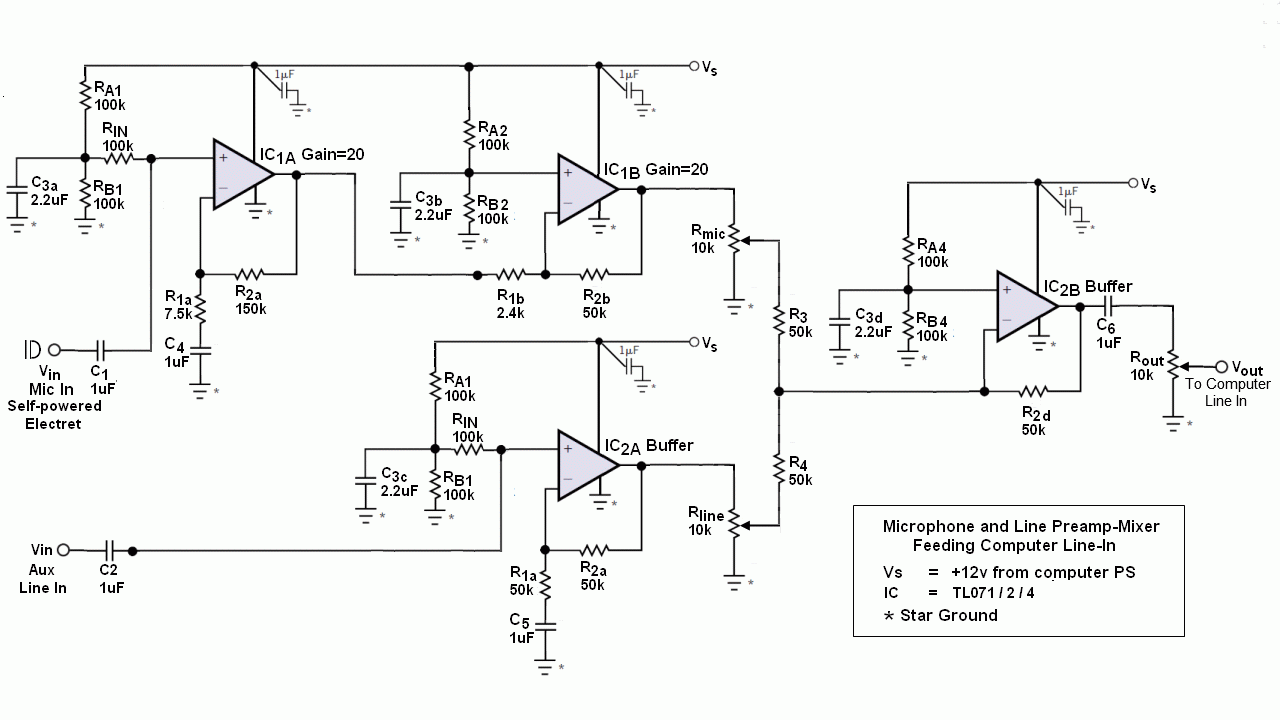

But that was before I ran afoul of Charles Kitchin, waving his degrees and published papers (many). Mr. Kitchin warns in grim detail of the dangers of bias errors, but then offers a solution. And we who keep our pencils in carefully straight lines are influenced by such things.
For those who enjoy confusing themselves, here's a link to Mr. Kitchin's article. I also attach a graphic of his counsel below.
https://www.electro-tech-online.com/custompdfs/2011/02/avoiding.pdf
So bottom line, I drew audioguru's circuit with Mr. Kitchin's additions. All bases covered. When in doubt do everything. If that doesn't work do it again, but louder.
Schematic attached for those who are gluttons for punishment.
Happily, my original confusion was how to connect the stages of amplification, and this was cleared up by audiguru and Nigel. Thanks again for helping me out, and onward to order parts.
