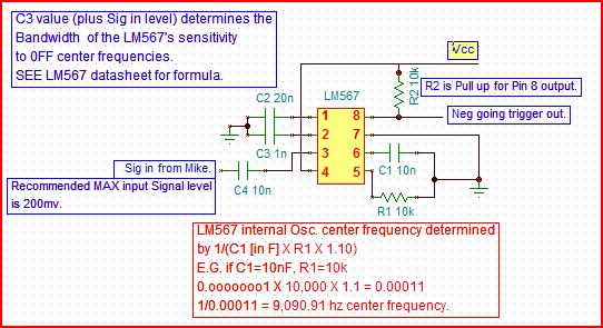

You might consider a simple mike to LM567 circuit configured to detect the frequency(s) of the "buzzer circuit" you're using and use that negative going output pulse as a trigger for the robot's "seek" function. The LM567 will respond to very low input levels (<200mv).
I can provide a schematic, if you like.

Thank you!
This would be so helpful..
Is the output of the chip on/off only?
Yes. Just a negative (0 VDC) trigger (from Vcc) that has a pulse width equal to the duration of the signal that matches the center freq of the VCO of the LM567 (within the bandwidth limits).

Once the homing signal (assuming its not just a continuous blare) gets through the bandpass filter (BPF) you'll still need to turn that signal into a trigger of some sort.
As 4pyros points out, both functions (detection [plus variable bandwidth selection] and conversion to a usable trigger) are accomplished with the one chip.
I had initially tried a BPF method and the first problem I ran into was what sort of filter to use to get the "tightness" of the filtering I needed (1st order, 2nd order, 3rd order, etc., each successively more complex) and within an audio situation with lots of noise and harmonics.
And then, of course, I then needed a circuit to act as a trigger (simple rectifier, comparator, wharever).
I had not heard of the LM567 but a search of ETO produced the idea. I bought 10 of them (remarkably cheap) and haven't looked back.

The LM567 works but not well. But it is simple.

The LM567 works but not well...
Well, depends, I guess.
Worked very well for me, and good old Ma Bell as well.
And I can confirm (due to numerous Vcc and input signal level overshoot mistakes :banghead:) that it is remarkably bullet proof...
The goal is to find the sound. Go to the sound. The LM567 will detect if there is that sound but not how loud or where it is located.
