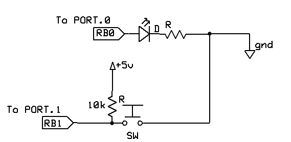

i want to make a circuit to make a led turn on when i push the push button
by using these code

What's the problem with the circuit? Hook the switch up to the input line, and the led to the output line...
Killer you don't check to see if PORTA.F0 there isn't a port like that on a pic
Here this should get you started
