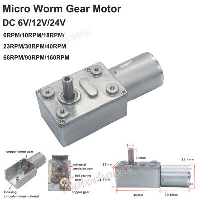

Possibly something in this general style, with the speed appropriate for whatever door drive linkage you intend to use?
I'd aim for something between 15 - 30 seconds for a full closed to open swing, so nothing is ever moving fast enough to damage the mechanism when the motor stops at the end of the movement.

Could you use a automotive power seat motor? They are geared down, so the speed is reasonable and they have plenty of torque.
Mount a square door to the motor at the corner. Rotate 90° to open, reverse polarity and rotate back 90° to close. Limit switches stop the rotation at each end.
Some of the motors I've seen have a large disk attached to gear, which would make the door easy to attach.

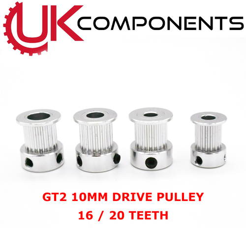

For the drive mechanism, the simplest is probably a loop of timing belt such as this:
With a suitable pulley directly on a geared motor shaft and an idler at the other end to tension it.
Attach a link from the top of the door to the belt, so it pulls/pushes parallel to the "garage" ceiling, just like a full size garage door operator unit that uses belt drive.
A small geared motor as I posted earlier could lift quite a solid and heavy door, or any mass with a counterweight on a pulley from the door.
You could drive both end doors from the same belt loop by attaching the door links to opposite sides of the loop, if you put the motor and idler vertically above and close enough to the ends, so the link attachments are always clear of the pulleys.
You can get all sorts of clamps and fittings for attaching to the belt, as it's very common in 3D printers and robotics etc., eg.
