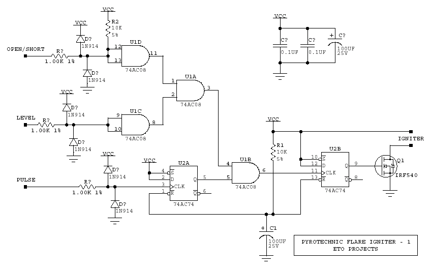

Here's a little something to chew on after dinner. It looks more complex than it actually is, partly because of three external transient suppression networks. These might go away with more information about the input signals and the operating environment.
ak
  • Flare-Igniter-1-c.pdf
Hi AK,
The above circuit would trigger if the 5 volt level started out as high and there was no short to ground to start with when the pulse occured. As the OP used the term "transitions from" I interpreted the requirement as needing to see the transitions not just the static levels. I think you need a flipflop to look for the transition on all three inputs. (You would then not need the flipflop on the input to the mosfet.)
Les.
Also, Q1 is an obvious single point failure, if it conducts for spurious reasons, the igniter fires.
I would ask the OP, is this a serious development for a real device or an academic study?
If this is for a real device which can go bang and hurt people in a big way, an internet forum is a dubious venue for a design meeting.
I am sorry to introduce a bit of a negative outlook to this, but this is not a trivial task.

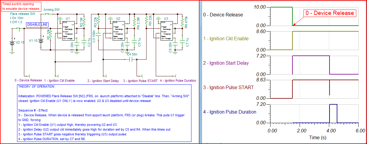

U1 through U3 are 555s due to inherent switch bounce advantages. All circuit components from V1 to the right are in the flare. V2 and the "Flare release SW" are on the launch platform. V1 and V2 voltage levels are arbitrary. Follow best circuit design criteria for 555s chosen.
The initial "SAFE" state of the circuit would be:
"Arming SW" OFF. "Flare release SW" ON, "DISABLE LINE" attached to flare circuit (this forces a positive bias on the trigger of U1, ensuring NO OUTPUT from U1 on power up).
Theory of operation:
Time -1 - "Arming SW" closed. U1 ONLY powered up.
TIME 0 - Device release. A switch (or plug removal) removes the +12vdc bias on the trigger of U1, forcing its output HIGH which immediately:
TIME 1 - powers up U2 and U3.
TIME 2 - U2's output goes HIGH for a duration determined by R4 and C5. When U2 times out:
TIME 3 - U2's output goes LOW which puts a negative pulse on U3's trigger, forcing U3's output HIGH, which:
TIME 4 - has a duration (to ensure the flare's proper ignition) set by R6 and C7. This output would feed a small relay or transistor/FET switch enabling a separate, isolated third power source for the ignition heater.
If something other than ignition delay after launch is needed, this circuit will have to be modified.
