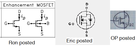

hi him,
Ref your diagram, if my notes are correct the drawing of the MOSFET is incorrect, its showing a P channel device, is this the original drawing.
You require a 60v 50amp equivalent enhancement mode, MOSFET N channel.
The S2X series looks suitable.

Eric, I think the symbol is correct. You were probably thinking of the variant where the substrate junction is shown on the body. See

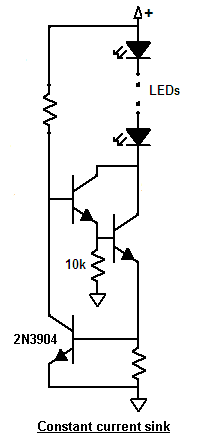

There is no way some LEDs in series need to be driven with a 50A Mosfet! Any N-channel power Mosfet will work or an NPN darlington power transistor will also work.
A 5W Luxeon LED has a max current of less than only 2A.
This regulated current circuit works well:
The main difference is that a MOSFET will have marginally more headroom (work with a slightly lower supply), and the bigger the MOSFET, the lower the voltage can go. Smaller MOSFETs require higher gate voltage for a given current. This would probably only be an issue if you were using just one LED. Smaller MOSFETs also have higher IR drop.
I realize that these factors are usually unimportant, but could be in some circumstances.
hi RonH,
The FQP50N06 which the OP has in parts list is a MOSFET N channel, enhancement device.
According to the datasheet gate arrow' should be pointing left.
As you say possibly a variant. ???
EricG
EDIT:
arrow indicating the substrate-to-source and substrate-to-drain junction direction

Eric, it's actually an arrow indicating the substrate-to-source and substrate-to-drain junction direction. Below is a drawing from the link I had in my previous post.

hi Ron,
Perhaps my more poor wording was not technically accurate, I shouldn't be so sloppy.
Should read as per RonH'

Eric, I wasn't nitpicking your wording. I was pointing out that the symbol in the OP's schematic is correct. Did you look at the drawing I posted? If you have evidence that this is wrong, can you post it?
hi Ron,
Relooked at your dwg, agree top right MOS shows, N channel enhancement MOSFET.
As does my 'copy/paste' from the datasheet for the FQP50N064L, which is listed in the OP's parts list.
Its just that the drawing posted by the OP, shows a 'variant' in that the arrow is in the other direction.
[or am going crazy, (answers on a postcard only, please)]
Ron, I know that you are not nit picking, I welcome our technical interactive posts, hope to have many more!.
Regards
Eric
Comparing the orginal dwg,with your diagrams, 'suggests' a P type depletion, which it cant be???

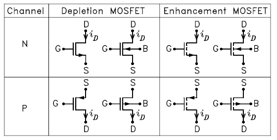

One of us is going nuts. Below is a comparison of the various symbols in question. All are of N-channel MOSFETs. All are correct (AFAIK).
I can't see how you equated the OP's symbol with P type depletion.
Maybe he did the same thing I did. I saw the symbol on the data sheet, noticed the arrow was different, and guessed the hand-drawn symbol was supposed to represent a P-type. Thanks for clearing this up, I think.
