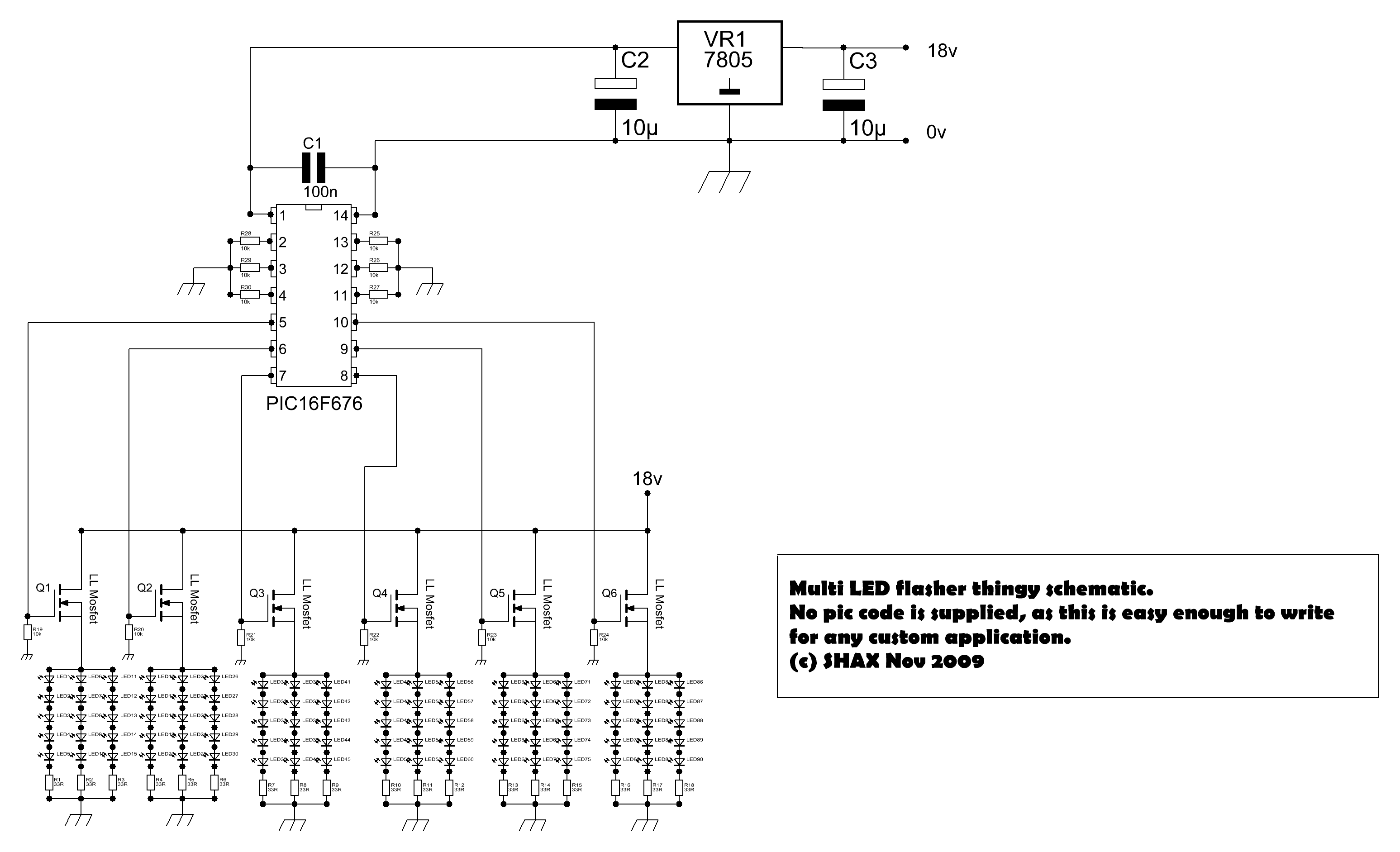

Multi LED flasher thingy schematic
I knocked up a quick schematic of what you will need to do. This shows 90 white leds connected to 6 of the 12 ports of a PIC16F676, which drives logic level mosfets.. It's all easily scalable to use any number of leds, but you should get the basic idea.
Writing the code for the pic would be a simple matter, and shouldn't take more than about an hour. :D
The unused ports have been tied to ground, but could be assigned to push buttons to allow speeding up of the flashing, resetting etc etc...
I haven't tried this schematic, but it's really simple.
