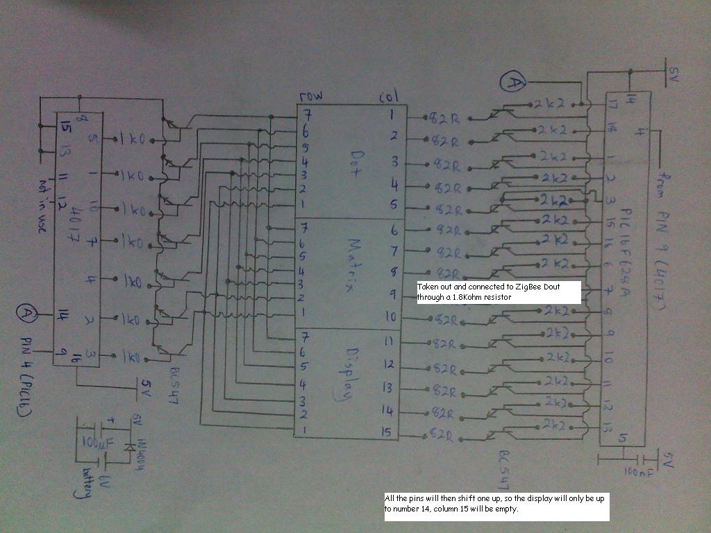

Hey there,
Sure thing. Okay. The whole program supposed to work in this way. Initially in the PIC EEPROM, there will be data of which probably will write some welcome message or something. So the PIC will take out data from the EEPROM and display it out accordingly. The display size will be 14x7 where the 7 rows are driven by a 4017 decade counter, and the 14 columns are from the PIC, PORTA and PORTB. RA5 and RB1/RX are input only ports and RB1 will be connected to the ZigBee Dout pin, to receive data. When there is new data, the PIC will halt its operation, and take the new data and write in the EEPROM, clear its registers(reset) and start displaying the new data all over.
Only one way communication will occur from PC to PIC which is PC sends out serial data to PIC, PIC stores in EEPROM, and when transmission of data string is completed, PIC will display the message that is stored in EEPROM accordingly. The last byte of EEPROM will contain number of characters for the PIC to read to display the string data that was send earlier. So meaning if I initially in EEPROM there was 'abcd', the last byte will store 0x04 and if I send a new string of data, say '1234567', the last byte of EEPROM will store 0x07. So there will need to be a counter to keep track of the length of the incoming data string and be stored in EEPROM last byte. Data will be stored in ASCII characters. So, using lookup table will need to include the sublw command.
Only one way communication will occur from PC to PIC. PC will send data to PIC through ZigBee and PIC will not send any serial data out to ZigBee/PC.
On the MCLRE part, I'm using RA5 to get an input from the 4017 counter so that the PIC knows that it needs to clock the 4017 counter 3 times to ensure that the display will display out properly.
Attached is the hardware design(Hardware.JPG). For the dot-matrix, I'm using common cathode and the pin configuration is the same as most commonly used dot-matrix. The model number is 'TE 05457054N239M', but I can't find any datasheet on it. Please advice if my design is wrong. Thanks in advance.
