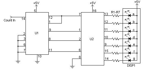

(1)There is a major problem with the 7 segment LED counter (using 74LS90 TTL BCD counter IC & 74LS47 TTL seven segment display driver IC). I have built one but it start at 1 rather than 0. Then i tried building another same one and this time it start with '5' (i have tried building it again and again but it still start at '5'). I have tried to combine the two circuit and I am getting '51' (as the first circuit start with '1' & the second circuit start with '5') but i want it to start/begin at 00(zero). I have made some research on the 74LS90 TTL BCD counter IC, and found out that using pin 1&2 and 6&7 can reset the counter. But I have problem figuring out the connections. I am not even sure wether resetting it will give make it into 00(zero) or reset it to '51'. (everything was done on a brick board and tested on a 'logic trainer' using 5V).
(2)There is another funny thing about this counter. Every time I off the main power source, it will randomly show a number before turning off and if I turn it on too fast(right after I turn it off) it will begin with another number (lets say, normally it begins with '5', when turned off-on too fast it will start with '9'). Is there an explanation to this?
Is there anyone able to solve my problems especially problem (1)... hope to get a reply as soon as possible. Thanks.
When You switch off the psu, the filter capacitor slowly discharged by circuits. In this time the cct work randomly. For switch-on reset use an RC component on reset pins. The 100nF filter cap need for all IC supply pin.
I agree with Sebi. You did not have a "reset at switch on" circuit or a supply bypass capacitor.
With no reset, it will assume a random state at switch on. With no bypass, odd things can happen due to switching transients.

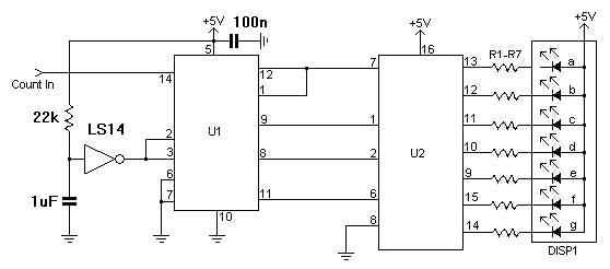

You could improve it by inserting a Hex Schmitt Trigger IC, a 74LS14.
Connect the output of one Schmitt to the reset pins (pins 2 & 3) (having first removed the resistor and capacitor) and connect a capacitor from the input to gnd and a resistor from that input to Vcc. The same resistor and capacitor will do.
When the power is switched on, the capacitor will be discharged and so the output of the Schmitt will go high, thus resetting the counter. When the capacitor has charged to the + threshold of the Schmitt, the output will go low thus removing the reset.

I have tried modifying the circuit according to what Sebi did but it doesnt seems to work. Infact the 7 segment display didnt even light up. Can someone tells me what is wrong? Can someone teachs me how to add a 'reset at switch on' to the circuit.
Actually, i didnt used the 1uF cpacitor but 2.2uF instead bcos i couldnt get the 1uF. Is that the reason why it didnt work? But i think that is not the reason. Can someone please guide me?
I have finally able to add a reset switch to the circuit by just connecting pin 2&3 (74LS90) to another switch instead of connecting the two pins to ground. I have to first on the switch '1' in order to get 0(zero), then i need to turn the switch off '0' because the counter only counts when the pin 2&3 is low, '0'. But i would still prefer it to reset on its own to zero when starting rather than control by a switch. Is there a way? Anyone has any ideas?

I agrre with Len, the schmitt-trigger solution always better. The capacitor value should be higher.

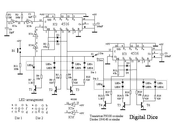

Here is a "Digital Dice" circuit that I built some years ago.
