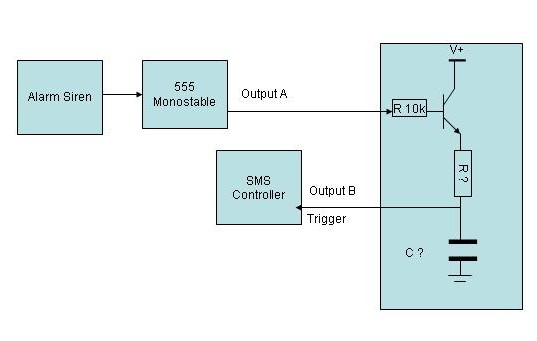

I want to put it in my car, for when my car alarm goes off, the sms controller must sms me.
The problem that I have now is how to use the siren output to trigger the sms controller input.
I thought of using the siren output, but the problem is every time I activate or deactivate the alarm I receive a sms. I need a type of time delay circuit, so that if the siren go on for say about more then 5 seconds, the sms controller must be activated.
Hope you guys understand what I am trying to ask.
Also to assist with your problem, can you please specify how the trigger of the sms controller works? Is it triggered on high or low level transistion?

Okay, to assist you, I can suggest that you use a 555 in monostable with a short output pulse. Use this to drive a simple 2N2222(or any NPN) transistor as a switch use the transistor to charge a capacitor through a resistor. By choosing suitable values you can cause the cap to charge slowly, i.e 0V... 0.2V ... 0.5V ... 1V etc till it reaches above 3V. This will only happen if the alarm has been on (triggering the 555) for awhile.
Alternativly you can search for the alarm box and use a multimeter to see which terminal is controlling the alarm.

Something like this ....
The charging of the capacitor is controlled by time constant RC.
R * C is the time it will take to charge to about 66% of Supply Voltage
Sorry. The monostable circuits that I get on the net is all with a manual switch. I am not sure how to connect the siren to is.
