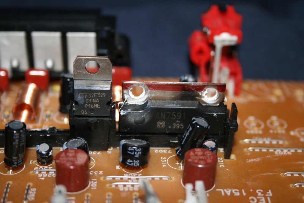

I have a tabletop stereo that fell from ~6ft and the left audio channel went out. I tracked it down to two broken transistors (I think that's what they are...). The image attached shows the good ones and their part numbers.
Where can I buy one each of these transistors?

The one on the right is not a transistor, it's an IC.
I don't recognise the part number on either of them. The three pined device looks even more weird and Google didn't return any results so I suppose I can't help you.
The P16NE is an N-channel 60 V MOSFET from ST Micro.
I haven't located the other part yet. It's probably some sort of transistor array for amplifying multiple audio channels, and may be a proprietary part.
It looks pretty generic, the IRF540 will be a reasonable subsitute.
Found one source for the AN7591:
Looks like they have a $50 minimum order, though. Might be worth it, if you have a bunch of other semis you want to get at the same time. This page also supplies some additional information: the part is produced by Matsu and is an AF power output IC. At least now you know it's not a proprietary.
