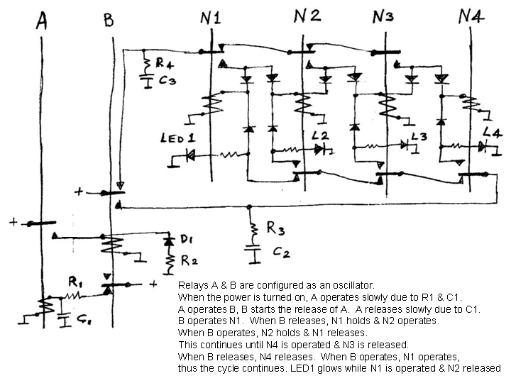

Hi, hey I was just curious if anyone can post or direct me to a timer circuit that uses capacitors that discharge in sequence to make leds flash, preferebly quite slowly, like (one onthousand *FLASH* two onthousand *FLASH* Three onethousand *FLASH*, etc.)? Here is the catch....I want to do this using no digital logic chips or transistors, only caps, resistors and, relays. I have already made a circuit that does this except that the leds flash really fast, too fast. Let me know...

Have you tried putting a large value of capacitor in parallel with the relay coil to slow down the energizing time? You could do that and daisy chain a bunch of relays. Once on turns on have it's contacts energize the next and so on.
Yes, that is essentually how I originally made the circuit I have been messing with...It works, but still the leds flash really, really fast (even with a 2200uf cap) unless, mabe I dont have it wired together correctly, or need many caps in parrellel....I got the idea from a circuit I found online, however the relays in the circuit I found have many outputs, mine only have two, one (on) when not energised, one (on) when the relay is energised.

You need a resistor in series with the relay coil and a cap across the coil.
This will slow both the operate and release times.

In order to flash the LEDs, I suggest you use a relay counter driven by a relay oscillator.
I'll design one for you and post it tomorrow.

Here is the relay counter proposal that I mentioned above.
If you want me to fill in the resistor and capacitor values, I will need the data on the relays you intend to use.

Wow thanks ljcox, ya know you didnt have to go through all the trouble with that sketch but I really appriciate that you did...Well the relays I have are here.. Russian made, high quality relays RES-15...Control voltage is 2.8V 60mA. Switching voltage up to 150V 100mA. Thats all the info I have on them as I picked em up off ebay and the box they came in is written in Russian. 72 for about $21.00 USD which includes shipping, a good price I thought. Here is a link to them on ebay... **broken link removed**

These relays have a rather low coil resistance, ie. about 47 Ohm.
This means that C1 will have to be rather large unless you can find a relay with a higher resistance coil for relay A.
What supply voltage do you want to operate it from?
If you used say 3 Volt, then the B, N2 & N3 relays would have to be 2 relays with their coils in parallel. Or if you used 6 Volt, then the coils could be in series. But the N1 & N4 relays would need a 47 Ohm resistor is series with their coils.
The circuit as drawn is a Modulo 4 counter. I expect that you realise that you can increase or decrease this if you wish. For example if you want a Modulo 6 counter, then you would add 2 more sections like the N2 & N3 sections.
