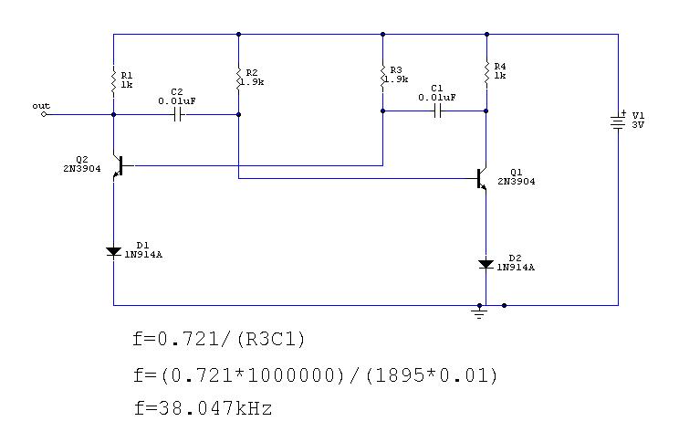

i was wandering can i use simple multivibrator circuit to generate 38khz signal to use as a IR transmitter for TSOP1738?
i did some readings and calculations and came up with resistor and transistor values that gives 38khz.
but since i don't have a oscilloscope i don't know whether this circuit will work.
and most importantly all 38khz IR transmitter circuits on internet are based on NE555.i wonder why nobody use a multivibrator?
calculations are based on article

here is my circuit diagram

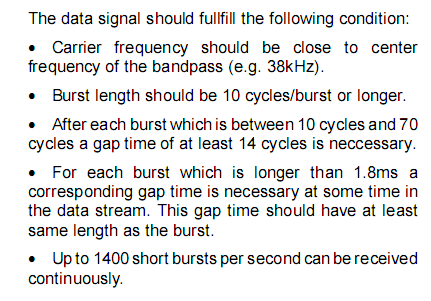

well actually there are TSOP ir modules that supports continoues signals.ex TSOP 1738 it does not low its gain when continoues 38khz signal is available.chk the datasheet

Yes, of course - an astable multivibrator is a VERY old tried and tested device.
Four points though:
1) D1 and D2 aren't needed for a 3V supply, only once you get to about 9V or so.
2) The resistors seem very low values, it makes more sense to be much higher.
3) The IR LED should be directly in the collector of one of the transistors, saving an extra transistor to drive it - although for longest range you may need a driver anyway.
4) You don't need it to be 50/50 mark/space ratio - short high current pulses with a longer space time increases range as well, with no increase in power consumption.
well i didnt get that one,can you explain little bit?
Conventionally the LED will be ON 50% of the time, and OFF 50% of the time, 50/50 ratio - but if you make the ON time 20%, and the OFF time 80% you can increase the current fed to the LED (by two and a half times as much) and increase the range. This doesn't increase power consumption, so it's a range increase for 'free'.

I have just read your datasheet and the way I read it, says data bursts are required, not continuos transmission. ?
The d/s is a little misleading in saying continuous.
well actually i have used TSOP1738 in one of campus my project.those days i didnt know about continoues data transmission,all i knew was it low its output when recieving 38khz signal.i used a continues 38khz ir signal (used NE555).and it worked
Over what distance? - they don't stop working, they just drastically reduce the gain, assuming it's unwanted interference, to prevent the receiver been swamped.

well it worked about 1.5 meters.and I'm sure it didn't reduce gain.(coz i used interrupt to detect Ir signal so if it reduce gain then interrupt would be triggered unnecessarily)
I should hope it did work at 1.5 meters, that's an incredibly short range - and the range WILL have been drastically shortened - I see no relevence of you using interrupts or anything else. The ONLY way to know if the gain has been reduced is to measure how far away it works - on normal pulsed signals (as designed) 15 meters is easy to do.
