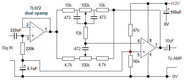

Hi I have this preamp circuit connected to my amplifier. Can somebody tell me how to increase the BASS of this preamp? What changes do I have to do?

This is a standard Baxandall tone controls circuit that has a range of boost or cut of about 20dB which is planty.
Are the pots linear?
Is the source impedance very low like from the output of another opamp?
Is the load impedance 10k or higher?

The tone control circuit should be fed from the extremely low output impedance of an opamp. Then the new opamp can be fed audio from any audio source.

You mean to give input via another op amp? can I use same TL071 for that also?

Use a second opamp. A TL072 has two opamps in an 8-pins case.

Add the second opamp like this:

Thank you very much audioguru for your support.I'll make it for sure.
This time I'll have plenty of bass.
