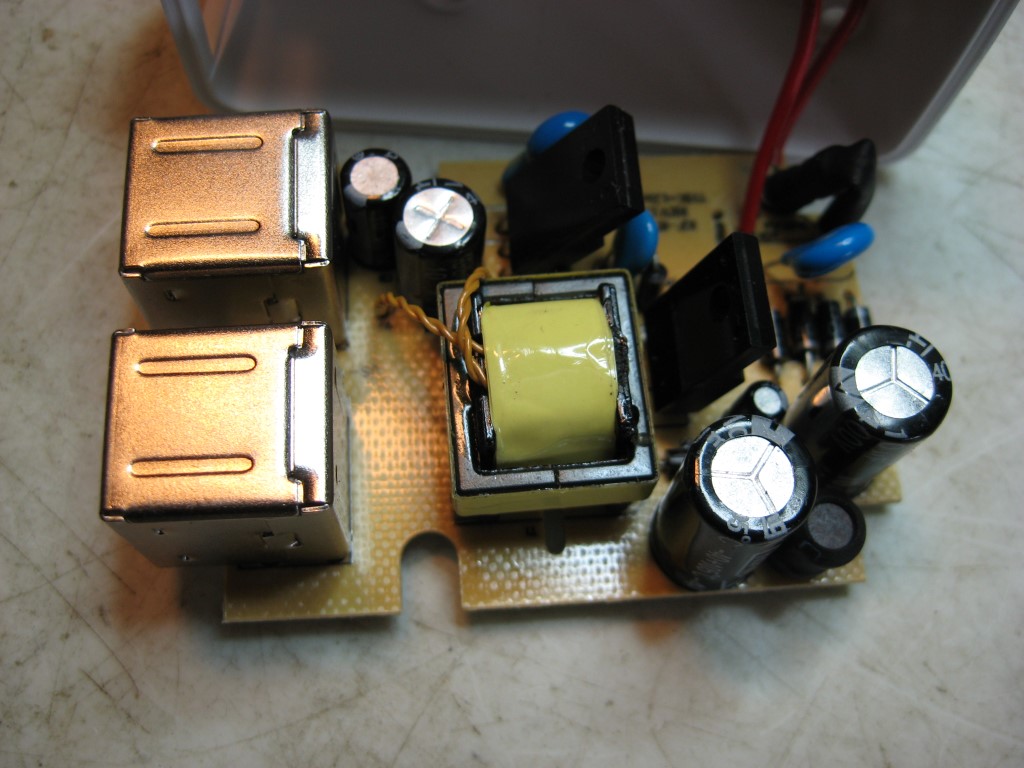

Firstly, Thank you Les and Alec. I live in India. Well we cannot use a bought out power supply as the monthly requirement we are forecasting is 1000 units. I tried opening a faulty Apple iPhone charger and found that it does not use a transformer. It is so light in weight too. I need to build one myself to make it most cost effective.
I bet it does. There'll be a lttle sugar-cube sized high frequency transformer in there somewhere ;).
There will be a transformer in the apple charger but it will be very small as it will be working with a high frequency. It will probably be about a 15mm cube.
This picture shows the transformer in the unit that gives 4 x 5 volts at 500mA The connectors on the left are the USB sockets.
