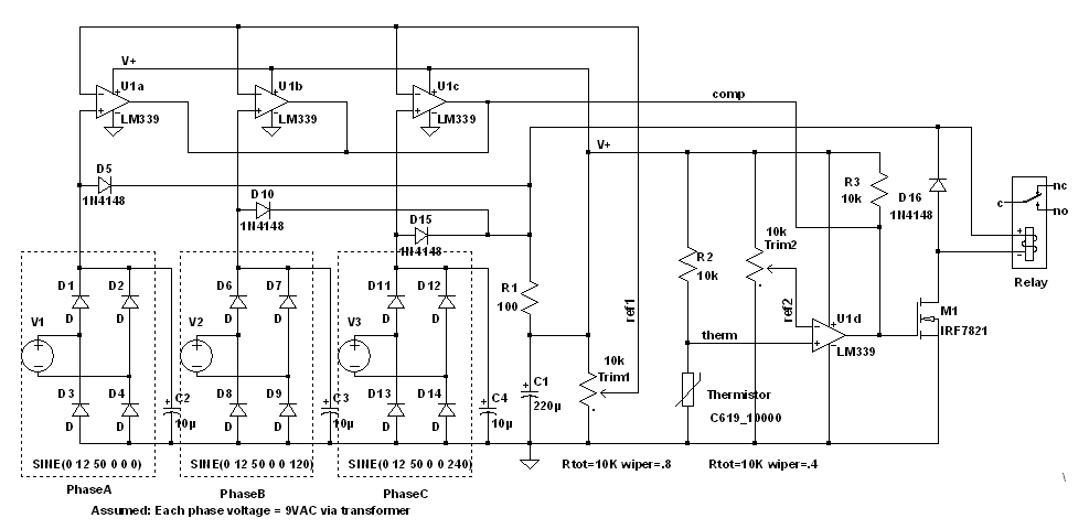

Hii, i am now working on my mini-project "Induction motor protection". For that i need four comparator circuit driving four 12V relays, in which 3 of them are for protection against single phasing and 1 for over temperature protection. i am using a 7805 regulator IC so that i can get constant 5V for driving comparator IC LM339. Can anybody help me to design the comparator section,please? Thanks in advance. :)

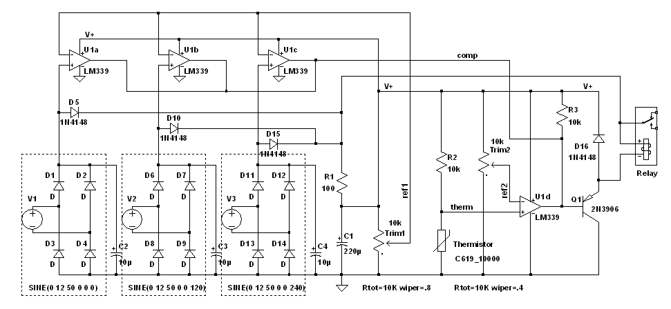

How about this as a slight variation on the theme.
The four comparators are connected such that if any one phase fails (volts drop below a percentage set by Trim1), or the temperature goes over limit (set by Trim2), the transistor Q1 turns on to activate the relay. Note there is no voltage regulator; the system is ratiometric, i.e. the reference voltages are fixed fractions of the supply voltage. Simulation shows that the temperature trip point varies by only ~0.2C with a supply voltage change from 9V to 12V.

What is the purpose of the four 12V relays? The single relay I showed could be used to control a 3-phase contactor to switch off the motor when any one of the four comparator outputs goes low.
Ok.. I need some more clarification please. From where should we take the +V dc voltage for Vcc and biasing for LM339? Does it need a regulator for that? Does each comparator of LM339 need a pull up resistor to obtain the output? it is missing on this circuit i guess
One more please, in the circuit shown by you the four comparators are connected such that if any one phase fails (volts drop below a percentage set by Trim1), or the temperature goes over limit, the transistor Q1 turns on to activate the relay. I want to get the relay activated all the time when circuit runs at normal condition and relay should turn off whenever any fault occurs, thereby isolating the 3 phase supply from motor. Is that possible to do so?
It's shown as V+ in my schematic and is derived by using diodes D5/D10/D15 to "OR" the 12V outputs of the three rectifier bridges (shown in the three dotted-line rectangles), so that as long as one or more phases is active there will be ~12V across C1. I have assumed transformers are used to drive the bridges. You may have other ideas as to how to get ~12VDC voltages from the three phases.
I don't see the need for one. As I said, even a 9V-12V variation in V+ gives rise to little variation in the trip point.
No. They are wire-ORed and share a single pull-up R3.

Here you go:

**broken link removed** provides a very good write up on the LM339 comparator family. I suggest you read it and understand how the circuit Alec was kind enough to provide works, after all this is your mini project. Look at Alec's circuit closely and note the Vref (reference voltage) for U1 A, B, C and D is applied to the (-) Negative inputs. The open collector output transistors of the comparators will be Off when the (+) Positive input voltages exceed Vref. Resistor R3 serves as a pull up resistor for all 4 comparator outputs and will hold M1 turned on and the relay energized as you requested. If the (+) Positive input voltage to any of the 4 comparators drops below Vref the output of that comparator will go low as its open collector output transistor turns on. That low from any of the 4 comparators will turn off M1 and the relay. If any phase voltage drops below Vref or if the temperature exceeds Vref the normally energized relay will drop out. The circuit as drawn per Alec does require 3 transformers to reduce the phase voltage so when the phase voltage is correct the transformers output voltages will be about 9 volts. If this is a schoolwork assignment I would have to give Alec an A+. Keep in mind circuits like this will shut down a motor on a phase failure but will not indicate which phase failed.

will this circuit turns off the relay when any one of the 3 phase voltage goes below the preset value?
Yes. Ron has explained it nicely. If you wanted, the circuit clould be modified to give an LED indication of which phase is low/absent. If this is indeed a school/college project then I leave it to you to work out how that can be done. For safety's sake you will also need to consider how to prevent the motor suddenly starting up unexpectedly once the relay has dropped out and the weak/absent phase returns to normal.
