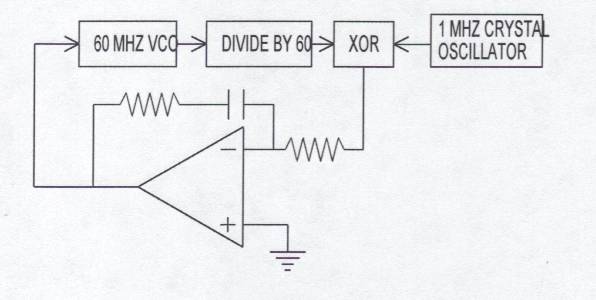

i want to design a vco to produce 60MHZ with a reference crystal.i want to do it using a phase locked loop with frequency dividers until it locks at 60mhz.is it possible to do it all on a bread board and how do i show the output?could you please help me with vco circuit diagrams.my e-mail is manyere_allen@yahoo.co.uk

You don't want to be trying to build RF designs on breadboard, certainly not at 60MHz!. For a VCO you simply add a varactor diode to your 60MHz LC oscillator.
Here is a block diagram of what you need to do to lock the 60 Mhz oscillator to a crystal. Check my website for more PLL info.

thaks a lot for the block diagram.but i still want to know where i get the output from?i have a 10MHZ crystal,how do i use it to force the vco to oscillate at 60MHZ?does it mean that i have to add certain components and how do i show the output from the vco to prove that for sure its producing 60mhz?do i have to use specific components ie,the resistors capacitors?looking forward to your reply.

The output from the VCO is the line with the arrow pointing OUTWARDS, the one that goes to the divider.
As you specify a 10MHz crystal, you would use a divide by 6 divider (rather than divide by 60).

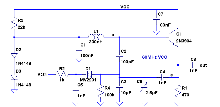

thank you for the formulas.if u go to this website,www.uoguelph.ca/~antoon/gadgets/pll/pll.html theres a topic on phase locked loops tutorial by tony van roon.there is a 'BASIC VCO CIRCUIT' down the page but with no values of capacitance,resistance and inductance,thats what i'm trying to work around that circuit.could you help on how i go about to get the values to make it oscillate around 60mhz.
This circuit simulates well. I didn't build it.

thanx a lot for the circuit.i would want to know which formulas or way you used to get to those values.Input is where the Vctrl control is?maybe a little explanation of the circuit will help me a lot?what is D2 and D3 doing?but i do understand that the tank circuit is R2,C5,D1 and R4.what are the effects of C6,C4 etc
Re: reply to vco design
The current through R3, D2 and D3 forward biases D2 and D3 such that the base is at about 1 volt. The Vbe drop puts the emitter at about 0.4v. R1 provides an emitter current of about 800uA.

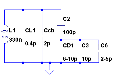

The tank equivalent circuit is shown below. The resonant frequency Fr is
Fr=1/(2*pi*√(L*C))
Where C is the combination of all the capacitors in the schematic below.
Parallel caps add; series caps are calculated as follows:
1/Cseries = 1/C1 + 1/C2 +1/C3 + .... 1/Cn.
C4 is for DC blocking. C1, C5 and C7 are for RF bypassing.
