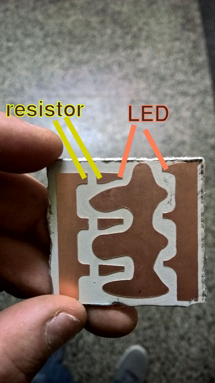

I don't have a picture of them now. But I've found a picture of the first board a created for 3 of those LEDs.
As you see it is pretty simple. The two leads from mains power go to the bottom left and right. The lumpy piece of copper left in the middle has been left out to serve as heat spreader. The bottoms of the LEDs are soldered to it.
Assuming there is not a bridge already inside the LED device, a bridge rectifier alone will not increase the peak voltage at all, and will double the frequency of the LED flashing. The bad news is that the power dissipation in both the LED and the resistor will double from what is on the charts.

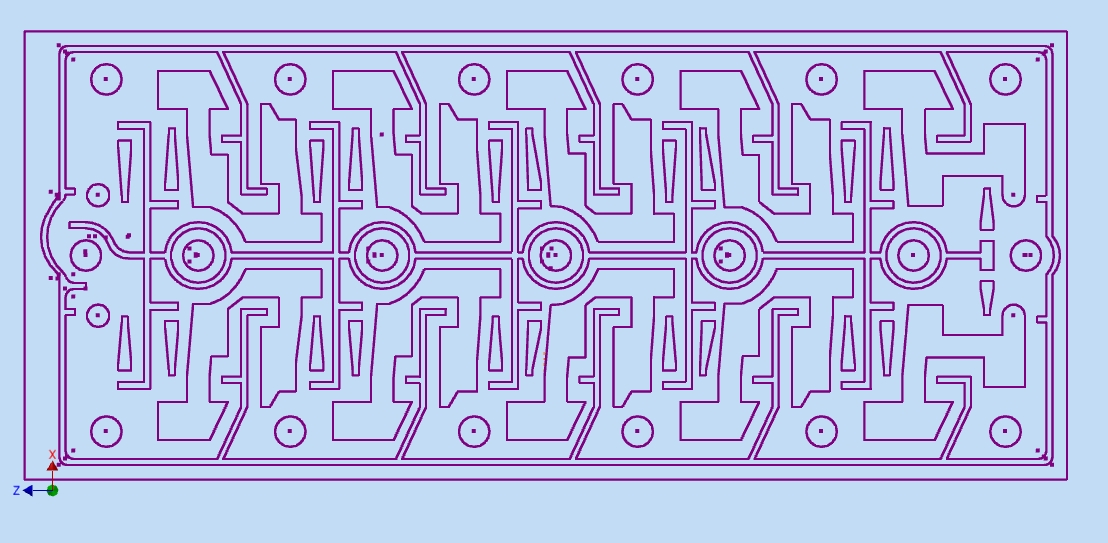

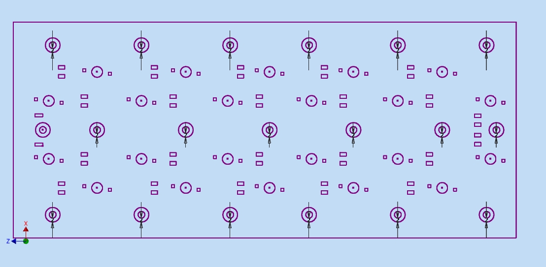

P.S. Here is my design for the PCB with the 24 LEDs. the traecs and the solder mask. The large circles in three rows (top, middle and bottom) are for bolting holes.
The spec's for the LED show its range of brightness with 200VAC as the minimum voltage. Maybe you will be lucky and find better than typical LEDs or buy thousands of them, test all of them and pick out the best ones.

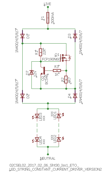

Hi Zeox,
Below is the schematic for a constant current LED driver:
NOTES
(1) The circuit above will drive a constant 24 mA into one single LED unit.
(2) The two LED strings shown on the schematic represent the innards of one of your LED units.
(3) Constant current is a technical term and does not mean that the current will always be present but the circuit will ensure that each LED string in the LED unit will get a constant current and longer during each half cycle of the mains supply.
(4) The circuit will provide a constant current irrespective of the mains voltage variations, within limits of course.
(5) The constant current is defined by the formula, Ik = 0.6V/R2, where Ik is in Amps and R3 is in Ohms.
(6) The NMOSFET will get warm so should be in free cool air. A heatsink is advisable.
(7) The NMOSFET is a high-voltage, low-threshold voltage type- no other type of MOSFET should be used without checking with the designer.
(8) There are safety aspects to the circuit and the fuse must not be omitted.
(9) Q2 can be pretty much any small-signal transistor but the higher the voltage, VCEo, the better. In addition to the ideal transistor (BC546) shown on the schematic, other transistors can be used: BC547/8/9, 2N2222, PN2222, BC337, BC182/3/4, BC107/8/9
(10) If you would like to drive more than one LED unit in parrallel with this circuit we can discuss how that can be done, but ideally one constant current driver for each LED unit would give the best performance.
