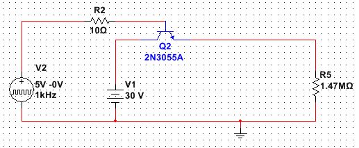

Hi!
I am completely failing to design a simple
circuit for PWM driven transistor to
control the current in a load. The voltage
to the load should be 30V and current
passing through it about 4 A. The load
should be connected to ground.
Something like the attached image perhaps...
Huge thanks for any help!
Is that load really 1.47 megohm? If so why are you driving it with a large power transistor?
Also the transistor in operating as an emitter follower so the load voltage can never be greater than the generator voltage minus about 0.7V.

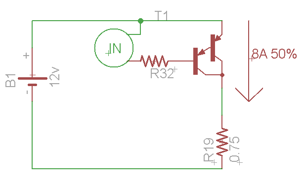

I don't really know what you want to do:
Here is an example of getting 8A at 50% of the time for an average of 4A.
To simplify things I have the PWM "IN" hanging from the +12V supply.
Is this where you want to go?

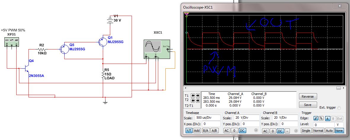

Hello,
huge thanks for the answers. The only way I got the above circuit to work, was to add an extra
transistor 2n3055 to the gate as shown in the image. Is there anyhow to get rid of the falling
time of the output voltage pulse?
Thanks again!
Try a 10k pull-up resistor between Q5 base and the 30V rail. You may also need a similar pull-up for Q1 base.

Then in post #4 you ask about switching times(fall time) and alec t is suggesting a pullup resistor. He has identified the main problem with your circuit and that is that there is no means for the base circuit charges to be removed QUICKLY from the base/emitter region.

When one designs a switching transistor circuit it is imperative that the manufacturers recommendations are followed. The data sheet shows that the cutoff base current is the same value as the forward base current, and is one tenth of the collector current. Ic = 4 amp; Ib=-Ibm=400 mAmp. To achieve this requires a base current bias voltage of -2.8 volt applied through the 11.1 ohm resistor. This is the TEST CIRCUIT but it is the way that thte switching performance is determined. Also, this is for a resistive load.
the data sheets I got from the net showed some data for switching inductive loads. The parameter is called 'Sustaining Voltage'. You dont say if your load is inductive or resistive.
In a practical design, you would attend to the base drive by means of DC bias of the driver, or you might use a parallel CR circuit in the base drive to give the ability to suck out the charge carriers from the base region and put that charge into the capacitor in parallel with the series base resistor. The design of the drive arrangement for a TV line output stage might be helpful for your understanding.
