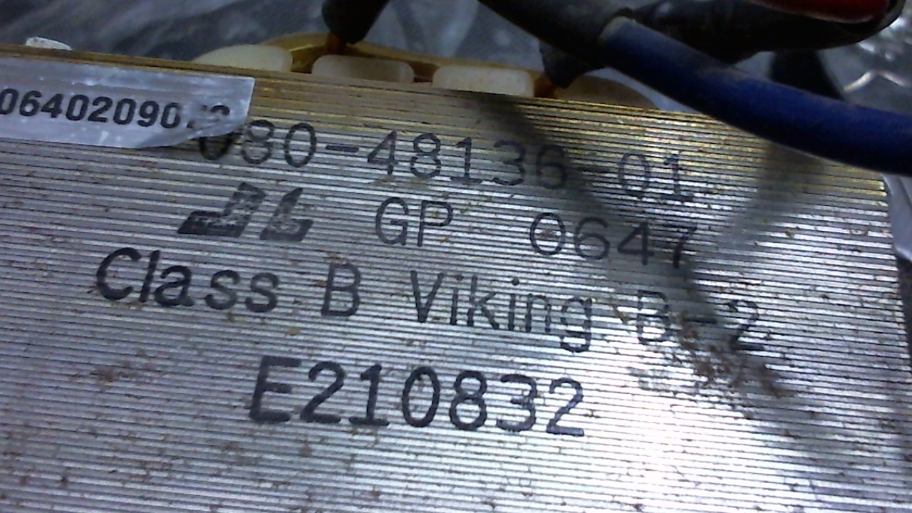

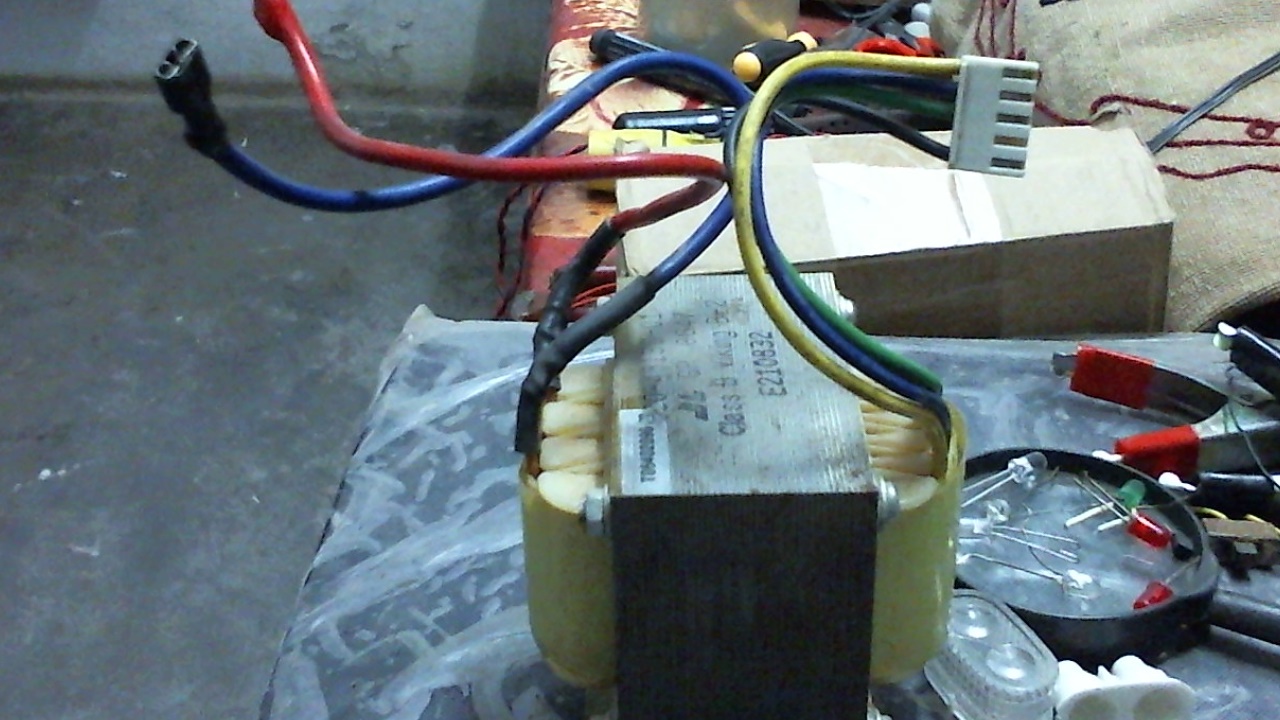

I got this transformer from an old ups, there are four wires on the primary side black, blue, green , yellow and two on the secondary red and blue. This transformer used to charge 12v 7.5ah battery also converts it back to 220V in backup mode.

Images of the transformer below.
Rather than play a guessing game with voltages I would start by taking resistance readings and see what goes with what. Also, many UPS transformers use multiple tap transformers so they can be used globally (120V & 240V systems). Many UPS units, depending on size and ratings use not one but a pair of 12V 7AH batteries in series, so they run on 24 VDC and not 12 VDC. The charging circuits start with 12V-0V-12V. Anyway, I would start using an ohm meter and see what goes with what, also if possible note the wire gauges where the leads exit the transformer windings.

I did what you asked me
primary side
Wrt black,
blue->9 ohm
yellow->9 ohm
green->10 ohm
green blue 2 ohms
green yellow 1 ohm
yellow blue 1 ohms
secondary side
blue and red 0.6 ohm
primary side wires are 18 awg and secondary are of 12 awg.

As to the primary secondary I will venture a guess the heavy wires are the primary. The primary in a UPS is driven by an oscillator with either 12 or 24 volts. Generally a pair of large MOSFETS or power transistors depending on the units power rating and generally with the transformer center tap being used. The transformer serves as a step up transformer with the secondary (the smaller gauge wires) being the output of 240 VAC (or in the US 120 VAC). This is all a generalization as I don't know exactly what you have. Anyway, we need to understand how the UPS works to understand what the transformer does and how it is configured. When mains power fails an oscillator comes online driving the transformer with 12 or 24 volts, the battery or batteries drive the oscillator which drives the transformer which provides a mains output voltage in the absence of mains power. The output is generally what is called a modified sine wave or square wave. Some higher cost UPS units do output a true sine wave.
