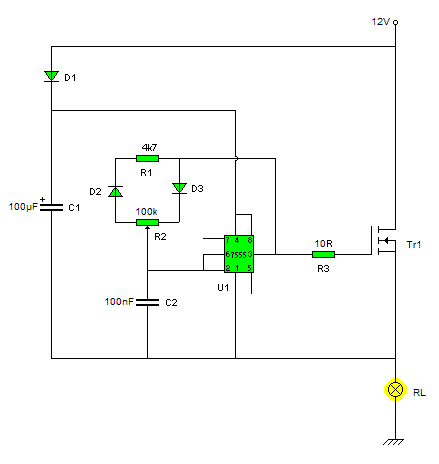

Help. I can't get my potentiometer to work with my motor

The motor runs when hooked up to the breadboard, but nothing happens when I mess up with pot'. Most likely due to the motor, however. By the way, are the wires going to the right terminals on the pot'?

The circuit needs a higher voltage than 3V, 4V minimum because of the MOSFET's threashold, even then you're pushing it and limiting it to low current loads.
What did you use for Tr1? It needs to be a logic level MOSFET, the IRL540 should do.

The voltage won't be a problem here, going by the picture, you've used a 9V battery anyway so it should work.
That should never happen.
Check the connections, from the picture, it looks like the there could be a short circuit somewhere, pay attention to Tr1; is it connected with the drain and source reversed?
Tr1 could be damaged.
That won't make any difference.

An IRF510 has a high on resistance and required quite a high gate voltage (5V to 10V depending on the current required) to pass a reasonable amount of current. You need a logic level MOSFET unless you're planning to power it from a 12v battery.
There is something wrong with the transistor or you haven't connected it up correctly otherwise the motor won't remain at the same speed regardless of the pot's setting. If the input voltage is too low, the motor won't work at full speed but the pot. should still work.
Most people would measure the resistance of the motor to calculate how much max current it needs.
Most people would use a mosfet that turns on properly with the low gate voltage in your circuit.
Yes! I got the pot' to change the speed of the motor with circuit #2! Although the same issue still occurs where turning the pot' all the way down leaves it still running and turning it up does nothing until the last 20%. What could be wrong? I followed the diagram exactly.

On a side side note: I don't even care what the max speed of the motor is. I don't need it to go fast at all. I only care that
1. The motor stops stops completely when the pot' is turned all the way down.
2. The pot' gives me a full even range, where the speed increases slowly throughout the entire turn, not just the last 20%.
