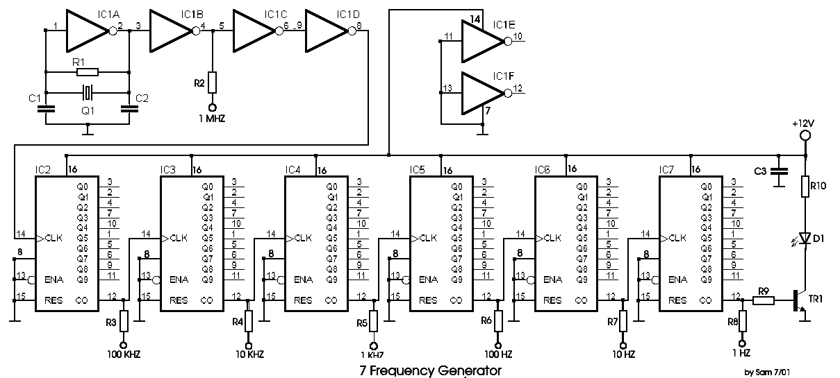

I found the attached schematic on the web.the circuit
produces square wave pulses by means of a 1MHZ crystal oscillator
based on 4584(IC1), and then successively divides the frequency by
10 by means of 4017(IC2~8), and obtains 100k,10k,1k,100,10,1Hz square pulses.
I had tried to use this circuit for my purpose, but the problem was
that the maximum input frequency for 4584 is about 2 MHZ.
because 74HC4017 supports high frequencies( >50MHZ ),can I replace
4584 based crystal oscillator with a single 33MHZ oscillator and
then feed the oscillator signal to 4017 to obtain square wave
pulses whith frequcies like 33/2, 33/3,...33/10 MHZ ?

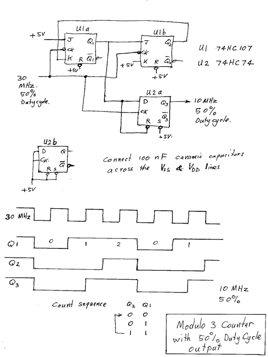

You wrote that you want the output to provide a 50% duty cycle.
The 74HC4107 will only provide a 50% ds for divide by 2.
Here is a divide by 3 counter with a 50% duty cycle output.
You can use a D type Flip Flop to divide by 2. Connect Qbar to D.
Or you can use a JK flip flop - connect the J & K inputs to +5V.
The set and reset inputs must be connected to +5V.

some other questions
Hi dear ljox
thank you very much for your reply and schematic.
but you dont said me that if I can use a DIP 33MHZ oscillator(instead of a crystal based
RC osillator+ 4584) and a 4017 to obtain the desired frequencies or not?
The other question is that what can I do for 1/4, 1/6, 1/8 outputs.How can I turn back
the duty cycle of them to the 50% level?

The 74HC4017 is the wrong IC for your purpose.
You can obtain a 50% ds with the 74HC390 that I mentioned.
For the modulo 3 & 6 cases, you can use the modulo 3 counter I posted in my previous post.
