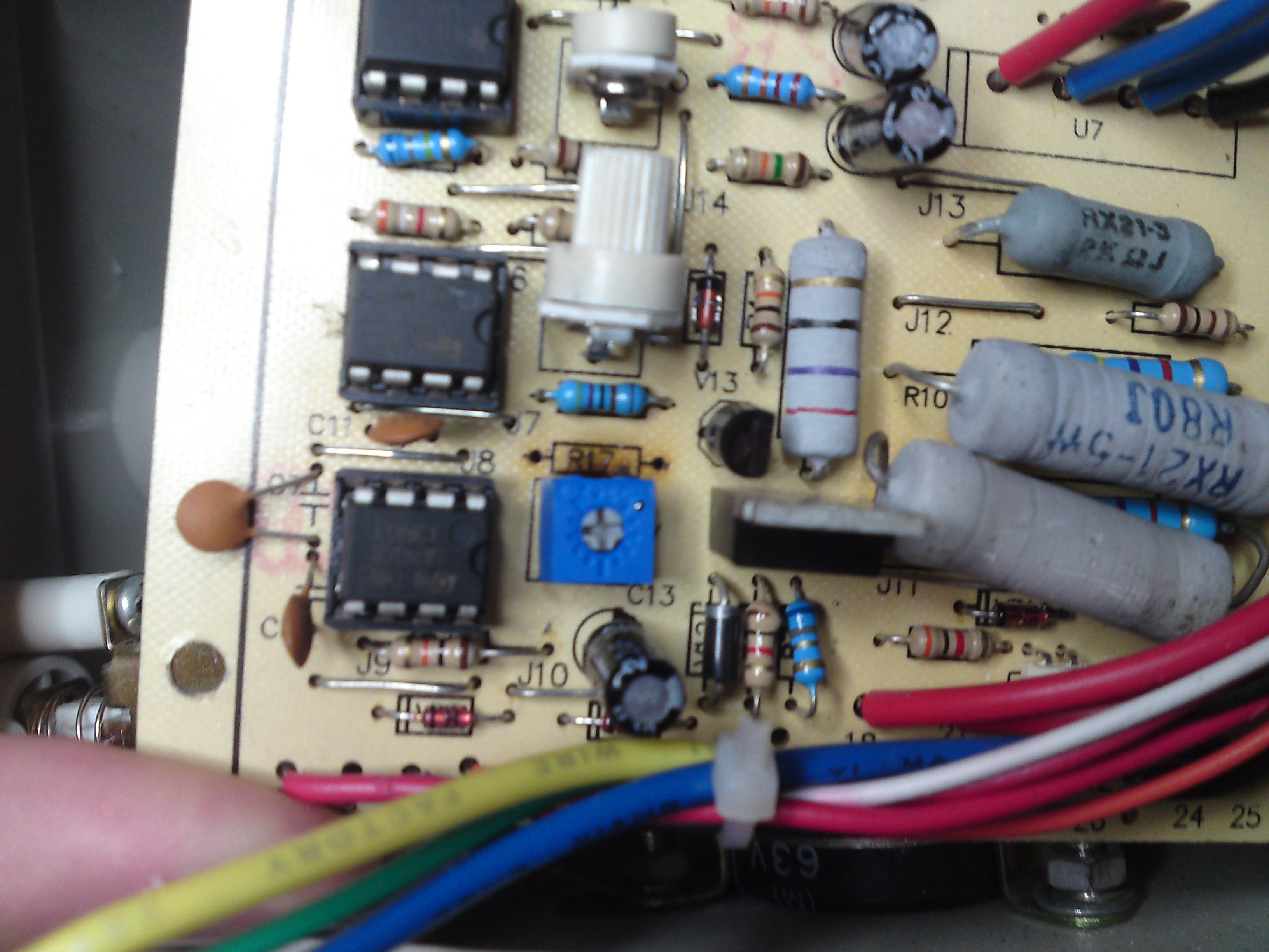

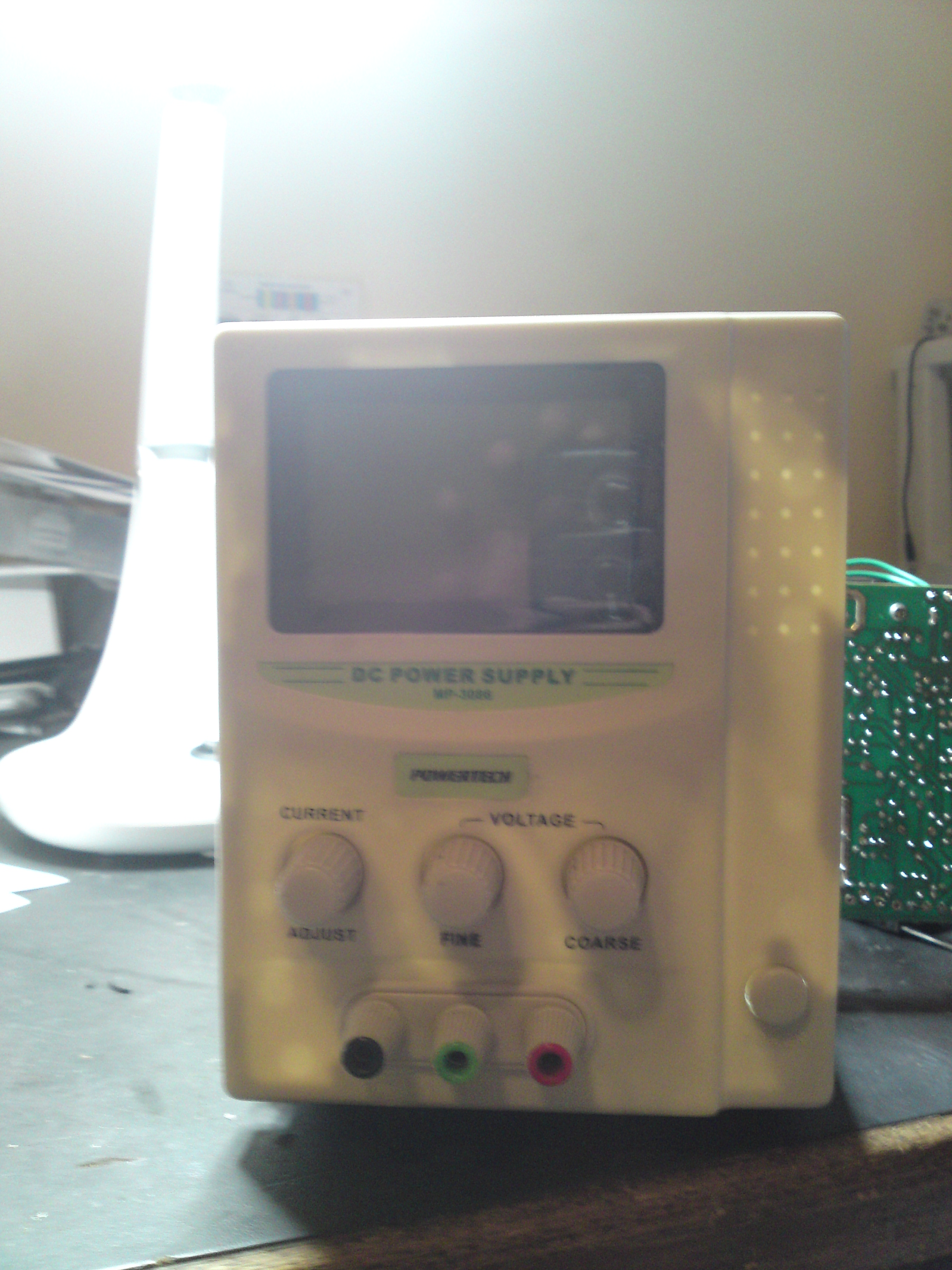

Recently blow up my MP-3086 benchtop powersupply i bought from jaycar, due to back emf from a tesla coil.
It normally has a max output of 31v 3amp, but now it stays at like 50v but no current flow. (2n3055 transistor has been replaced and same goes with shunt regulator aswell as lm358 ic and UA741CN ic)
would anyone have a schematic diagram for board model number AQD7.820.501
or even if you have this powersupply could you state the resistor value for r17(show in picture above blue pot), or even take a photo of your board and share it.
Thank-you
Jordan

my symptoms are, when i place a meter across the terminals for voltage i get nothing. if i set the current to 150ma, and connect a 12v 100ma incandescent bulb while turning up the V dial, i get nothing, and the display reads 0v.
before that point, when i was connecting it to try and charge some battery, i got a dead short with the battery, and sparks going everywhere. thats why i want to know what the resistance across the terminals is supposed to be when off. could you do me a favor and measure your resistance there? even if its in a busted state? i have a feeling a dead short is not supposed to be there.

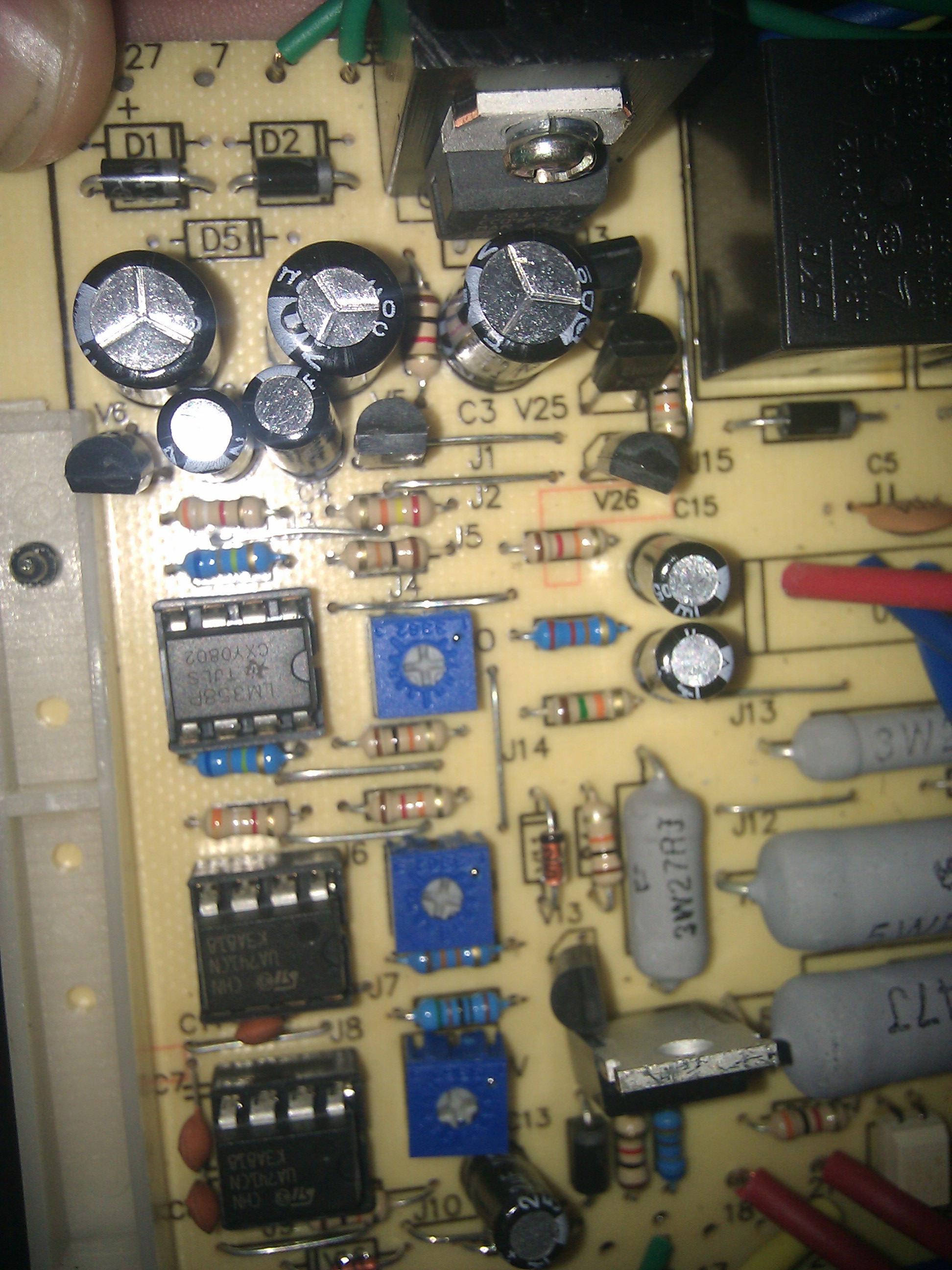

i identified 1 cracked 1n5408 diode last night. gonna go replace that today cos i only have 1n5404's. its was shorted both polarities.
i replaced the diode, and there was no short anymore connecting the meter leads to the terminals in either way. good news.
i used my dca55 to test the 2n3055 transistor at the back, and it said it was ok.
i fired up the power supply, and it worked. powered a 12v bulb fine for a few minutes. then i switched over to charging a 12v battery @ 13V, current limited to 700ma (the c20 rate of the battery).
all looked fine and dandy for a few minutes when suddenly white light and a burning sound came out of the side of the power supply. christ, thats never happenned before. switched it off and pulled it open again.

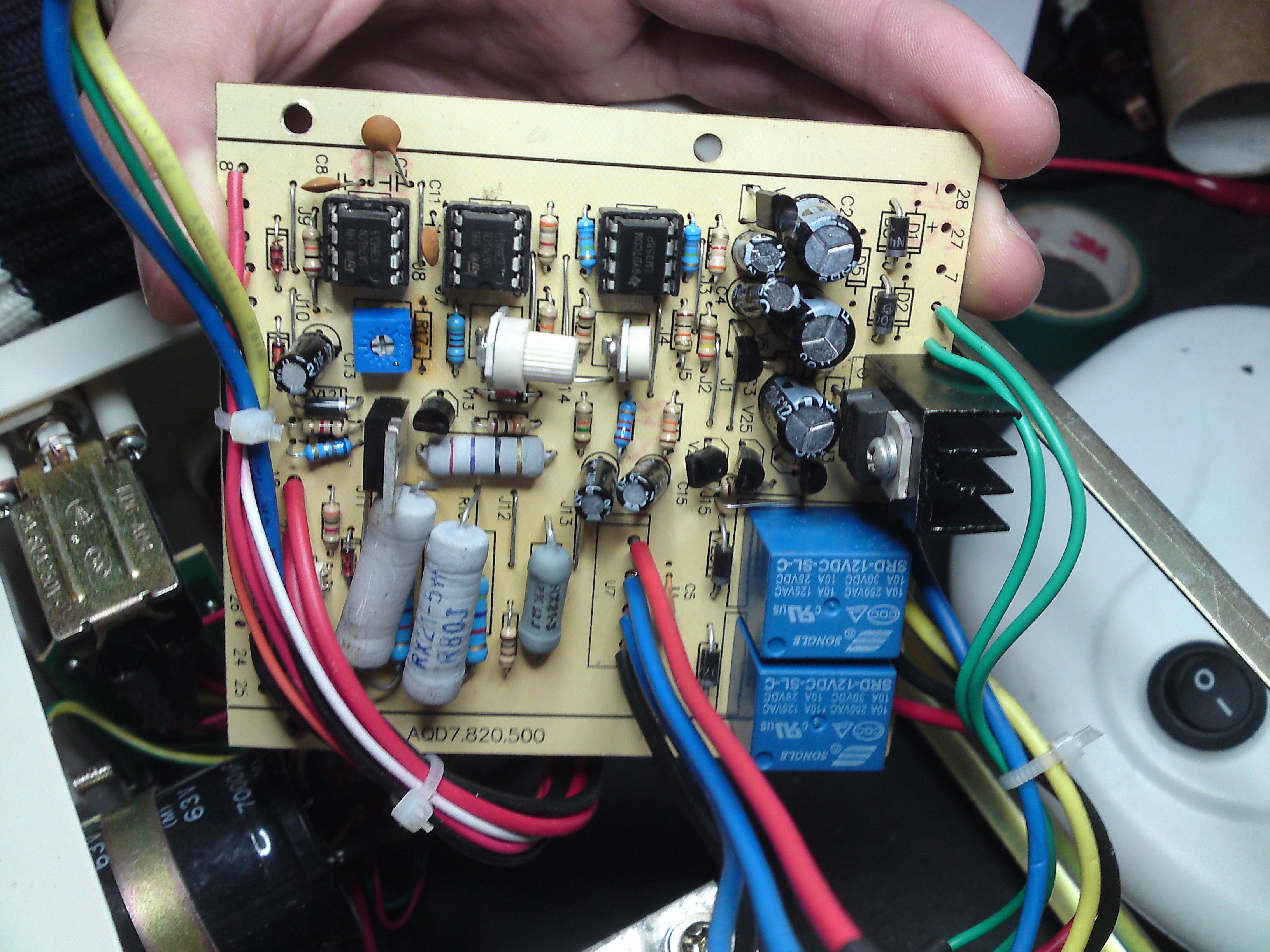

There appears to be a small cap blown on the circuit board. it is connected across the two ac rails that come from the transformer, then through 2 relays, then into the bridge rectifier. the cap is across the input to the bridge recifier. I have no idea why. because normally any signal smoothing is done with a cap on the output of the bridge rectifier. and its a tiny cap, so i dont know how it would fullfill that purpose even though its in parallel with the transformer, so it might be a resonant/filter of sorts. i know nothing about those guys.
is anyone able to chime in here on anything else i should look at? what might be a problem?
its strikes me as odd because before i identified a cracked diode on the dc output. but this cap has burst into flames on the ac input to the bridge rectifier, probably already stepped down from 240v to something like 36v. I don't understand the connection between these two events.
unless some how the shorted dead diode damaged the cap before. im stabbing in the dark.
in any case, i dont think replacing the cap is going to solve the cause. i fear its just a symptom.
@spitso: do you think you could tell me the value of the cap im talking about? it is c5 on the board. mine has been rendered unidentifiable.

checked c5 for you and its a 104 ceramic cap, which i believe is a value of 100nanofarads.

I measured the ac voltage before the bridge rectifier when it was on, and with the voltage set to max on the front panel it reads about 42VAC, which is below the 50V rating of the cap i put in there. must have been some sort of spike or a dodgy cap that caused it to fry. thanks for telling me the value of that guy spitso, wouldn't have been able to do it without you.

Just a quick question queglay, the 3 wires going to the 2n3055 tranistor (thin green, thick yellow, thick blue). What wires go to what transistor lead?
(i left the transistor unsoldered and now ive forgotten)
My guess is green to base, blue to emitter and yellow to collector?
