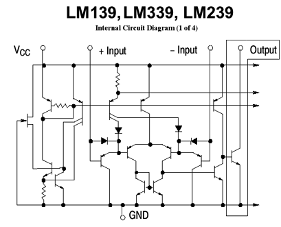

Generally, when a comparator "fires", that is, senses a voltage which is at (or above) the switching threshold voltage, the output goes low. Note in the diagram for the LM139,239,339 that Sebi suggested, that the output is open-collector. A pull-up resistor (or load) is required for it to operate. JB
I have the lm339
Th problem I was coming up with was the fact that I'm applying 16 V to this comparator and when I connect pullup resistor to this supply, I'm getting the ~16V output. I can't connect this to a mosfet transistor unless I make a voltage divider. I really just wanted to take the output of the comparator and hook it into the transistor and be done and avoid the divider, but I guess alittle more work won't hurt me.

ThE_sPaCeCoWbOy said:
... but I guess alittle more work won't hurt me.
Hey space, it won't hurt any of us. :lol: Anyway, what were you looking for in terms of output voltage? You could use the pullup resistor as part of the voltage divider. For instance, if you wanted 4 volts out, use a 3Kohm pullup and add a 1Kohm to ground from the output. Just use the voltage divider formula to get whatever output voltage you want: (ground resistor / (ground resistor + pullup)) X voltage. When the comparator "fires", voltage at the output is reduced to ~0v by the output transistor turning on. JB
I just wanted to beable to hook up the output of the comparator to a mosfet transistor to turn it on....maybe 2 V instead of 250mV that the lm 139 put out to turn the transistor on and I was hoping to find a comparator that put an output of that. but it didn't happen. I got it working with what I have and used a voltage divider. and it worked fine.

There's no need to take the pullup resistor to the same HT supply as the comparator, that's one big advantage of an open collector design. Simply feed the pullup resistor from a more suitable supply for your purpose.
A conventional output would be far worse for you, it would simply switch to the positive HT rail, giving a fairly high current output.
