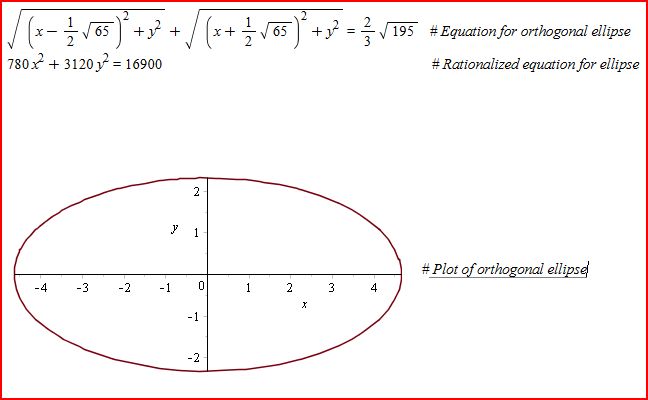

1. Foci (5,-3) and (-3,-2) and major axix is equal to twice to the minor axis?
I can contruct the ellipse from the above information. The ellipse is rotated 7.13° clockwise, so it will have a xy term. The solution you were given does not have that term. Therefore, that solution is wrong. Before I show you the solution, I will let you work on it some more.

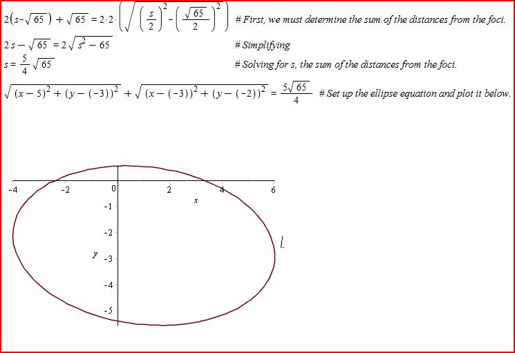

rcmel,
As you must know by now, an ellipse is the locus of points whose sum of distances from each focus point is a constant. The first thing you must do is calculate this constant, call it "s". Since we know the major axis is twice the minor axis, we can set up and solve for s in the following equation.
2(s-√65)+√65 =2*2(√((s/2)^2-(√65/2)^2)) ===>2*s-√65=2√(s^2-65)===>s=(5√65)/4
Now that you know what "s" is, you should be able to set up an equation for this particular ellipse.
Ratch

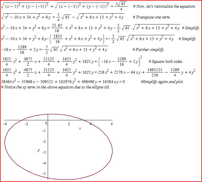

To the Ineffable All,
Seems like that are a lot of hits on this thread, so I will continue the problem. See the first attachment for setting up the ellipse equation and the second attachment for rationalizing it.
Ratch

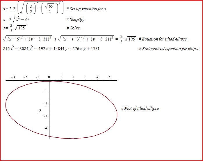

Hello there,
I havent gone over this thread in detial but I just wanted to mention that quite often the next step is to rotate the ellipse into standard position. Ratchit if you'd like to show that too that could help somewhat. The ellipse is rotated by the appropriate angle and offset by the appropriate x and y offset values.
MrAl,
It looks like a made a mistake in calculating "s". The correct value is (2/3)*√195. The attachments show the equations and the plots.
Ratch
