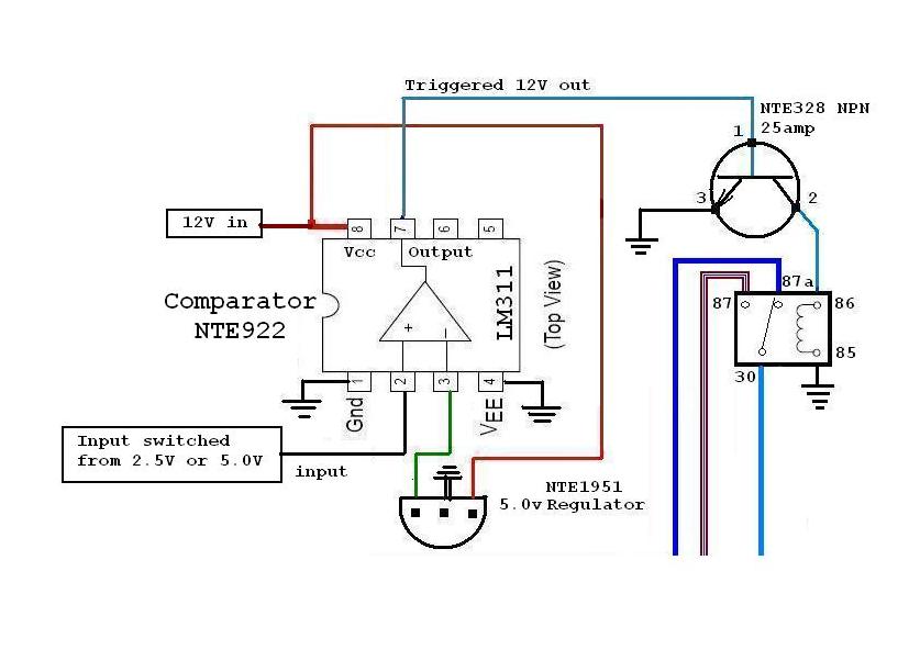

I need some help confirming this diagram I have made. What this circuit does:
There is a switching output from an automotive ECU to the Fuel Pump ECU. It is either 2.5V or it is 5.0V. Basically a trigger to change the fuel pump voltage between 9V and 12V. I am sending this signal to a Comparator as the trigger, and I am using a 5.0V regualtor for the referance voltage. Once the ECU kicks the voltage to 5.0V the Comparator will trigger and send out the 12V signal to the NPN transistor. This NPN Amp is rated at 25 Amps, so there s/b sufficient current to trigger the relay.
Where I am not sure, is if I need to add a diode, a resistor, or a capacitor anywhere. And if I even have this diagram drawn fairly accurately.
The purpose to this is to switch over to a voltage enhancer to increase the speed of the fuel pump motor increasing its output.
TIA
Stu

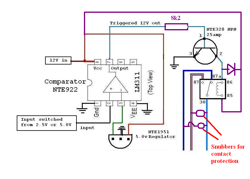

the modded schematic is appended. it is self explanatory, perhaps.
Base resistor (added now)value to be calculated, as tentative value shown there.
the relay has to see a voltage at pin 86(coils) and diode added to protect the transistor.
Snubbers (may be R-C or MOV) need to be designed to meet the need

In addition to Sarma's idea.
The 8K2 in the base of the power transistor will only give a base current of 1.4mA.
The gain of the transistor at Ic=500mA is 50, so the collector current will be about 50 *1.4 mA = 70mA.
Whats the resistance of the relay coil.?
I would use a pull-up resistor at the base of the transistor, maybe 1K-3.3KO. The LM311 is open-collector and will need proper biasing that a series resistor will not give. The series resistor is not required. Also go with a voltage divider instead of the 5V regulator as the reference. Since your trigger voltage is 5V as well, this may or may not be higher than the 5V reg. Use a resistor combo that will give you about 3.3V at the reference of the comparator. Use say a 4.7KO to the 12V rail in series with a 1.8KO to ground. This will give you about 3.3V for your reference.
Question: Do you want the 5V to trigger the relay, or the 2.5V?
If you want the relay to trip with 5V input, than you will have to switch the inputs of the comparator and use the non-inverting side as the input. Let us know how things work out.
Important: It is a good idea to use a flyback diode across the coil of your relay to protect your transistor and other components, like what has been suggested.

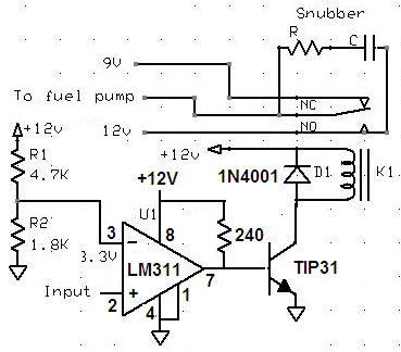

View this schematic. It should work with what you need.
A snubber is usually an RC circuit used to suppress the rise of voltage or current to protect contacts of a relay from welding. Of course this depends on what load you are driving as well. They are also used with solid-state devices to protect them as well.
One thing I forgot to note on the schematic is the values of the R and C for the snubber. You can try a 1KO, 1W and .22uF cap.

An LM311 is a normal power single comparator that has over 8 times the output current of a comparator in a low power LM339 or LM393.
It drives a TIP31 which is a medium power power transistor.
You didn't say how much current your relay coil uses but this circuit should provide plenty of current and there are no extra comparators to disable.

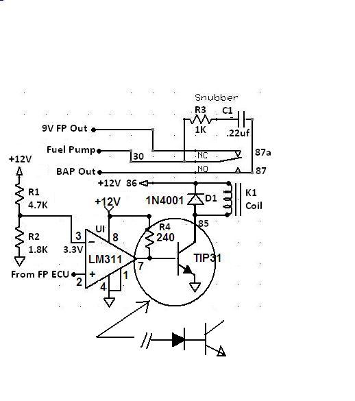

rezer...I have done some modifications to the circuit you drew. I added the NPN as recommended. Not specifically yours mentioned below.
2 questions, is the flyback resistor R4 in my drawing? It is now at 240 ohm, is that the one you recommend 2K ohm?
"The "diode" in series with the base".......did I draw it correctly here? If so, what is a recommended value for that? Same as the other one in paralell with the coil?
Otherwise, I think I have added everything as you said, and as given. Looks like I am ready to etch a board here if this new design works.
Stu

Yes, R4 is the resistor I was referring to as 2KO. Again, yes, the diode is drawn correctly. You want to connect R4 to the anode side of the diode. A 1N914 (1N4148) diode will work. Use what is marked on your schematic for the flyback diode across the coil of the relay, 1N4001.
I am assuming by your statement "...if this new design works." to mean that you will test it out on a breadboard first.:)

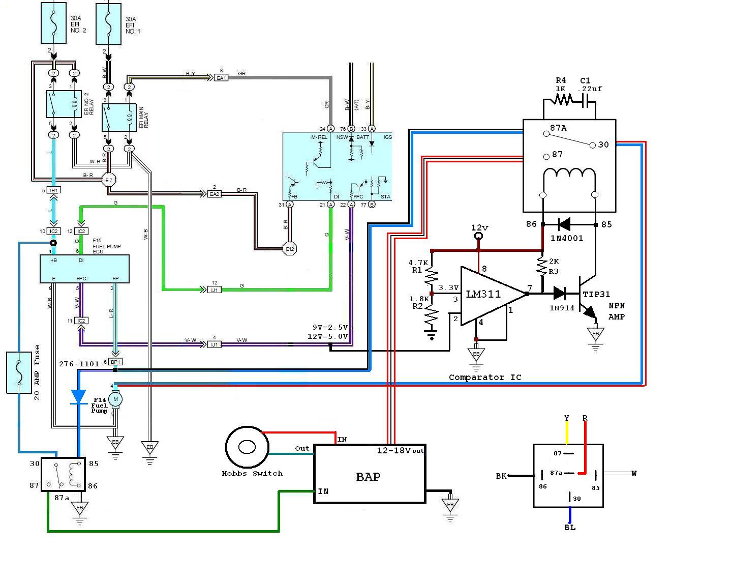

If anyone of you are interested, this is how I drew it up for my final breadboarding. How it works, is during cruising, and under a certain RPM, the onboard ECU sends a 2.5V signal to the fuel pump ECU. That in turn then outputs a 9V power supply to the FP. As you can see, through the SPDT relay, the car is operating in this matter. You will also see a SPST relay on the left that is always supplying the fuel pump enhancer a 12V input. (armed)
When the car goes into higher RPM range (4K), the ECU sends a 5.0v signal to the FP ECU, and that in turn bumps the voltage up to 12V. Now the 3rd function is the pump enhancer. This is not quite activated as yet, but it is fully "armed". So when the Hobbs switch is activated (5.5K rpms), the enhancer (BAP) jumps the voltage to the fuel pump to 18V.....Increasing the fuel flow by quite a bit. The comparator is set to see this voltage change, and sends the signal to the coil to activate the relay and switch power to the BAP enhancer.
My concern about this whole set up was not having the enhancer unit kick from either (9v or even 12v) all the way to 18V in one switch. I wanted to do it in "steps"
Lets hope it works~!...Thanks to everyone, and I will report back after testing.
