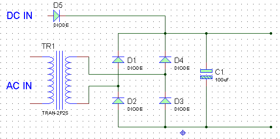

You should just feed in the DC after the units rectifier with another diode. I think that is what Styx meant in his post. When the rectified AC is present then it will block the DC, but with no AC the DC will be there. Just make sure the DC in is at a lower level (< by 0.7V) as the DC after the rectifier to block incoming DC with the AC present. The -ve of the DC will connect to the line at the bottom.
Thanks for your help dude! But as i mention, the AC & DC are using the Same power line(2 wire only, power & GND). I am not invlove in the battery & AC side. All they gave me is just 2 Wires and state that it suppose to give 230VAC during normal usuage to pump the AC application. Once there is any power failure, their circuit will pump in the battery power(12VDC) using the same 2 wire. My job is to track whether if the 2 wire pass to my side is AC 230V or DC 12V and switch to the necessary application. The problem i face is when the power 230VAC is back, my relay is not fast enough to switch to the ac application and cause kill my DC application.

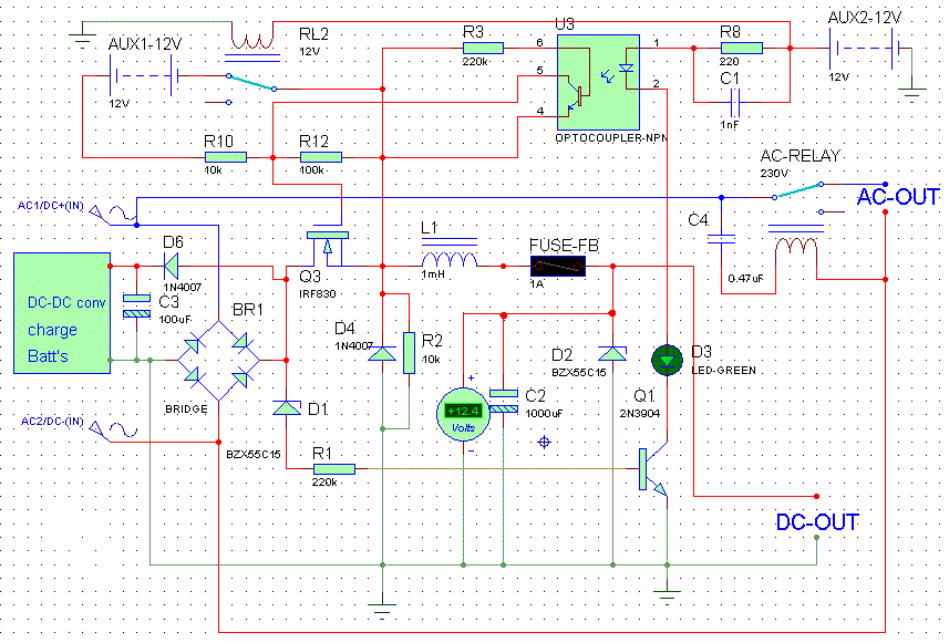

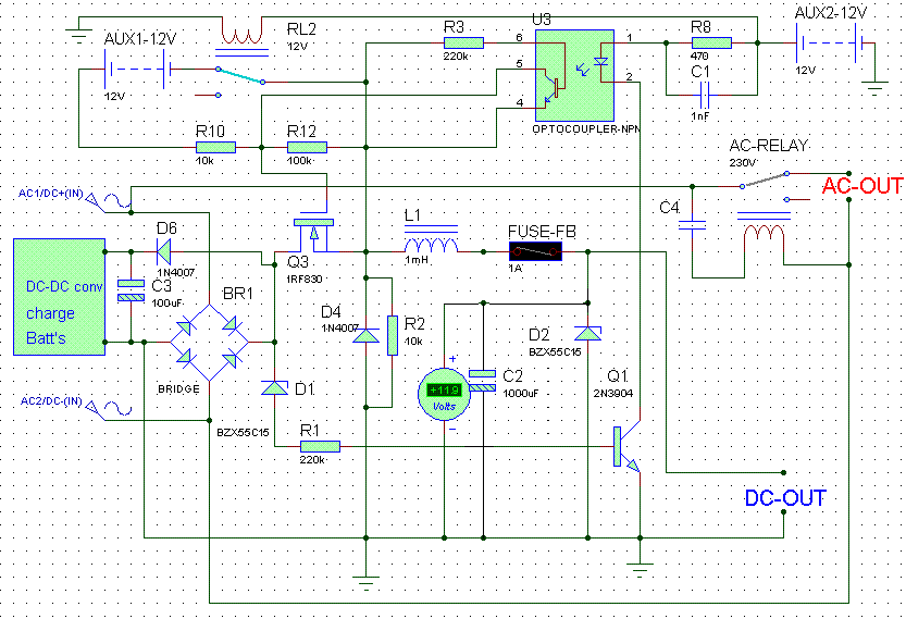

Here is a circuit I had in mind.
Looks complicated, but operation is simple.
With mains present AC Relay will operate through DC blocking cap C4 (you get relays that operate on AC or DC, then C4 may be left out). This will be selected based on the relay current. I have not picked a value for C4 as I have no sim model for a AC operated relay and this part of the circuit is very basic. This will pass the AC supply to the application. Q3 will conduct from just above zero volts until the rectified voltage on the output of BR1 reaches about 15V. At this point opto U3 is switched on quickly (within 10uS) by Q1 which in turn switches off Q3. There will be a short conduction period by Q3 at the start and end of every 1/2 cycle. So the voltage at DC-OUT never goes higher than about 12V taken into account L1 (is in series because of a very thin voltage spike present when Q3 turns off, and D4 clamps the -ve going spike) and the time to charge C2. When mains is removed and 12VDC put on the line, the voltage will be too low to switch on Q1 and hence Q3 will never turn off. This 12V DC will now be passed on to DC-OUT. When mains is switched on the line again, the circuit will switch back without any problems to the DC equipment.
A small DC to DC converter is used to provide two floating DC supplies to keep the two auxiliary batteries charged. RL2 is a lockout mechanism incase for some or other reason the batteries go low on voltage. The only problem is with AUX2. If this goes low there will be no voltage to fire the led to turn off Q3 as previously explained. So if this happens RL2 will drop out (around 8V upto which should be still enough to operate the led), removing the supply to switch on Q3. AUX2 could also be trickled from the DC-OUT by connecting the two, but for charging you need a few volts more or maybe use a 6V battery and modify the led resistor and relay value.
A fast blow fuse is used in series of the 12V supply just incase of any unforeseen component failure around Q3. The zener diode D2 will go short and blow the fuse. This 15V zener could also be replaced by a transzorb, which may be a better choice.
So basically we have a system that will electronically switch over between AC or DC on the line. Design seem to be functional (although I have not tested it in real life) and checked out on the simulator without any obvious errors. Like any design tweaking of some values might be needed to work with different components. We could also adjust the led resistor and then insert a green led in series with Q1's collector to come on when AC is present. Last picture shows this simulation running with option on to show voltages.
There may well be a simpler way to do it when given more time to think about it.
This circuit sure looks complicated to me as my knowledge to electronic is limited. Thanks for the effort you contribute, i will try to figure it out and try it. Thanks.
One more thing, what is the use of the optocoupler? I dun really know how an optocoupler works.

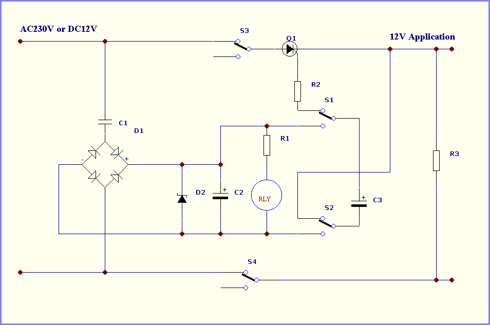

Here is how the circuit works. S1, S2, S3 and S4 are contacts of the relay RLY.
(1) When AC230V is present, DC is produced by C1, Diode bridge, zener D2 and C2. After C2 charges up, relay RLY operates. Operation of relay contacts S1,S2 parallel C3 to C2 and so C3 is also charges up to the zener voltage. The 12V application is isolated from the AC230V supply by relay contacts S3 and S4. This condition exists when AC230V is presented.
(2) When AC230V is lost, because of the charge on C2 & C3, relay does not drop out immediately. After sometime, relay drop out and the 12V application is connected to the Ac230V cable. Assuming the 12V is already there at the 230V cable, SCR Q1 will be triggered by charge on C3 and SCR will remain ON because of R3 supplying holding current. After C3 discharged, the triggering signal is gone.
(3) When "whoever" (and not under your control) decides to switch the 12V to AC230V, first he *must* disconnect 12V and then switch over to 230V. He/she cannot apply 230V to a 12V line. So when the 12V is removed, Q1 SCR turn OFF because the current gone. The SCR is what protect the 12V application from the incoming AC230V before the relay operates again to isolate the 12V application.

Thanks for your help dude, but they won't be a person doing a manual switching when the power is cutoff. I dun think they will approve for this idea. Anyway i just thought of an idea. I am going to use a large inductance inductor to protect my DC application. This way, even AC is passing through the DC application, it wun kill the DC application since the inductance will limit it to low AC current and at the same time allows normal DC operation. I just need a short time to protect the DC application for the relay to switch back to AC application. Just like to get some comments if the idea of using a inductor to protect the DC application is sutiable a not. Any comments are welcome.
