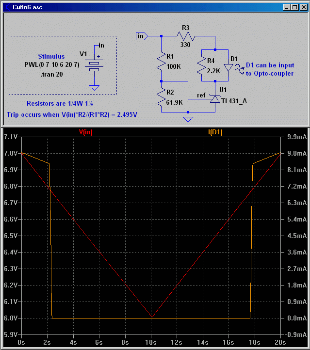

TL431 is a very inexpensive, simple, precision voltage level detector capable of lighting a LED or pulling in a relay. You could have one per 6V battery, and offset three of the detectors using opto-isolation...
I will post a circuit when I get to another computer later today...
as promised:
This version has no hysteresis. Not hard to add if needed. This one turns off the LED when voltage drops (kinder to battery). It is simple to reverse the logic if needed.
Hi MikeMI,
thankyou so much for your reply.. I cannot believe you came up with this so quickly...
so this circuit will make a light turn on at a Set voltage? almost like a voltage switch? (can be used as a Low Voltage DIsconnect?) which I wouldn't mind making!!!
anyways, if that is so that might not be so ideal since my batteries (solar use, which discharge daily) will activate that light with a typical discharge?

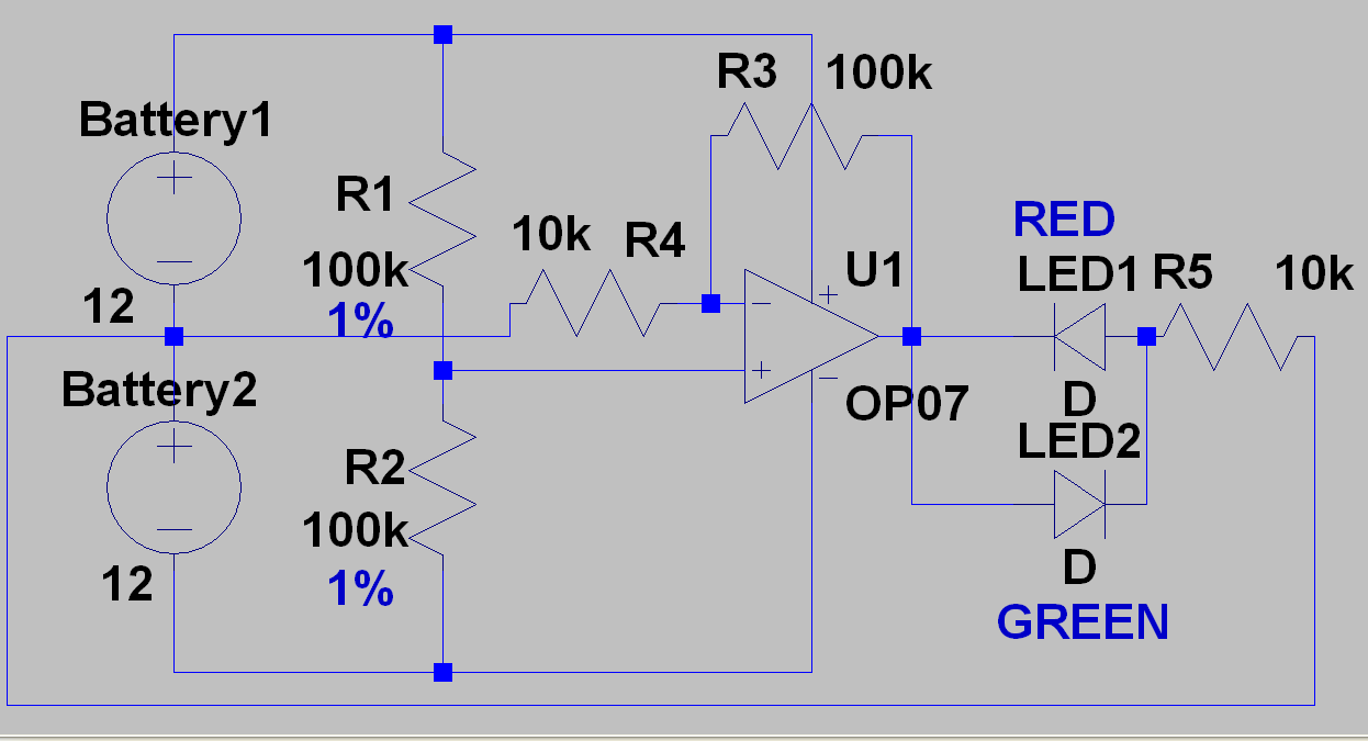

I need to detect the voltage difference of 2 batteries say if there is a difference of more than 0.05-0.1v to activate the Light/Relay

Here is a way to test if the batteries are balanced. (same voltage)
R1, R2 are good 1% or better resistors used to make a 1/2 voltage point.
Battery1 and Battery2 have a center point that should also be at 1/2 voltage.
The opamp (almost any type) has a gain of 10 (or 100 by R4=1k).
The output of the opamp should at at 1/2 voltage if the two batteries are the same voltage.
If there is an error it is amplified by 10 or 100.
The red and green LEDs will be off if the batteries are balanced.
LEDs turn on at 1.5 volts. With a gain of 10 the LEDs will just turn on with a imbalance of 0.15V.
LEDs turn on at 1.5 volts. With a gain of 100 the LEDs will just turn on with a imbalance of 0.015V.
Wow, this is looking very good and perhaps exactly what I require.
your explanation is very appreciated
Can I assume the Red LED will turn on for Battery 1 and Green LED will be Battery 2
as you said no LED means battery is balanced.
if this is so, would it be difficult to configure the LED into a relay?
I have heard of opto-relay (Can use the LED to trigger a relay.. might be simplest way)
or should I use a transistor with an output leg to power a relay?

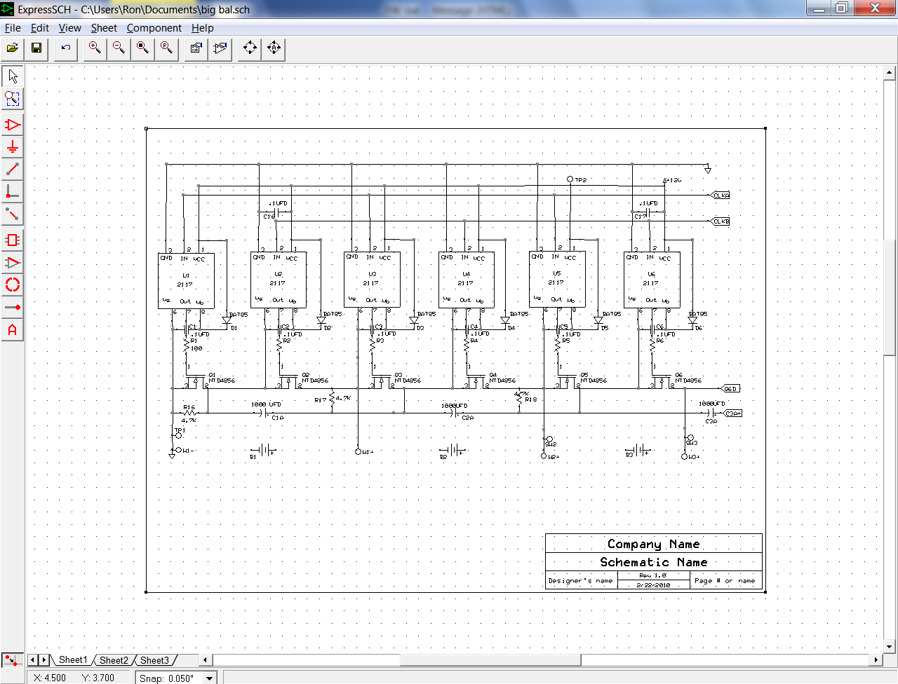

I think this is along the line of what Ron is talking about. It is a switched capacitor balancer. I used one like it on my golf cart.
I didn't include the clock circuit but can if you want to build one. You only need enough for 2 batteries so you can cut the schematic off there.
Basically it just charges a large capacitor from one battery and discharges it into the one with lower voltage. Runs during charge and discharge.

Hi RonV,
Interesting. What I did is using an inductor in place of a capacitor. I can see placing a cap across one battery for mS then moving it to the other battery for mS. That is very much like connecting one end of an inductor to the 12V point. Then connecting the other end to 24V for uS and then to 0V for uS.
I see the capacitor version does not need an error amp.
The inductor version, if run at 50% duty cycle, could probably work with out an error amp. I used current limit and error amp because......
An inductor. Why not. I would have never thought about it. Yes, It might not be pretty if the clock stopped and there was no current limit.
