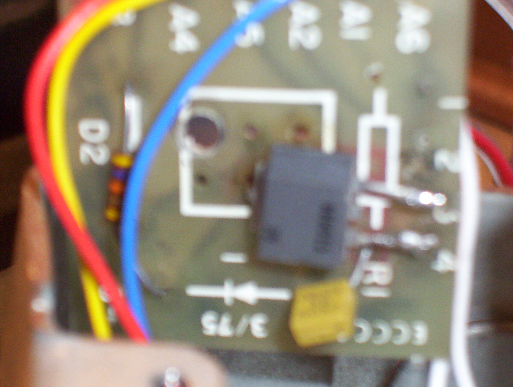

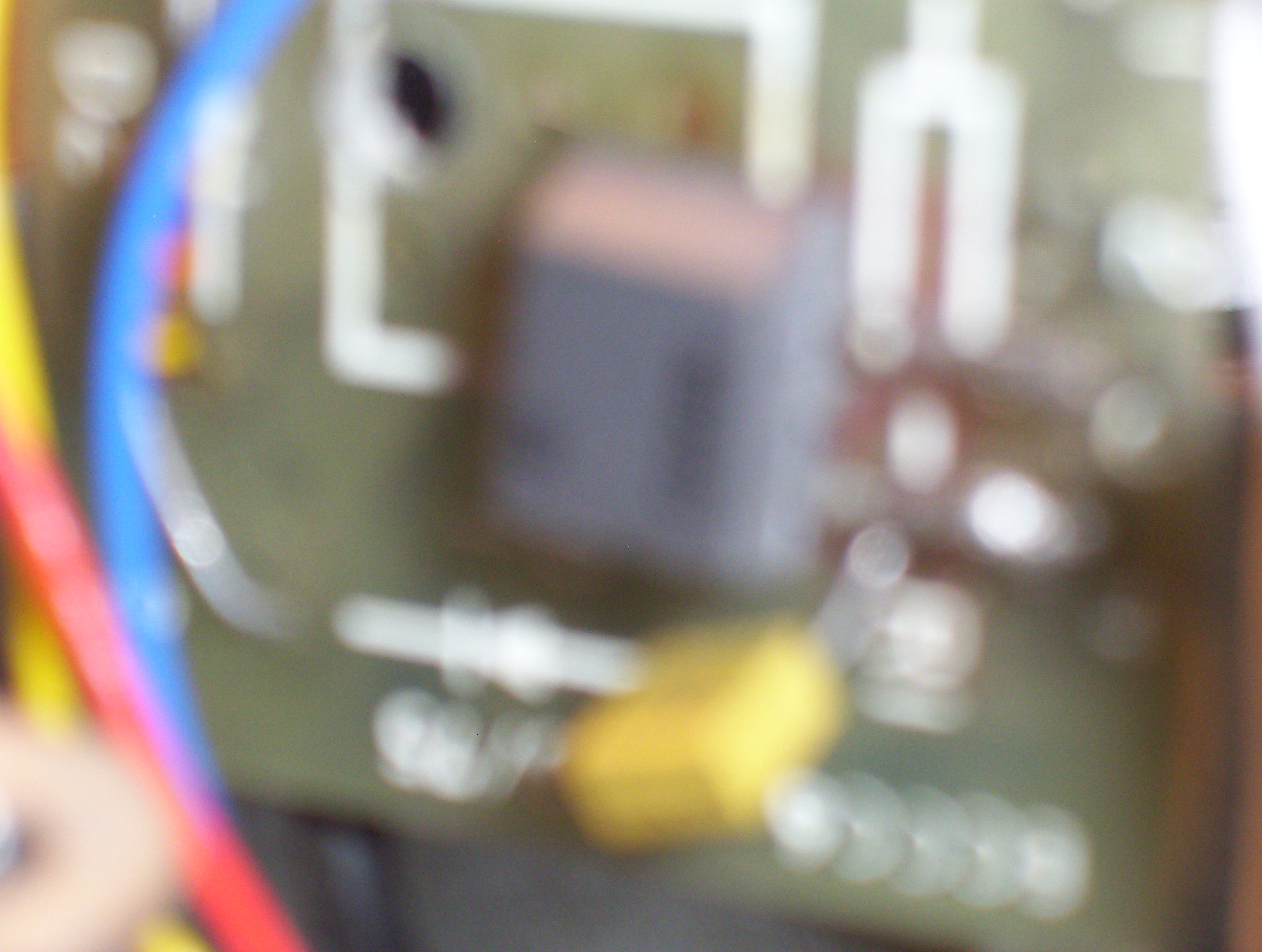

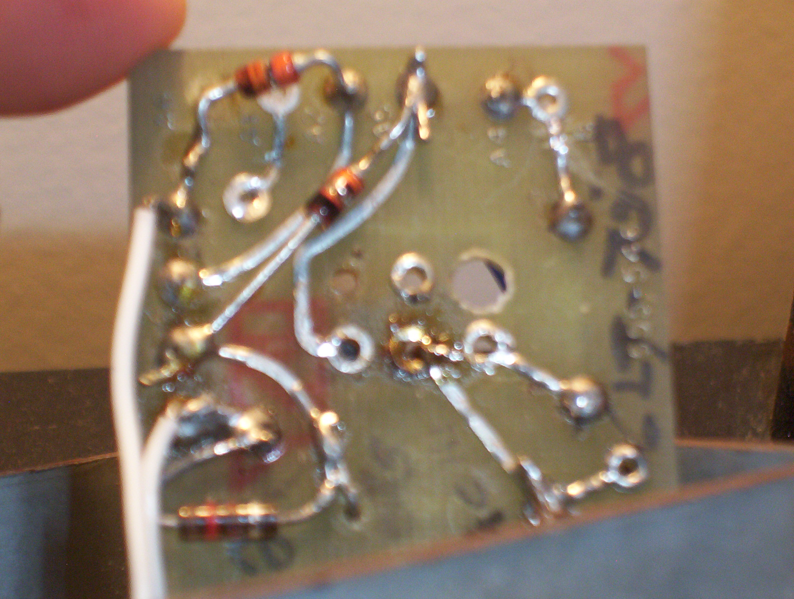

board pics
The black chip is the one in question. I heard a pop and one of the legs on that chip was broken. The outlet works it just will not regulate the speed of the motor. Can anyone identify this chip and where to get it? Close up it looks likes a piece of metal sandwhich in between 2 magnet like pieces, Also the markings are ge c10684 not what I posted earlier!

It could be a transistor since it has 3 legs. The pictures are pretty blurry, use your camera's macro function (Usually a flower symbol) for closeup shots.
I was also thinking transistor or SCR. I haven't been able to find anything on the net with that number though.
I also agree that the images are too blurry to use. The macro function should help and if the camera has a manual focus mode then that should help a lot.

Did the pop occur while operating or were you poking around and the pop was just a mechanical pop? If the latter, maybe you have enough broken lead remaining to solder to and repair it. Just a thought :)

The pop occurred when I tried to use a different motor that pulled more amps.
It was really meant for a small motor. Stupid me!
As far as the pics I knew they were a little blurry. Its a low end Kodak about 3 years old with easy share. I left it home so I will try again tonight to clear it up.
There is no manual focus as far as I can tell. One of those chips must be a timing chip. Like I said it still works there is just one speed now "high". The black chip has 3 prongs coming out. 1 on one side and 2 on the other.

If you can find out the model number of the camera I'll try to find a manual for it online to see if any decent pictures can be taken with it. Otherwise try backing away from the circuit a bit when you take the picture.
If all else fails you can just put the circuit board on a flatbed scanner to get a good image of it. Take care not to scratch the glass on the scanner if you do that, though.

I have a Kodak easy share, you should be able to get a better focus. Try 1 of two things.
Option 1.
On the top behind the shutter button should be 3 small buttons. One should have a picture of a little flower. Press that one as it allows close ups.
Option 2.
When taking the picture stand a little further back and use the zoom thumb switch near the back of the camera. Use the viewfinder instead of the LCD to look for focus.

The camera is a cx4230. What a piece of poo poo. I tried the only close up setting there is. Its either on or off. I tried close and back but still poo poo.
I did however notice the the "8" in the number is really a "b". Maybe that will
help! I'm going to buy a wire for my razor v9m. It takes great pics. Then maybe I can get the pics to my computor to upload them. I dont have internet access on my phone (too cheap) so I cant send them that way. I visually inspected all the parts and I cannot see any bulging or burn marks a on any piece. I hope I'm on the right track with the black one because it was the only one disconnected.

Yep, that helps a lot! It's an SCR--a silicon controlled rectifier.
If you fill the location information in your User CP (look near the top of the pages on this site, on the left-hand side, and you'll see a link "User CP") maybe someone can suggest an appropriate place for you to order one from. Maybe order two or three in case you blow one again someday.
Hm. . .a quick Google search makes it look like this particular item might be obsolete. However, apparently Mouser sells a replacement: the NTE5455: https://www.mouser.com/search/ProductDetail.aspx?qs=qQW3XH23dRPnPasY9dt/jQ==
